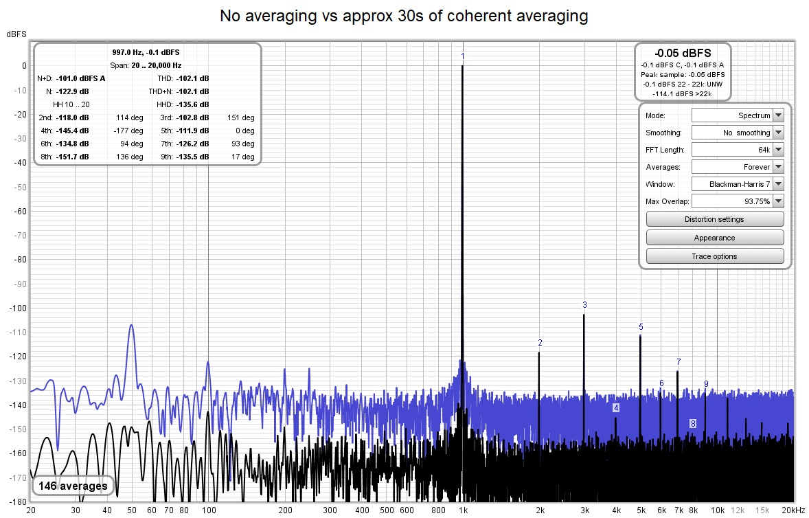

Well, averaging doesn't really lower the noise floor, it lowers the noise pk to pk value, squeezes the noise, sort of*. As the noise amplitude gets squeezed, the harmonics become visible and that may be why they have some value jitter during the averaging.
But yes the final values should agree.
Maybe John when reading this can shine some light?
The stability of the averaged value will depend on how stationary the noise is.

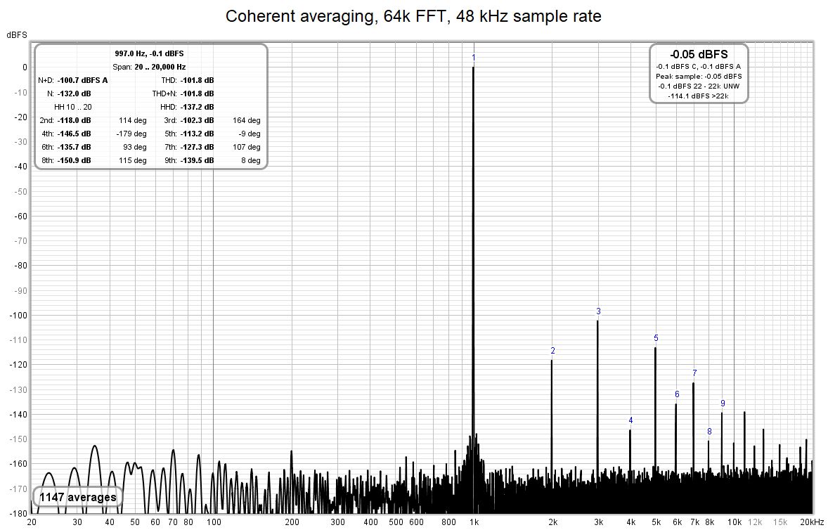

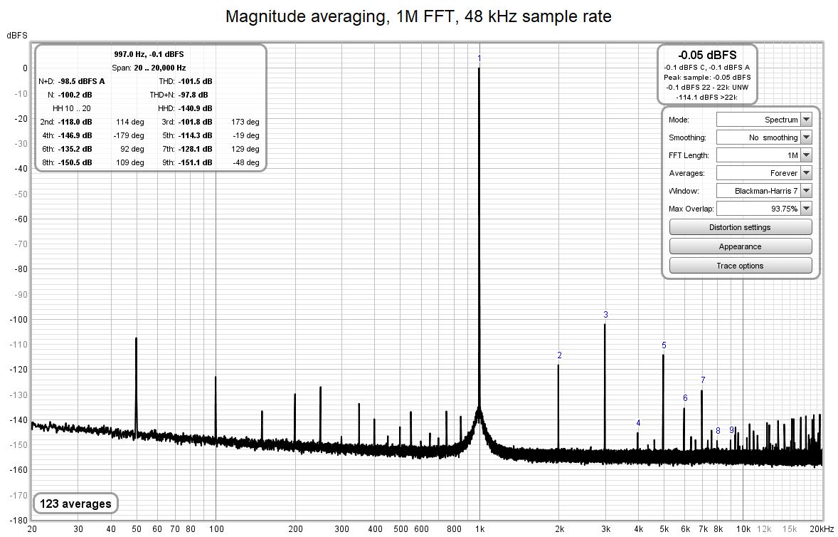

I had a play with coherent averaging for harmonic distortion measurement today, aligning phase based on the fundamental before doing a complex average, and it seems to work quite well. Non-harmonic content is strongly suppressed and here is no need for long FFTs, the example below compares a 64k FFT with coherent averaging and a 1M FFT with magnitude averaging. I'll include this in the next beta, but it should probably be treated as an experimental feature.
Yes, very impressive result. I do see quite a difference in the # of averages, but I guess that means that the total FFT/averaging time between the two situations is comparable?
Yes, though the coherent averaging delivers benefits very quickly, about a 20 dB drop in the noise floor in the first 30 seconds on my test setup. Very much diminishing returns after that, but the level does keep dropping.

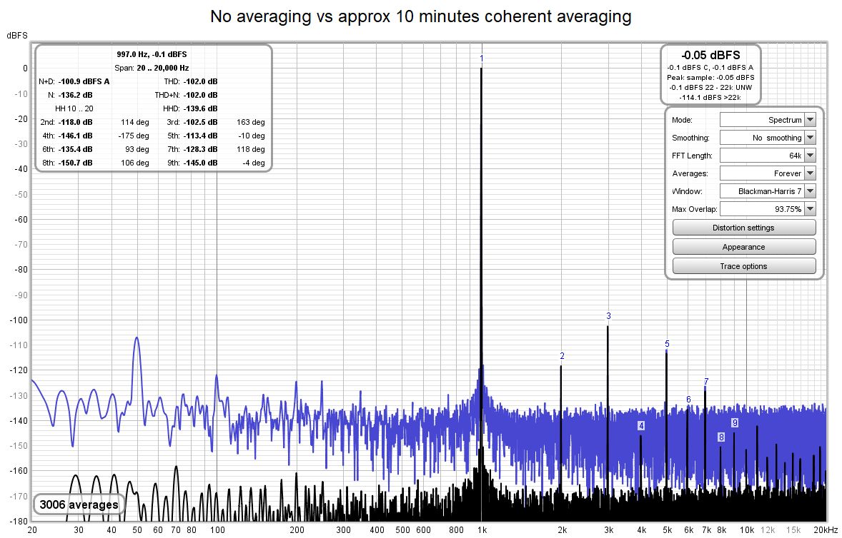

Edit: Here is how it looks after about 10 minutes of averaging:

The time shift property of the FFT is used with a time delay corresponding to the phase of the fundamental. Say the fundamental phase in an FFT result is phi degrees, then the time shift to bring phi to zero at the fundamental is -phi/(360*fundFreq). That time shift is applied to each FFT bin as a phase rotation of bin frequency * time shift on the bin FFT result. An FFT which has been processed in that way has the fundamental at zero phase and the harmonics at fixed phases relative to the fundamental. A complex (vector) average of a series of such FFTs will then coherently sum for the fundamental and its harmonics, but anything with a random phase relationship to the fundamental will decay. It is only useful to reveal harmonics that would otherwise be lost in noise, since other content is suppressed.

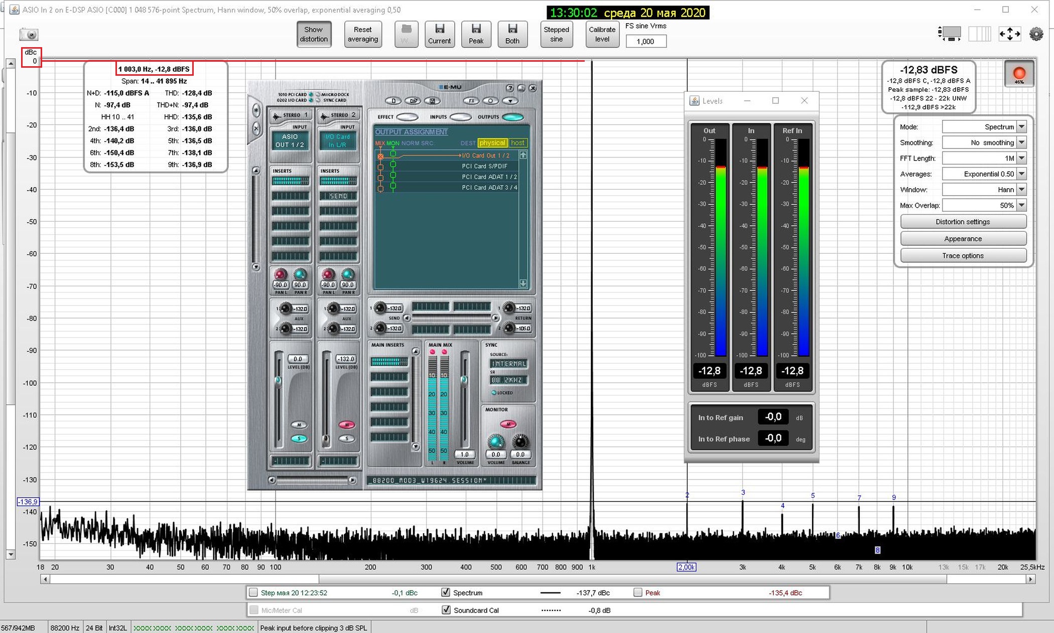

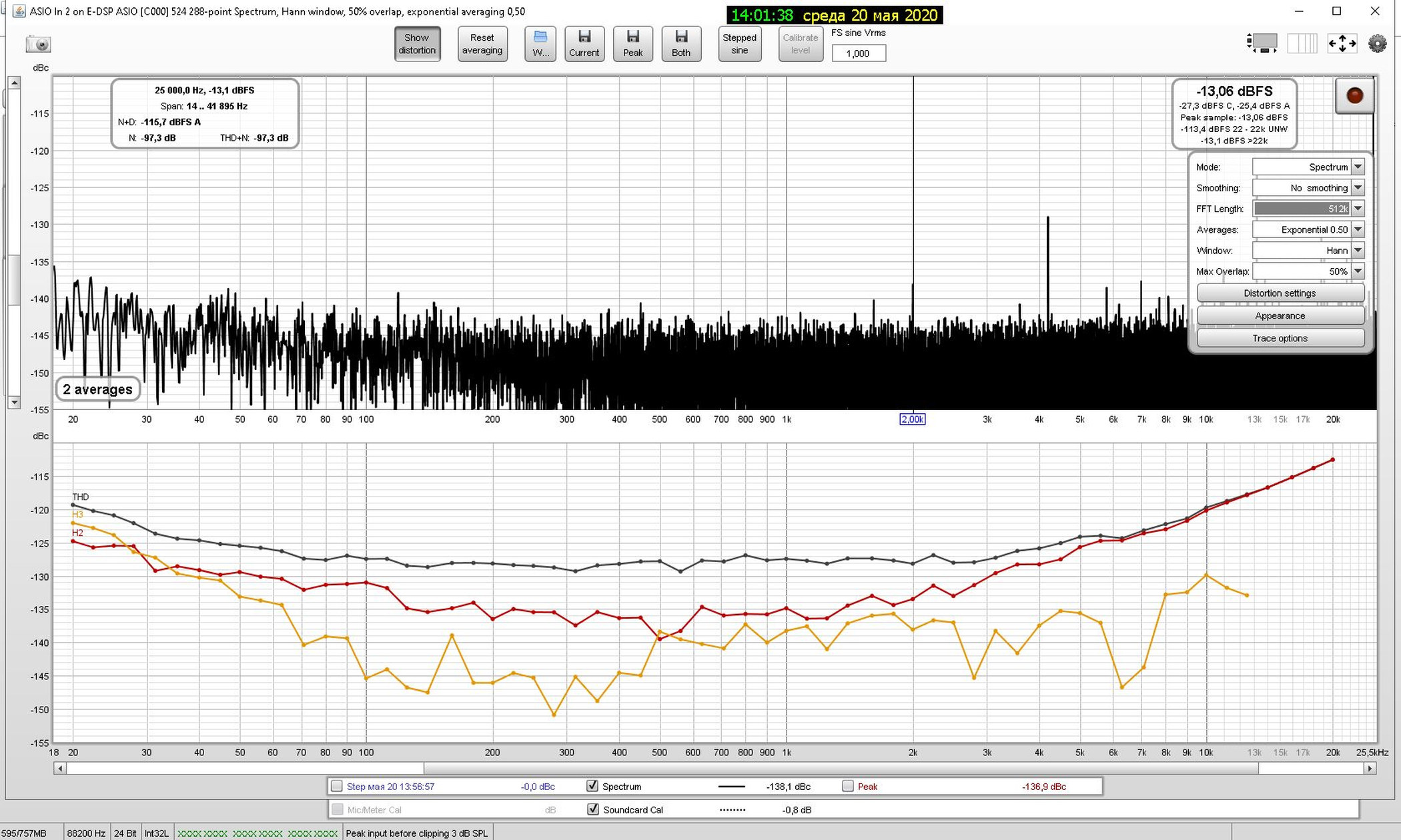

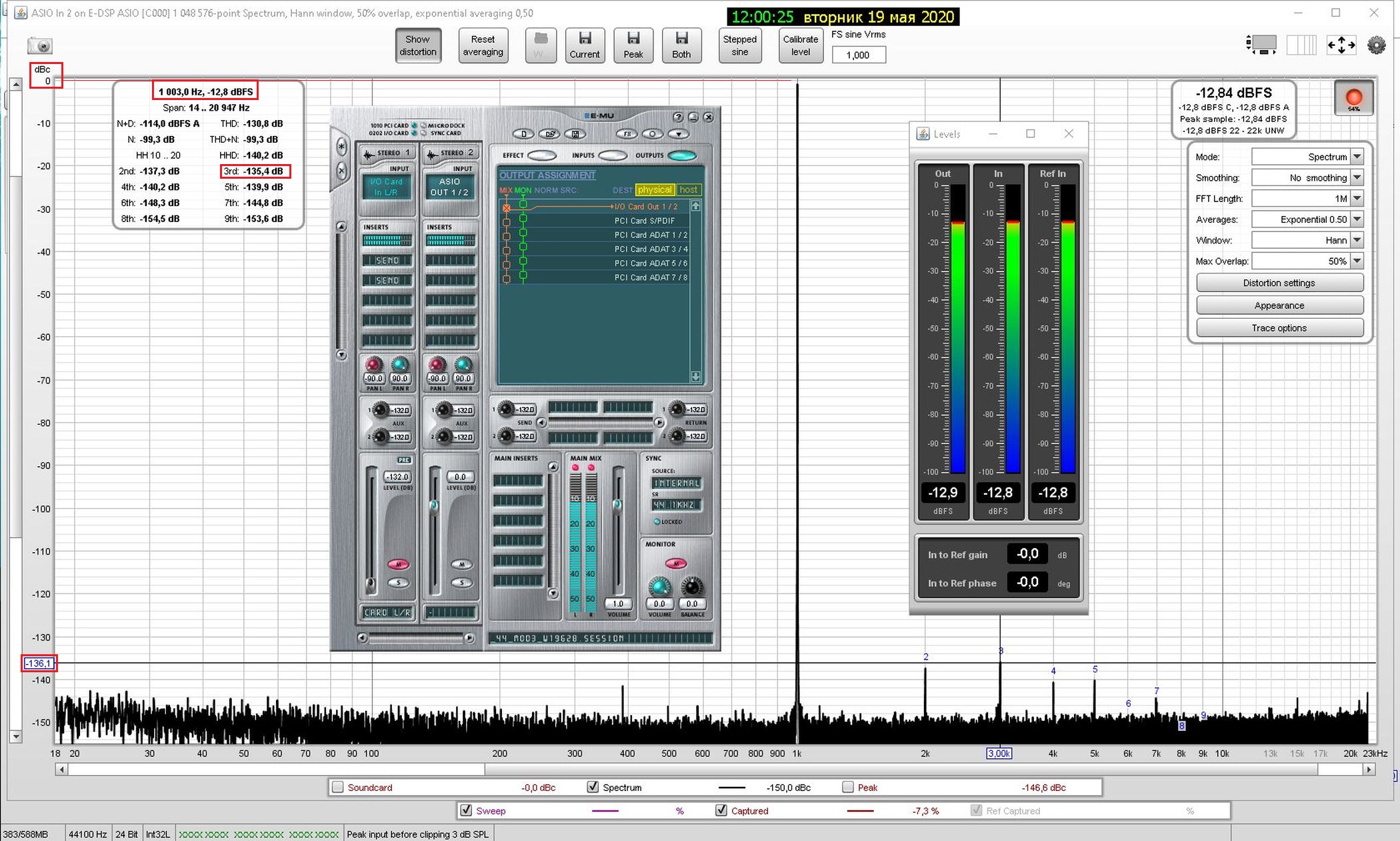

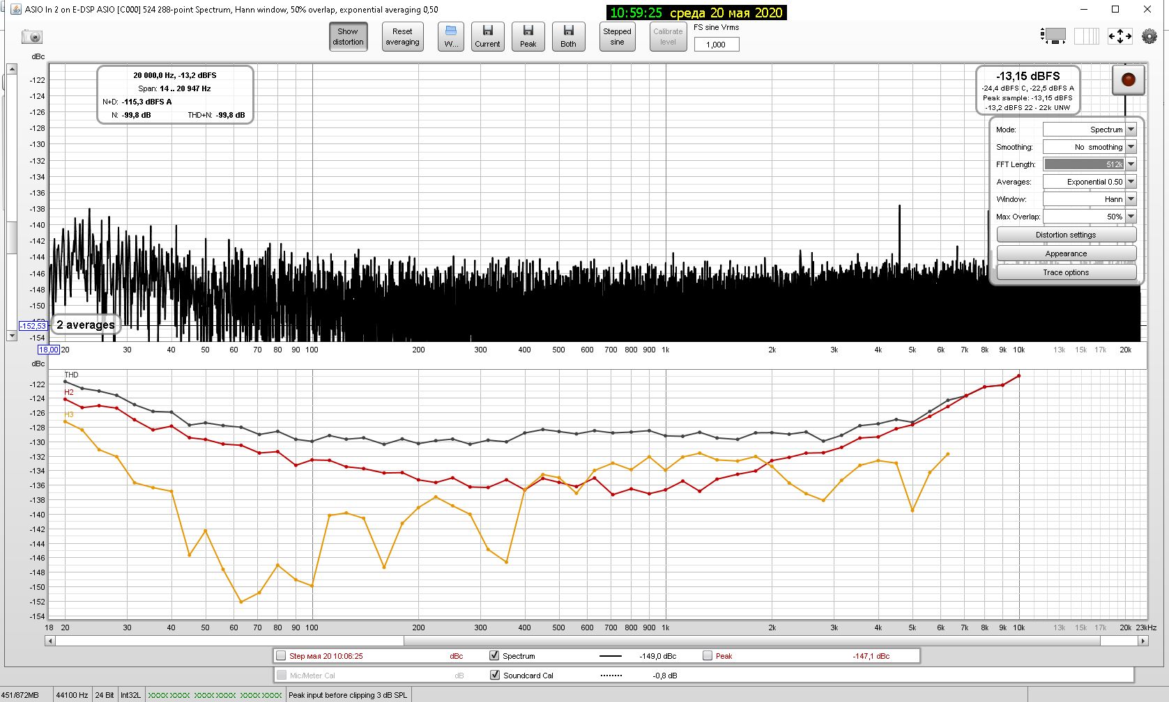

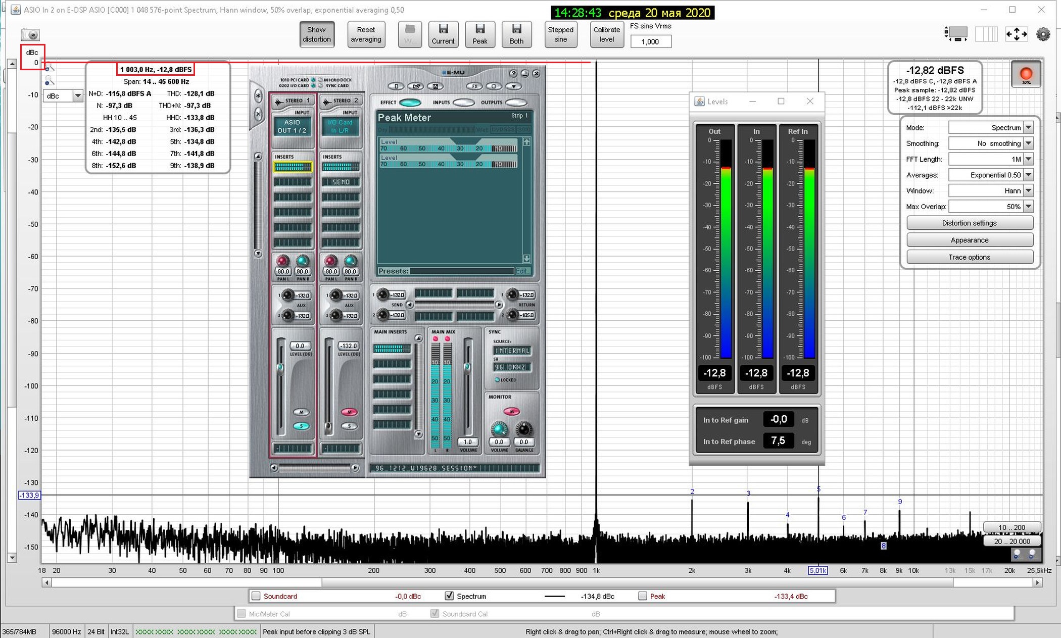

-13dBFs @88200 & 96000 @ CS4398 @ АК5394

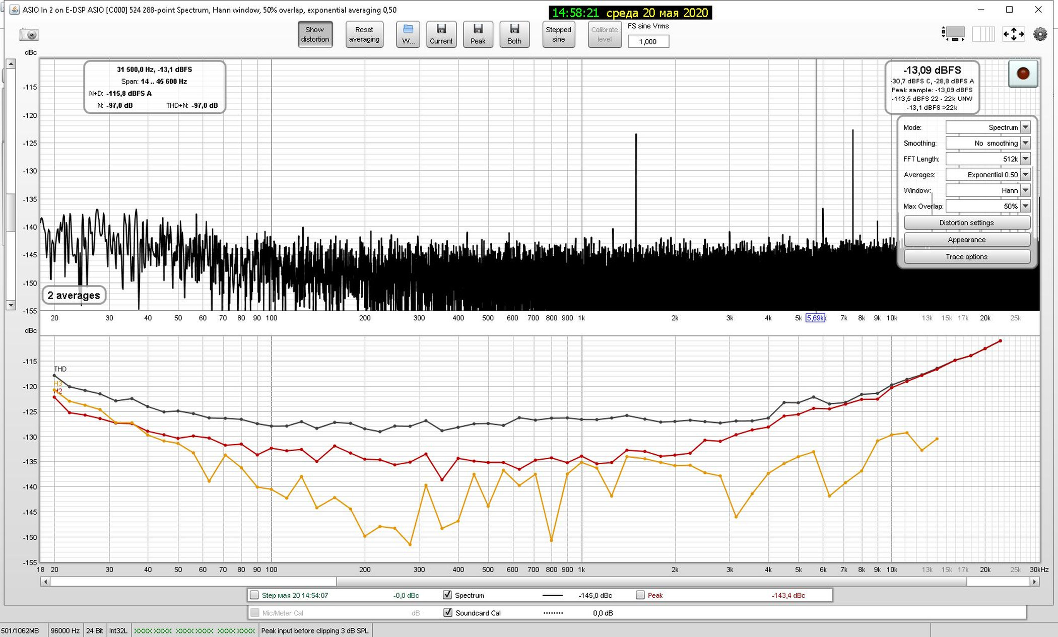

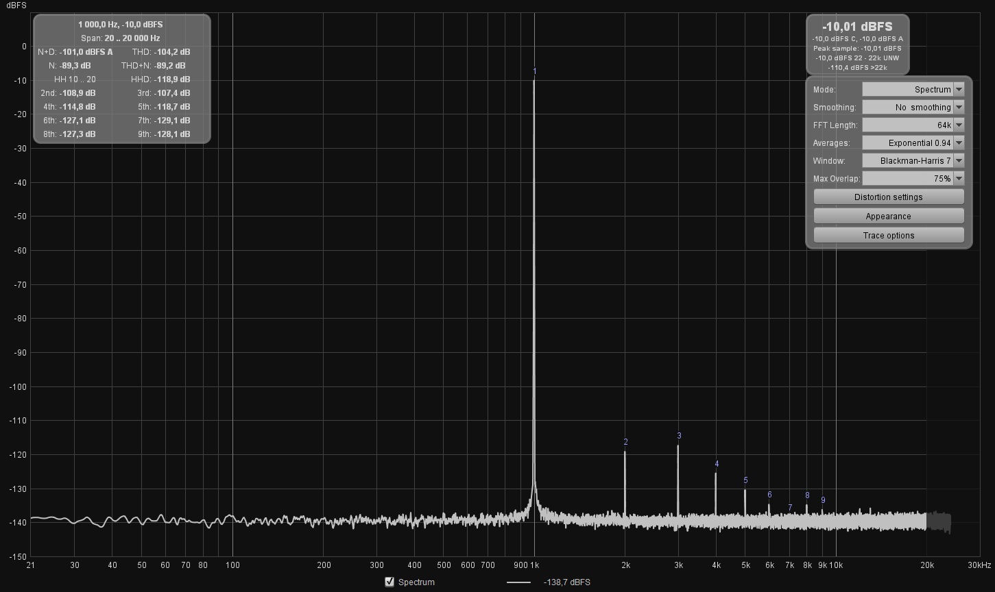

Hi all, first post, started reading (very) long time ago but couldn't stand anymore not beeing able to see pics !
I've been measuring THD+N on several devices using Scarlett 2i2 and for amps output, a volatge divisor on 4 Omhs dummy load. As I use this setup to improve my ClassD amp, I need to make sure my measurements make sense.
I use to always top DBSfs scale (closest possible to 0 DBfs) at 1Khz to get lowest noise and then read the THD+N result.
Below is my Scarlett 2i2 Gen 2 in loopback, balnced out to balanced in, output almost maxed out, input gain at approx 1/3 to reach 0 DBfs, REW generator at 0 DB, Asio4ALL. THD+N result seems consitent to me but I'd like to confirm if doing anything wrong.

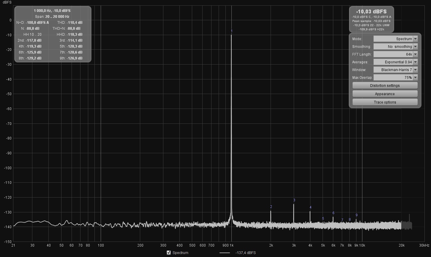

Schmilblick
Try reducing the signal level of the generator = DAC to -10dB
Ok so here they are, first is REW generator to -10db, second is REW gen to 0db and Scarlett output knob adjusted down (Scarlett input gain always set to minimum).
But then how can I assess noise performance if I don't measure at 0dbFS ? isn't that relevant for THD only ?
