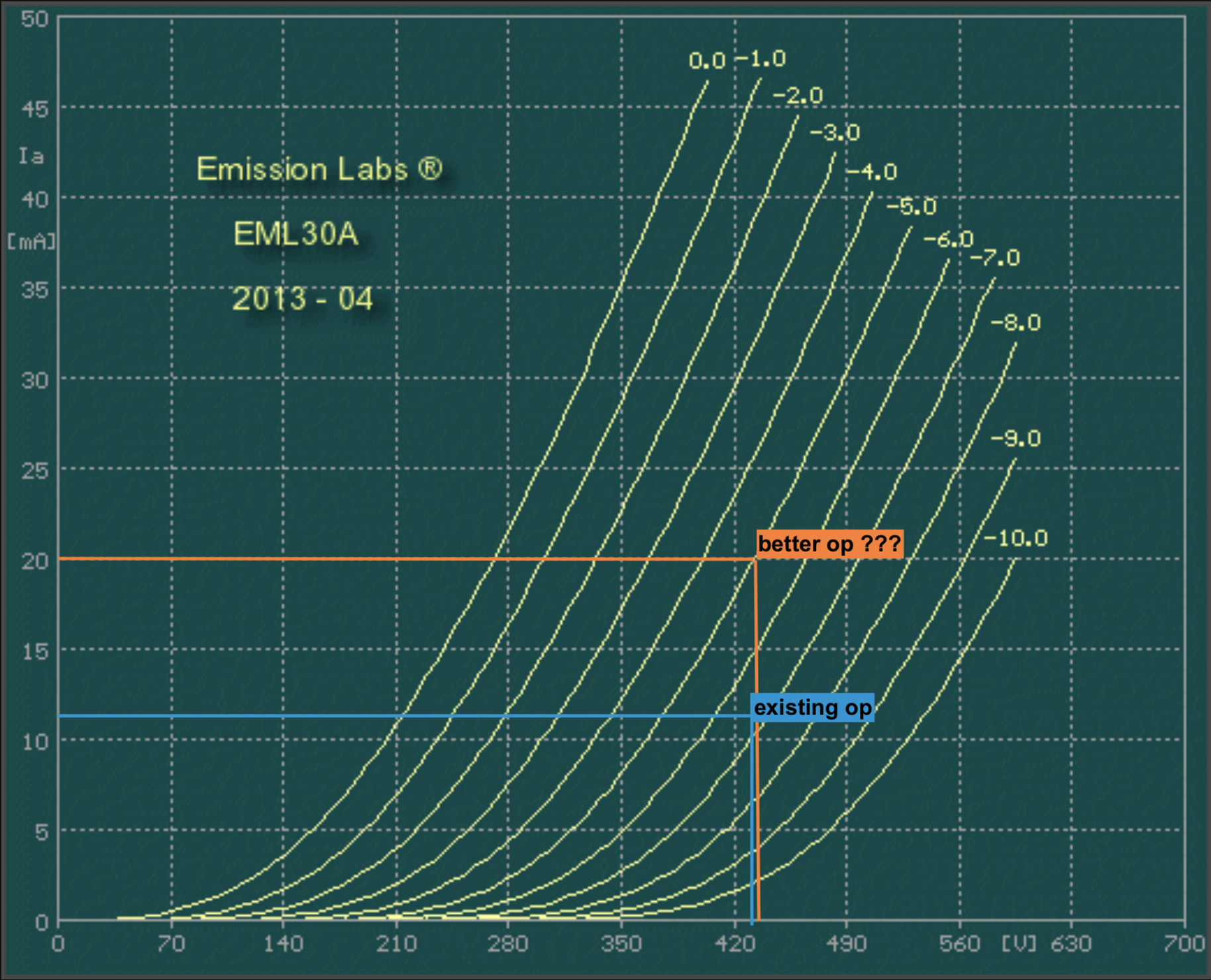

Rod, thank you for answering my original question, very helpful. Please allow me to summarize to ensure I understand. The reason is as follows: higher current = more linear (less distortion) parts of the tube curves. Given that I have an IT coupled solution, there is roughly 1.8mA that needs to be subtracted from my existing operating point of 13mA. I changed the current to 13mA recently, so 13-1.8=11.2mA which is reflected in BLUE on the graph attached.
If we want to improve the distortion by moving to a more linear part of the curves, then the current could be moved to the ORANGE operating point by reducing the bias. This would require a new IT to support the increased current.
Sound correct?

The 1.8mA diverted current doesn't apply to the IT couped driver (I was too preoccupied thinking about slew rates to remember that IT stage is not the same as RC or CCS stages).
But more anode current in the 30A driver will give lower anode-resistance ra (important!) and better linearity, yes.
But the IT must not be operated beyond the DC current allowed in the specification.

Operating points (from memory): 440Vdc, -5V bias, 15mA.
I am currently using a 200H IT (nano crystalline from Monolith Magnetics). Contemplating a new IT with higher current capabilities.
