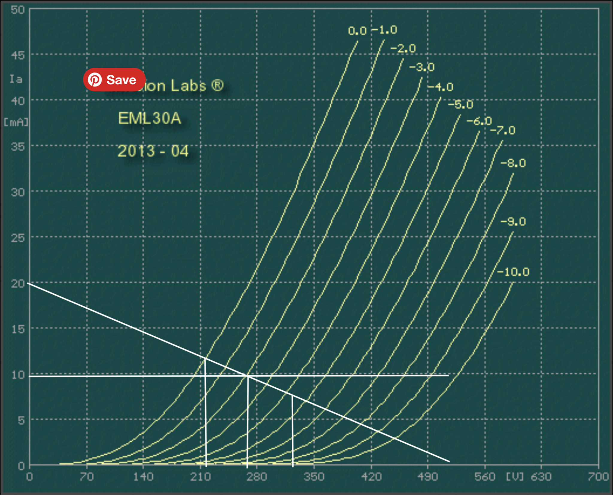

Hi Everyone, the EML 30A has arrived. I am trying to figure out the load lines, etc. See attached. Please keep me honest on my thinking:
1. Ua = 271V. (I can go with more voltage, but lets use 271V for now).
2. Bias = -2V. (this will support 4Vpp input from my elmaformer. Note: on a daily basis, I listen to about 2.5Vpp. When Zeppelin/Alice/Floyd are on display, 5.2Vpp from the Elmaformer)
3. So, 0V to 4V swing gives us about 120V output swing to drive the GM70. The GM70 is biased at 115V, so in theory operating point should drive the GM70 to full output.
4. Ia = 9mA which is a hair above the 8mA IT spec. I would bet that 9mA won't be a problem. I have emailed Yves at Monolith, but no response to date.
Thoughts?
Thoughts?
What is the line going from 20 ma on the Y-axis to 500 V on the x-axis ?
I suggest you up the anode to cathode voltage thereby moving the vg1 voltage more negative. This will give you more headroom.

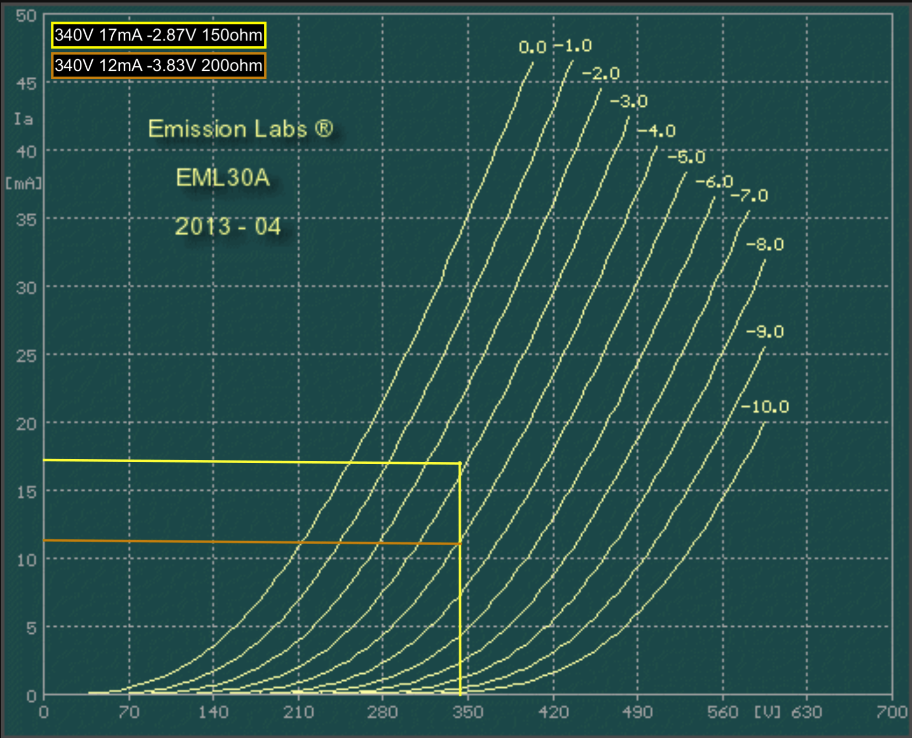

2. EML 30A is installed. Ua = 340V, -2.9V bias, 17mA (too much), Rk=150ohm cathode bias (un-bypassed). This is represented on the attached curve chart in Yellow. The Orange line is hypothetical if Rk=200. I might use Rk=200 to bring down the current to 12mA. Maybe even 250ohm to get near 8mA.
Now I will start listening and then report back. If anyone has other operating points to consider, please share. I can increase the 30A driver Ua up to about 370 if so desired. Not sure its necessary.

Pat, unbypassed Rk will rob the 30A of its high performance.
gm will drop to <3mA/V, for Rk of 150 Ohm, and rp will increase, meaning weaker drive to the IT.
Filament bias is an option, if you want to avoid the bypass capacitor.
High Ua is best. 400 - 430V, in order to get a big bias voltage: headroom is needed around the DAC output.
Also, Unbypassed Rk greater than about 60 Ohm (220 - 240V mains supply) or 120 Ohm (110 - 125V) will make for increased 50-60Hz noise in the output of any DHT. Depending on the PT structure and hence leakage capacitance.

Rod - I added a 100uF bypass cap to the driver Rk. Much better bass which balanced the sound. Less aggressive. Q: If Filament bias is used with a capacitor, does this compromise the bass performance? I don't fully understand why Filament bias precludes the need for a bypass capacitor.
Vega - I upped the voltage to 430@15ma, best I can do for now. I will listen and report back.

a much better working point for the eml30a
as for unbypassed cathode resistor: the ra of the tube increases:
ra'(unbypassed Rk) = ra + (mu + 1)*Rk
But when dc heating a directly heated triode the cathode resistors value is usually quite low, resulting in small changes in ra.

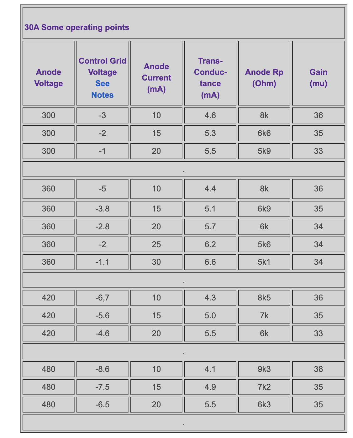

Please see attached snapshot from EMLs site showing a recommended operating point of 420V and 10mA. Someone please explain why 10mA is insufficient and why it would be worth the effort to double the current. Mu is higher with 10mA. Rp is 8.5K vs. 6K with 10mA (compared to 20mA), but not enough to justify a new IT.
