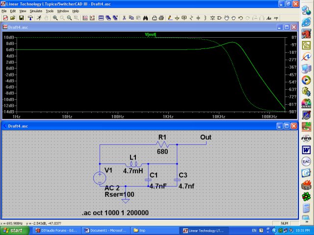

patwen said:hi,
I am planning to built a non-oversampling DAC based on TDA1541A.
Would someone kindly point me to some place where I can learn how to built a sinx/x filter to compensate the non-oversampling's roll off?
Pat
filter built ....
Thanks, with the help of the good people here, I have built the sin(x)/x filter using switchcad.
I will post the filter circuit here once I get back to my house. The filter is very simple (T's one is better as he dealt with the digital images) and used the parts I used for the digital antidote project.
Before adding the circuit, the sound of the NOS TDA1541A is nice, but dark and roll out at HF, after a while is become boring and lifeless.
Once the filter is added, the DAC sound much more alive, natural, and the shorting comings of "dark soundsing", "roll off" and "loss of detail" is gone.
Now it sound like the latest 24bit/96KHz DAC BUT with the body and warmth of the TDA1541A, just great.
IMHO, this is an essential additional for all the NOS DAC (no just the TDA1541A) out there, as the sin(x)/x roll offf is quite noticable if not dealt with.

I made a try and have built the Patwen's sinx/x filter in the next
environment: tda1541 Dac chip, Jocko's I/V converter( Rbroer version), Patwen's sinx/x filter, differential balanced tube buffer.
No measuring, only by ear:
Without the filter the DAC is flying, wide stage , great bass and highs, details.. etc.
With filter everything get a shadow, the state is similar when there was no DAC (this is my first DAC project).

What components did you use?
The Sin(x)/x filter was design with near "perfect" components. Especially the caps, you have to use the best caps available (I used silver mica), do not use any EL caps, it will change the whole freq response.
Due to the small DC component existed from the TDA1541A (if you connect the filter directly to it), you will also need an inductor that can withstand some DC.
So try that out and see.
From my experience, the filter is a must, without the filter, the highs are dark and roll off, also seems less "details". (only "seems", because the details was there but at a lower vol.)

Hi Patwen!
I am glad to hear the filter works well in your circuit.
I used quite "normal" components - Wima capacitors, metalfilm
resistor, etc. The filter was in between Jocko's active I/V converter(Rbroer version) and an Jfet input tube buffer.(http://www.diyaudio.com/forums/showthread.php?threadid=9226&highlight=I/V+converter)
I don't know the output impedance of this I/V converter, so I put
a potmeter to the place of 680ohm. As I mentioned the sound
was bad at any resistor value(pot). Later I examined the signal by scope and there was a continous oscillation superimposed on the signal.
So I use my dac without sinx/x filter, but would make further experiments.
George

Re: sinx/x filter
You cannot actually do that, you know. Well, or rather, you can do that but it makes zip sense that way and will not work.
You need to include the SINC filter into the load of the I/V converter, namely in series to the resistor in the Anode/Collector/Drain of the device that does the I/V conversion, scaled to suite the impednaces there of course.
Sayonara
Sayonara
Re: Re: sinx/x filter
In the referenced schematic in the referenced thread this resistor is 1k5 - R4....
Sayonara
