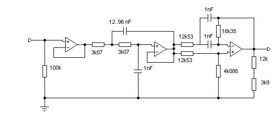

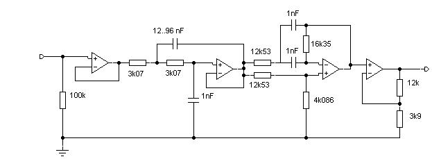

Found It
Here is the circuit.....I'll just go and re-read the article and post a summary.
Eric.
I Need A Scanner..
Ok Readers Digest version....
EW/WW Febrary 1995 pp134, 135. Michael Batty - improving Analogue Conversion - getting the best high frequency performance from a clocked DA convertor normally needs a complex post conversion filter designed using cad. This sin(x)/x correction filter provides an easy to implement yet effective means of a compensating for a clocked data convertor's natural roll off.
......Conversion is normally followed by a low pass reconstruction filter. This is typically a high order elliptic design giving a relatively flat response up to just below half the sampling frequency, Fs, followed by a sharp cut-off.
But this arrangement provides no correction for the sinc fall off in amplitude naturally produced by the saple and hold function.
As shown (graph) the roll off reaches -3.9 dB at Fs/2, falling to zero at Fs. Correction for this roll off can be designed into the reconstruction filter if CAD design tools are available, but the simple seperate correction filter described here yields excellent results and allows more flexible design.
The correction filter is a simple second-order low-pass section, with frequency and Q optimised to have a response almost exactly inverse to that of the sinc roll off function up to around 0.4 Fs. If required, a single additional second-order all-pass stage can be cascaded to improve delay equalisation of the correction filter.
Note that in most practical situations, the delay equalisation stage may be omitted, since it is unlikely that the accompanying recostruction filter will itself have linear phase.
Also, the correction filter alone is not useful as a reconstruction filter, due to it's rather poor roll off characteristics.
The low pass stage produces a surprisingly flat equalisation of the sinc function : to within +/- 0.01 dB from 0 to 0.4 Fs, with an error of -0.12 dB at 0.5 Fs.
The optional delay equalisation stage results in an overall phase linearity to within +/- 0.5 * from 0 to 0.4 Fs, or a group delay variation of less than +/- 0.7 % within this range.
Components of 1% tolerance or better should be used.
Circuit Description - Preceded by a unity gain buffer stage to provide low source impedence, the low-pass section uses a standard unity-gain Sallen and Key design. The optional delay EQ section includes a final gain stage to compensate for 12.2 dB loss in the all-pass stage.
Component values in the two filter stages may of course be modified for other values of Fs by scaling either resistor or capacitor values in the standard manner.
Block diagram = DA conversion and reconstruction filter TO Second order LP (F0=0.72 Fs, Q=1.80) TO Second order all-pass (F0=0.556 Fs, Q=0.571)
