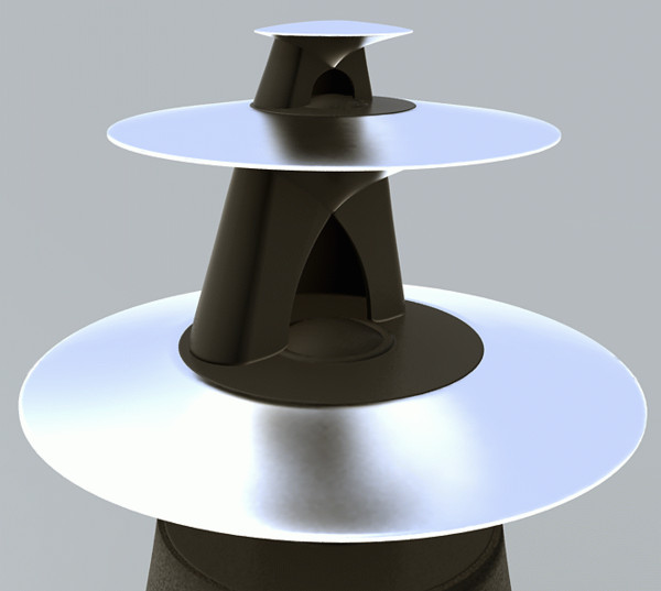

But if this is/could be the goal for a design, then as suggested by Juhazi, much fewer speaker elements are neded ..... by use of some kind of difusor or wave guide, you would only need 1 or 2 drivers ....
Maybe something like the B&O acoustic lenses (but adopted to wall placement) could be a way to go .....

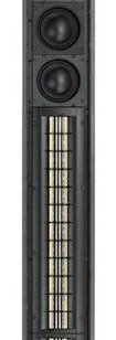

As for a short line source .... maybe something like the attached ... placed high ..... higher than head hight. This would prevent direct dadiated sound (mid-high), but would have a very wide horizontal dispersion
That B&G RD line midtweeter beams like *ell vertically. I would not use it as you said. Uniform dispersion horizontally and vertically is needed to satisfy the whole audience.

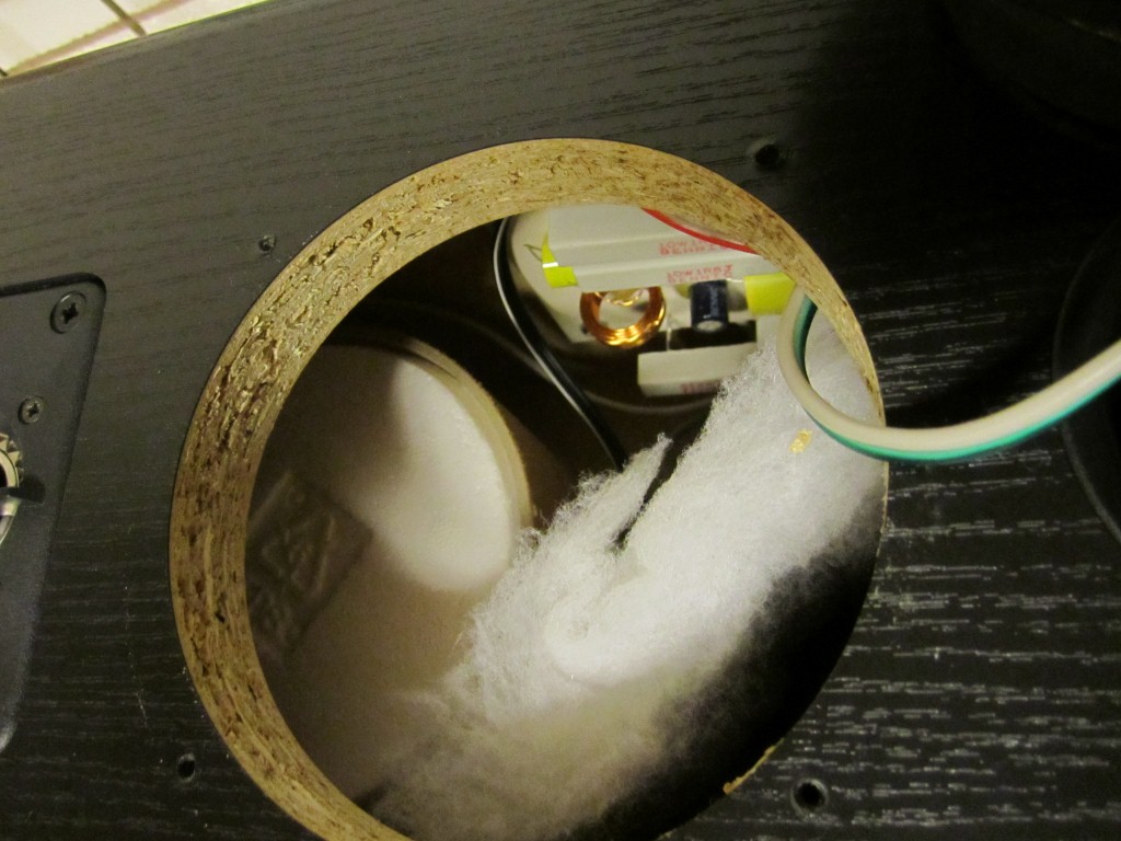

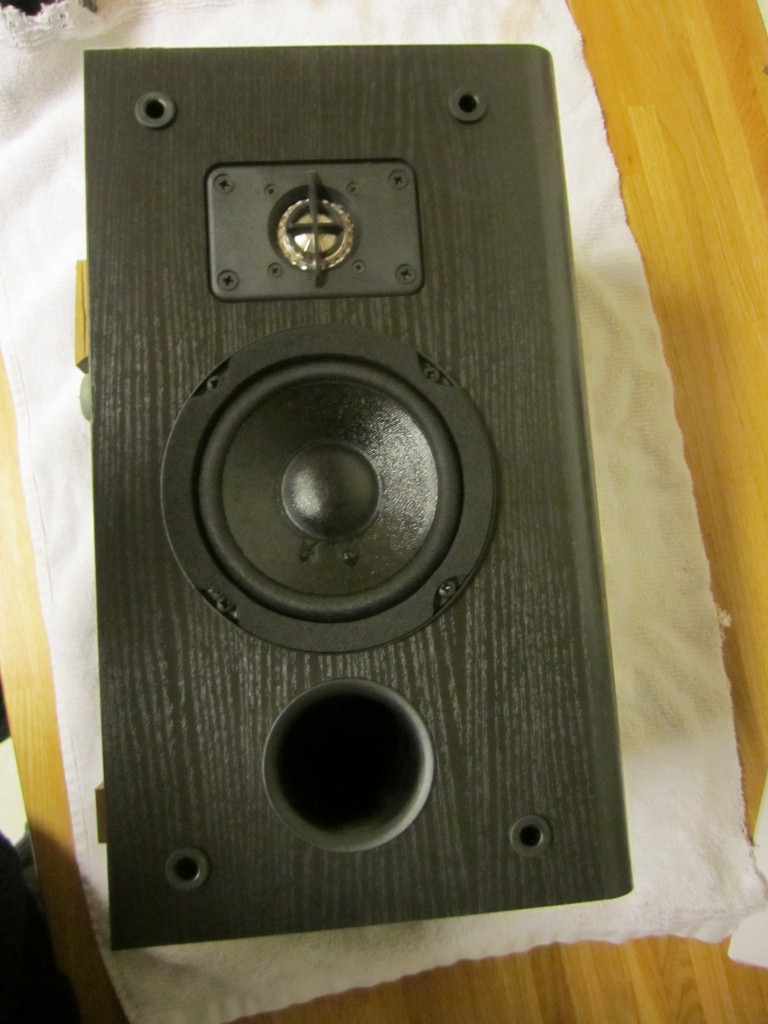

Did a little more investigation of my own setup.
What started this was that I on certain material found the sound from the sides to be very thin and cardbox like ....
Found that I in the amp setup had my surrounds set to large ..... this will for sure make the sound sound thin as there will be nothing below 110 Hz .... Changed that
Reading more and checking the phase I found that I had the wrong phase on the sides .... the front firing part need to be in phase with the front speakers ... makes sense ...
Changing these have improved the sound. I actually find that it is clear to hear panning sound but it is not so distinct that you hear that it comes from the speaker .....

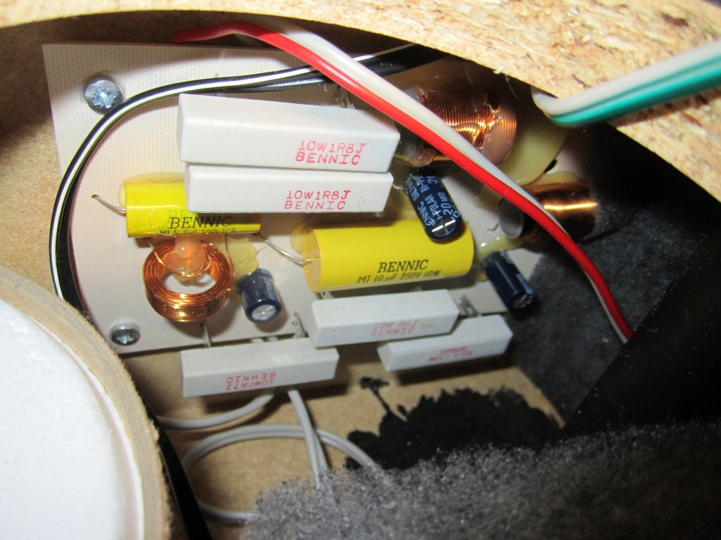

Took a look inside the speaker as well. One of the small bass speakers has it's own chamber, which makes sense .... so only one bass is playing the low frequency (otherwise it would be cancled out by the other).
Unfortunatly I couldn't easily remove the filter to take a closer look, but it's ok complex to look at ....
Yes a switch to change from dipole to wide would be nice ..... much easier to test out
