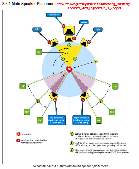

I have never understood why anyone wants to make "dipole" or bipole surround speakers! The Dolby Surround or THX or any concept use only monopole speakers. Mixing studios use monopoles. Multichannel preamplifiers have a setup scheme where speaker distances (delays) and levels are set.
Surround sound - Wikipedia, the free encyclopedia
Surround Sound Mixing
http://www2.grammy.com/PDFs/Recording_Academy/Producers_And_Engineers/5_1_Rec.pdf
This is from the Grammy paper
Only direct radiator speakers should be used for music surround sound mixing.
Because of their dependence upon reflective surfaces and the phase anomalies
inherent in their design, dipole speakers will produce inaccurate results when
placed in an acoustically tuned professional mixing environment. However, it
may be helpful to check a surround mix on a consumer system equipped with
dipole speakers, provided the system is physically located in a room that
simulates a typical home theater listening environment. (See section 2.3)

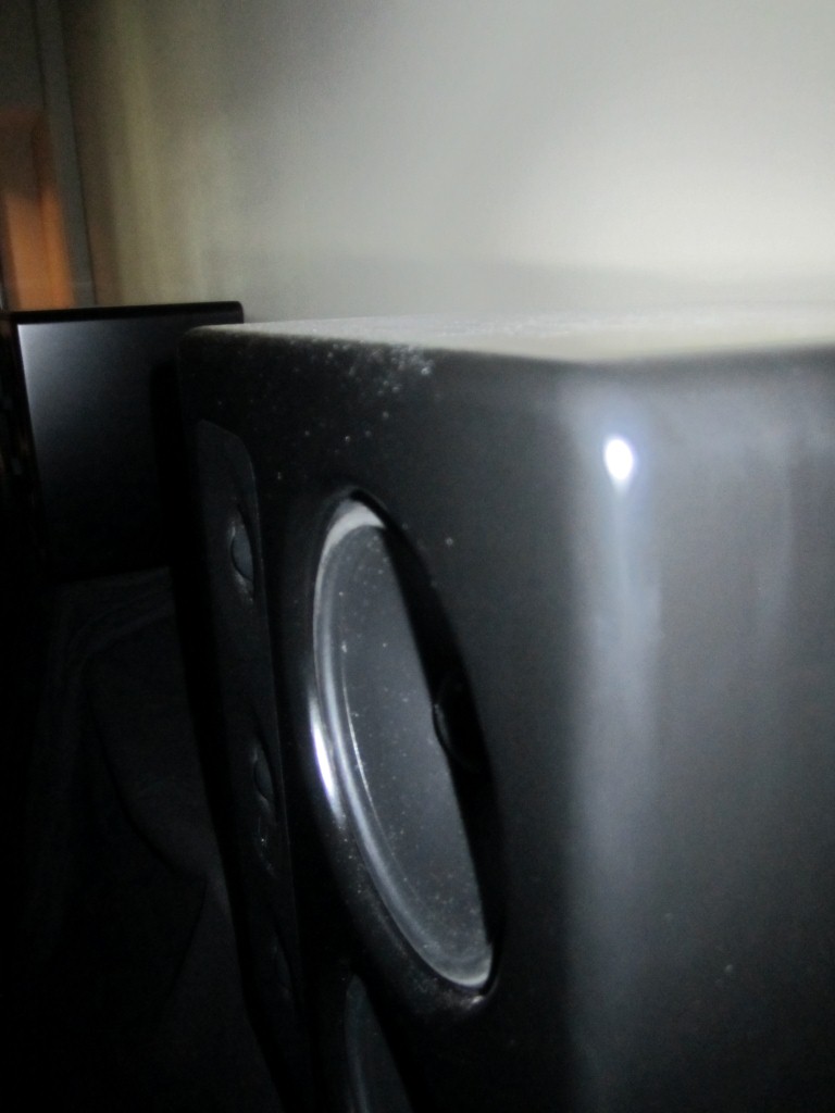

I recently designed a surround loudspeaker system configurable for wide - bipole - dipole configuration.
By using drivers with proper radiation pattern, proper placement and angling of the drivers, and proper crossover, it is possible to get reasonable performance in all those configurations.
However, it is not possible to avoid the inherent characteristics of the dipole design - the sound will be extremely dependent of listeners location, because on-axis there will always be a null, and there will be lobing. It sounds quite bad.
The bipole configuration is really only the normal wide with extended horisontal dispersion - 180 degrees full coverage. The sound is much better than the dipole config, and may be usable in some set-ups.
After measurements and testing I have never run them in dipole or bipole configuration. The normal wide sounds better with much better perceived location of sounds, and the speakers still disappears on reasonably good source material.
Oh - I just noticed that THX surrounds are supposed to be "dipole" unlike Dolby Surround and Dolby 5.1 or 7.1!
THX is a certification of equipment and installations to ensure that the sound will be as closely to what the film maker wanted to achieve. Dolby or DTS is the encoding system. ..... though both Dolby and DTS also have their own guide to setup .... yes confusing :)
Yes there is many ways to go. The Klipsh Palladium is not THX certified, but their KS-525-THX is.
Okv: do you have some pictures of your speakers? And would you share a bit more on the construction and how they measure?
Best regards Baldin
Best regards Baldin

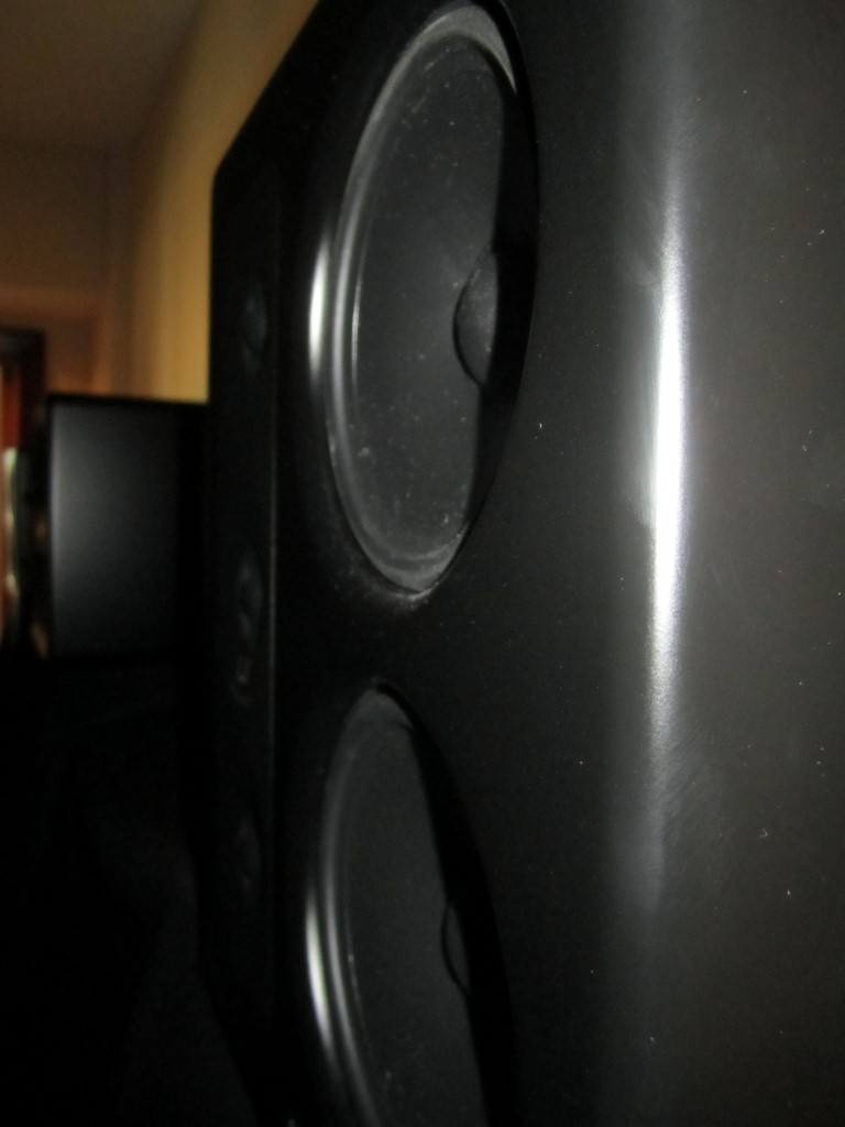

Of course, but it will have to wait until the design is published, and I don't work that fast..
One complete surround speaker consist of two units, with drivers angled outwards, and the angle depends on the configuration.
Generally, they measure very linear on-axis from one unit, and not that bad in wide cfg with both units.
Off-axis is also quite nice, but boundary reflections when mounted on to a wall will always affect the response of such designs.
Compromises need to be made when the same units are configurable to three quite different radiation patterns, and I have focused on getting the more normal wide cfg to be the best, in bipole and dipole there will be so large contributions from room reflections anyway, so that it is really most important to get the power response reasonably right.
And usually the listening position will be lower than the speaker, so that you listen off-axis vertically as well, which means the hf will roll of some.

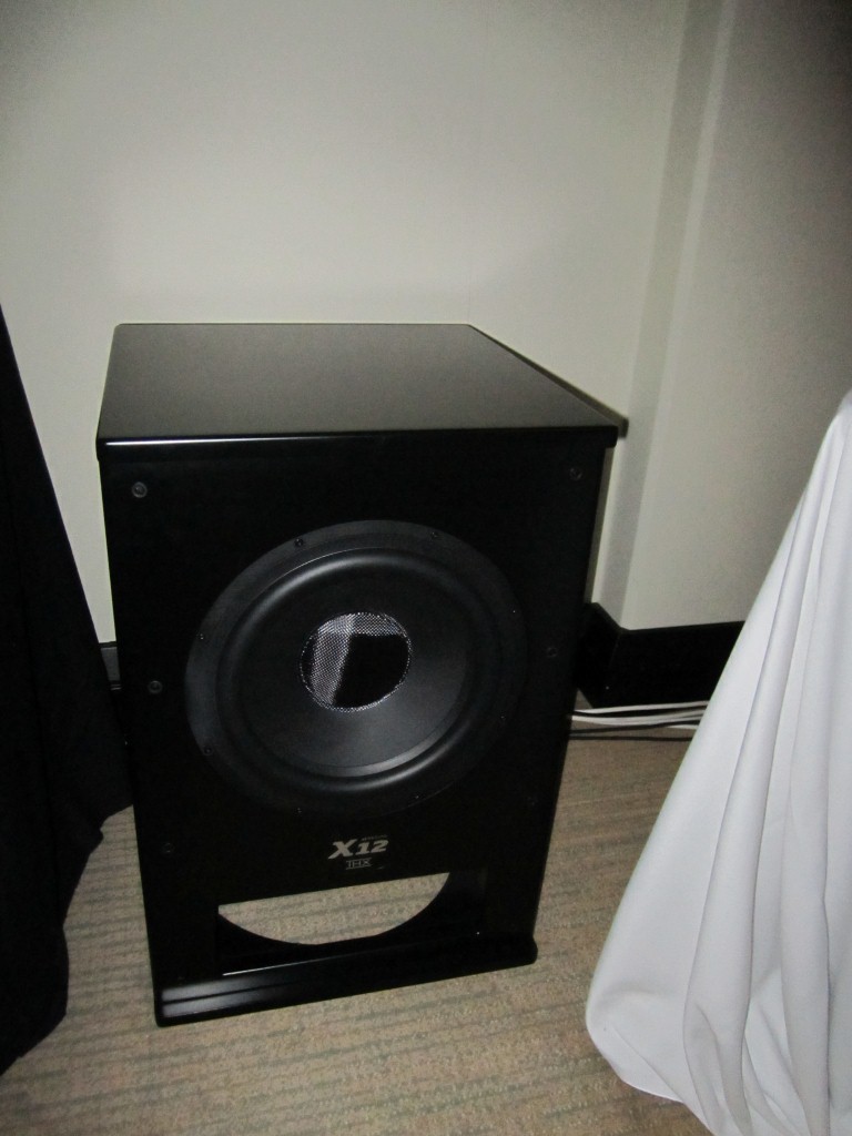

Anyway just came back from the yearly HiFi and Sourround exhibition in Copenhagen. The show is getting smaller and smaller each year, and fewer end fewer people attend …. Belonging to a dying race!
Best / most impressive sound was a set-up with MK sound and Datasat. Processer was the professional RS20i, used in many large cinemas, and the power amp was the 7 x 300 W RA7300. Source was Oppo. … so the front end of business was up to spec :D …..
The speakers was a new series, which I can’t find on their web site (MK sound). Couldn´t get a good picture as the front speakers was placed behind the screen, but they told they are now equipped with Scan Speak units, and MK is now on Danish hands and produced in DK!!!

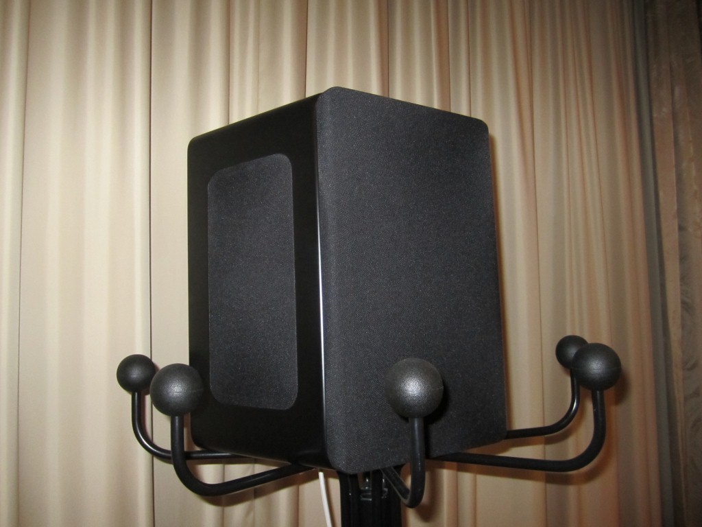

The surrounds was also new, but based on their Tripole principle.
As for bottom it was delivered by 3 x X12 (meaning in all six 12” speakers :cool:)
The sound was simply stunning …… dynamics where through the roof, the sound simply just clear! ……… If I just had that kind of money ;)
But back to the surrounds. The setup was 7.1 and all 4 surrounds was tripole. The sound was both diffuse, but with clear direction when panning the sound. But when playing the old THX trailer with the little guy repairing the back speakers, it was actually a little harder to follow him around than I have heard in the cinema! So I think, no matter what the concept is, monopole, dipole, tripole or something else … there will always be compromises. I didn’t have the possibility to hear any music on the system, so can’t say anything about that.
So how do they do this tripole thing??
Normal dipole on the sides, and I guess normal monopole on the front, but lowered some not to be too noticeable.
Wonder how a polarplot would look …. 3 distinct lopes, at least in the mid frequencies??
Anyone know more about these tripoles??

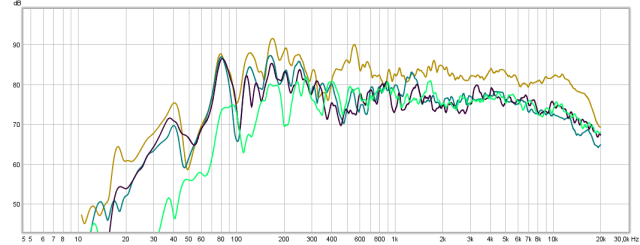

Found some fr plots, these are in-room at lp vertical 1m off ground, speakers mounted higher, 2.7m distance wide cfg (brown), 2m bipole (on-axis and 30 deg off horisontal, the other colours), 2m dipole (30 deg horisontal, green).

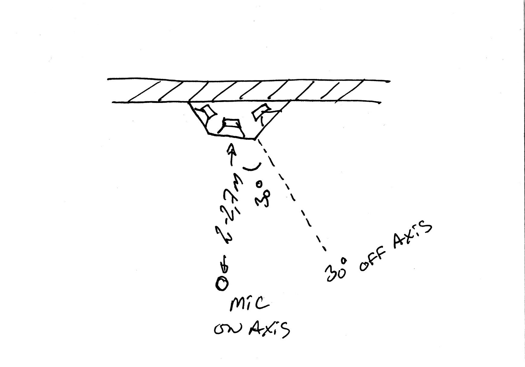

Hi Okv
Just to understand the measurements corretly. do you measure 90 degrees out from the wall ... that is pointing to the front of the speaker? ... this is what you call on axis, right?
And the 30 degree off axis is 90 - 30 = 60 degree off wall.
You measure with the speaker mounted on the wall, and mounted higher the the 1m high listening position.
The curves are more similar than I would have thought. You didn't measure dipole on axis (where you would expect a null for at least some frequencies).
When you run in wide configurations, are all 3 speakers connected in phase then?
Are all 3 "sides" the same (1 way / 2 way)?
BR Baldin

On-axis means 90deg off the wall, yes.
30 degrees off then means 30deg from on-axis, or 60deg from the wall surface.
The dipole measurement on-axis, in the null, will still show a frequency response not very different, due to room contribution - the measured response will be more like the power response.
Anechoic, or gated, measurement on-axis of the dipole shows the expected null - a very significant reduction.
These are full-range dipole, which means the bass level will be reduced in dipole mode, as the measurements show.
In all other modes (wide, bipole) all drivers are in phase, in dipole it acts like two similar speakers out of phase.
For a surround speaker, I am quite happy with the results for these speakers.
