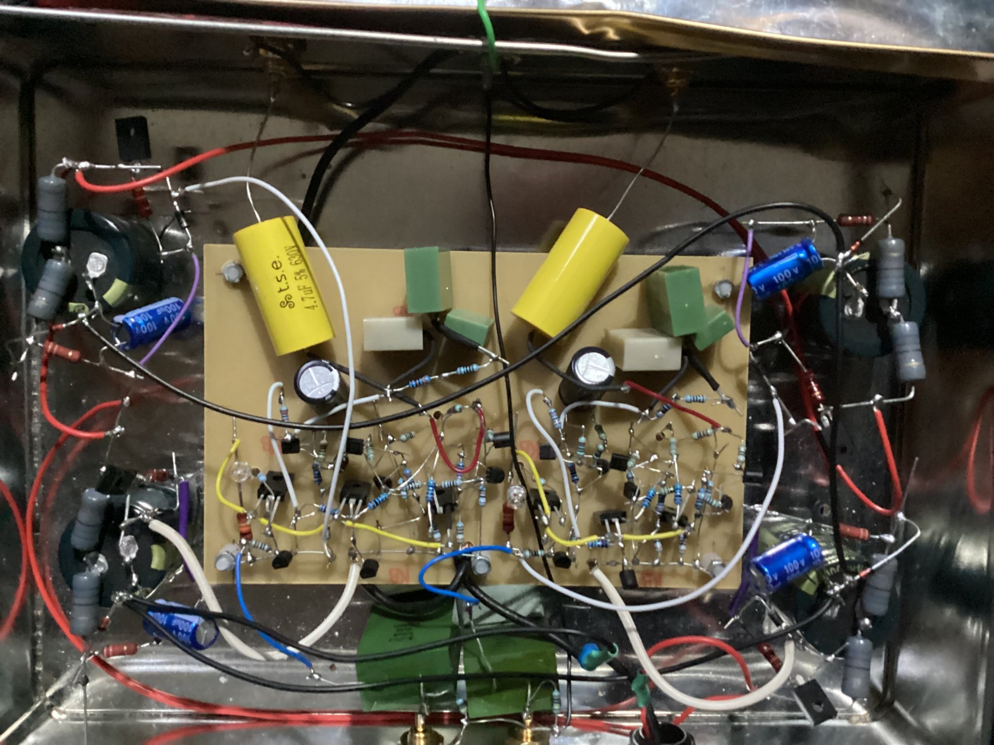

The ripple entering the preamp box is only a few mA. The cascaded filters on the right of the photo must reduce that to negligible levels. The pulses of noise, of frequency perhaps 0.5 Hz, contain a squeal, so definitely oscillation!

Chris, there are 4 double RC filters, seen on the right of the photo, supplying different stages and channels. The first, highest gain stage, has one of its own, with the second stage and the emitter followers sharing a filter. The voltage entering the box is about 70V stepped down to 48-ish V by the filters.
basreflex, the big cap 680uF is in the bias circuit of the second Sziklai stage so I am not quite sure what you mean, although there will certainly be some stray inductance around with this what I laughingly call my point to point wiring. I don’t know how to make PCBs but I have always gotten away with it previously.

I'm a little worried about the point to point build. Do you think you can get the Sziklai pairs' loops a bit tighter? A low pass on the input might not be a bad idea.

This is my own, same topology, except no line stage, different transistors and much lower current in the high gain stage. No problems whatsoever. I absolutely take the point about the wiring. The problem is, I started with tubes and never learned how to make PCBs. I do have a physics degree but I’m not good with tech stuff.Things like Gerber files or using computer simulations are quite beyond me! Never the less, I have not had this problem until now.

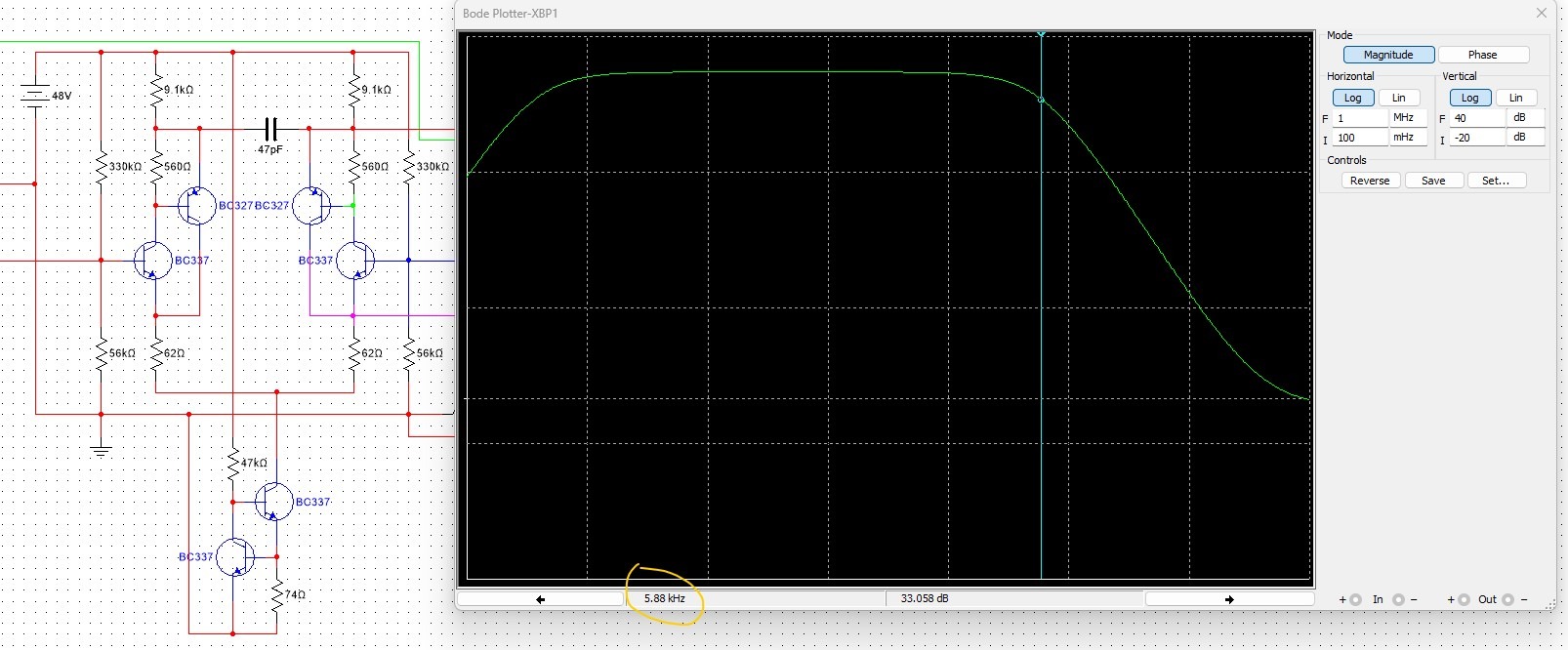

Using input bias resistors and miller capacitance to set a -3dB bandwidth at approx. 5.8 kHz. Have to test this IRL too.

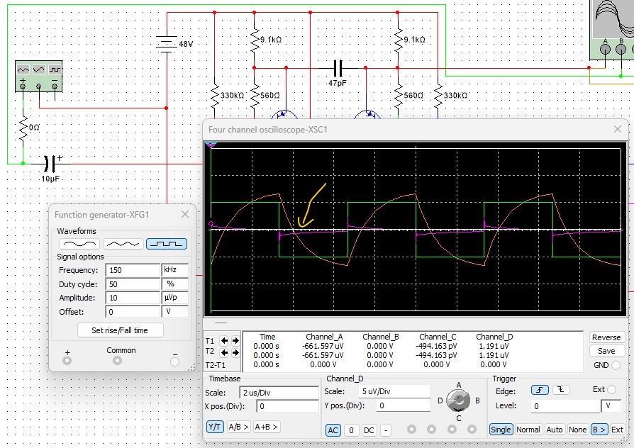

How ever the problem to solve was oscillation, and I played around with a simulation and I might have found the reason for oscillation.
When using this circuit in full bandwidth (right hand bias circuit grounded) I see one pole at 920 kHz and one at approx. 30 MHz and the gain of 37 dB over all will make the 30 Mhz pole have some gain too, and I think that is the possible reason for oscillation.

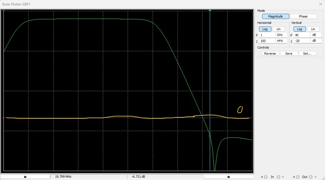

I put a 47pF capacitor between both 9,1 kOhm output resistors to set the first pole at approx. 150 kHz which will place the second pole at 30 Mhz without gain.
That MIGHT be a solution for not getting the Sziklai pair into oscillation.
First picture shows 1st and 2nd poles.
By reducing bandwidth for the first pole to 150 kHz the second pole are placed below 0 dB gain. Picture 2.

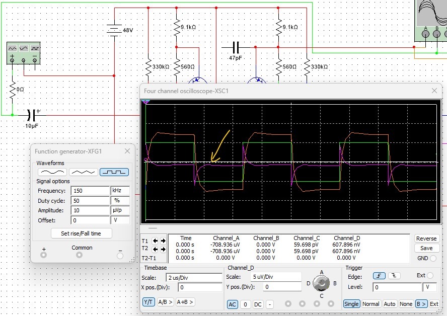

Picture 3 shows gain starting get out of control.
Orange curve output
Green curve input
Purple (Sziklai feedback too slow creating oscillation???)
Picture 4 is result of bandwidth limit of 150 kHz of gain stage.
Purple (Sziklai feedback loop faster than output bandwidth???)
I assume 10dB lower gain would make the circuit stable too, but I believe this is another way to do it.
This is a sort of best guess and I think it's worth to try and see if it fixes the problem of oscillation from the Sziklai pair.
Picture 5 is the frequency range for this circuit which I find very interesting.
I have never thought of using miller capacitanses of a transitor and a high bias circuit for creating a low pass pole like this. Very unique.
I have similar low pass filter at approx. 5-6 kHz in my first stage of phono stages, but do it more traditionally.
But the way it's done here is intriguing.
