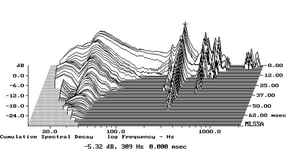

I am working on a bunch of modifications to my KEF Q350s, including fully active crossover via DSP. One of the main issues with these speakers is two chassis resonances at 700hz and 1.2khz that I don't think I can fix with DSP as shown by this waterfall:
I have very little experience in dealing with such resonances physically - is there any "easy" way to reduce them, perhaps via polyfill or another damping material?

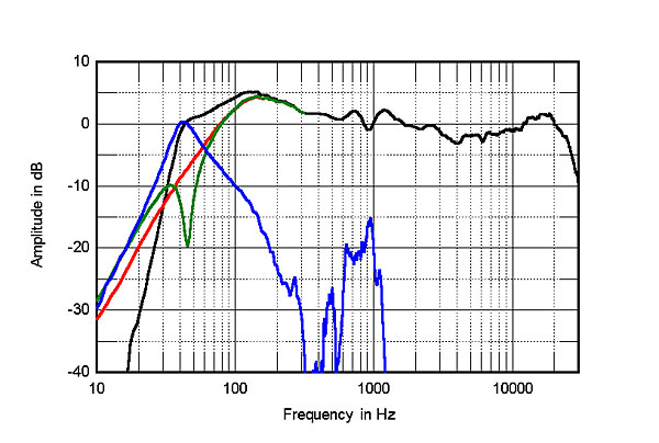

Attached image of a measurement from mentioned stereophile review shows in blue a ~ 1 khz resonance from the basreflex port that even shows up in the system frequency response.
If thats the cause of the largest resonance your measurement shows, cabinet damping wont help.

The Z axis of the plot shows ringing after the signal has stopped.
Its very apparent that a lot of ringing happens 300 Hz and down.
Highly likely to be enclosure panel resonance from bass frequencies.

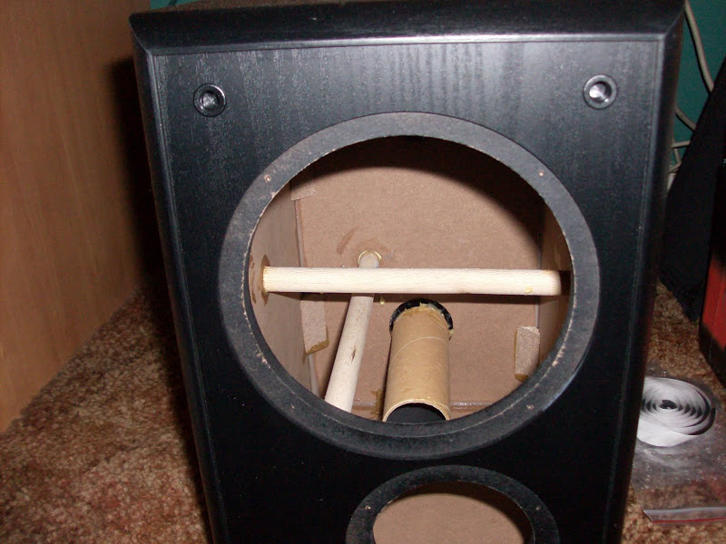

Bracing will reduce panel resonance
Just add a few side to side and
Front to back Dowel braces.
You can use round or square dowels.
I fine square easier.
Because you can also glue the braces together
where they cross.
I have attached a picture for example of simple round dowels.
It can be improved as mentioned.

from the waterfall its obvious that a lot of ringing is below 300Hz
more likely panel resonance.
Bracing will reduce vibration at low frequency.
The resonate frequency will be raised.

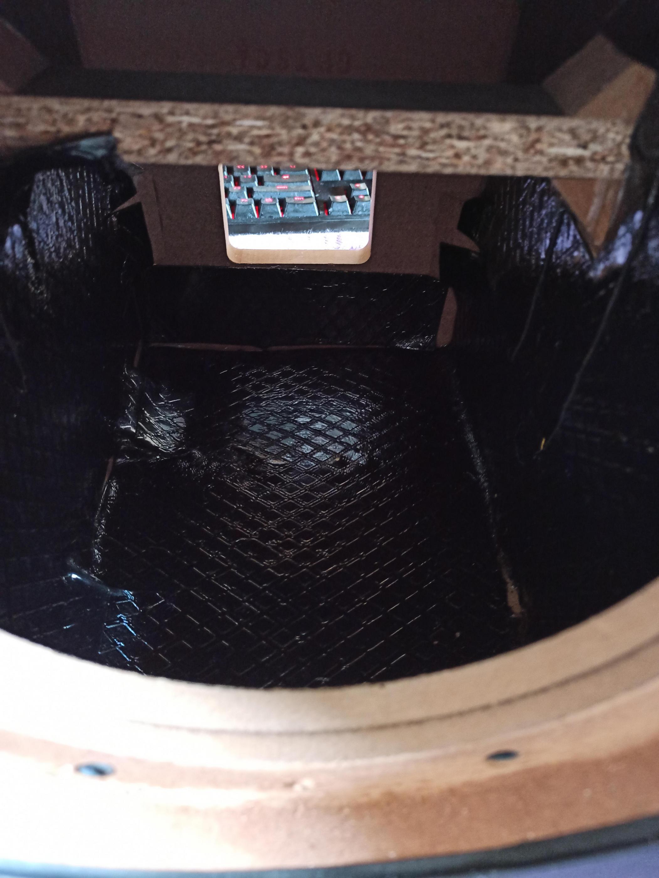

I have lined the insides of my Q350's with 2mm bitumen which really helped a lot.
I have no measurement equipment or anything. This is purely from what i hear and feel when i put my fingertips on the cabinet. I actually over dampened them at first. On top of the bitumen i put a 1 inch thick dense damping foam. This resulted in the sound becoming...dead, so i removed it. I later replaced the crossover with high quality parts. A Daytonaudio inductor and a Mundorf Supreme Aluminum oil Cap. The sound improvement is significant.

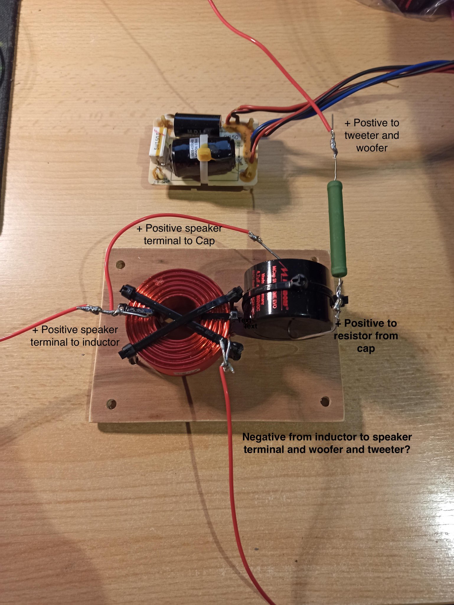

Hi guys, looking to upgrade my 350 crossover. I have added dampening and poly. So my question is in regards to the crossover posted by Spuddywuddy in the picture below. As the driver has 4 connections I didn't follow the new cross over connections. I am new to this so please no trolling. I have put in the connections as I see them. Can someone tell me what I am missing. Thanks a bunch in advance.

It looks to me like the original crossover had three parts in it, a resistor, a capacitor and a coil. I could be wrong, but It seems the guy bought three parts of identical values to the original crossover and just wired them exactly the same. If it were me I would have just swapped the parts directly on the existing circuit board one at a time and the job would be done. No rewiring required. Pull the resistor, put the new one in its place. Same for the coil and cap. I don't actually believe there will be any audible or measurable difference from these boutique parts if they are of the same value as the originals as the original parts were of high quality. Of course it's fun to do a project anyway. Hope that helps.Hi guys, looking to upgrade my 350 crossover. I have added dampening and poly. So my question is in regards to the crossover posted by Spuddywuddy in the picture below. As the driver has 4 connections I didn't follow the new cross over connections. I am new to this so please no trolling. I have put in the connections as I see them. Can someone tell me what I am missing. Thanks a bunch in advance.
