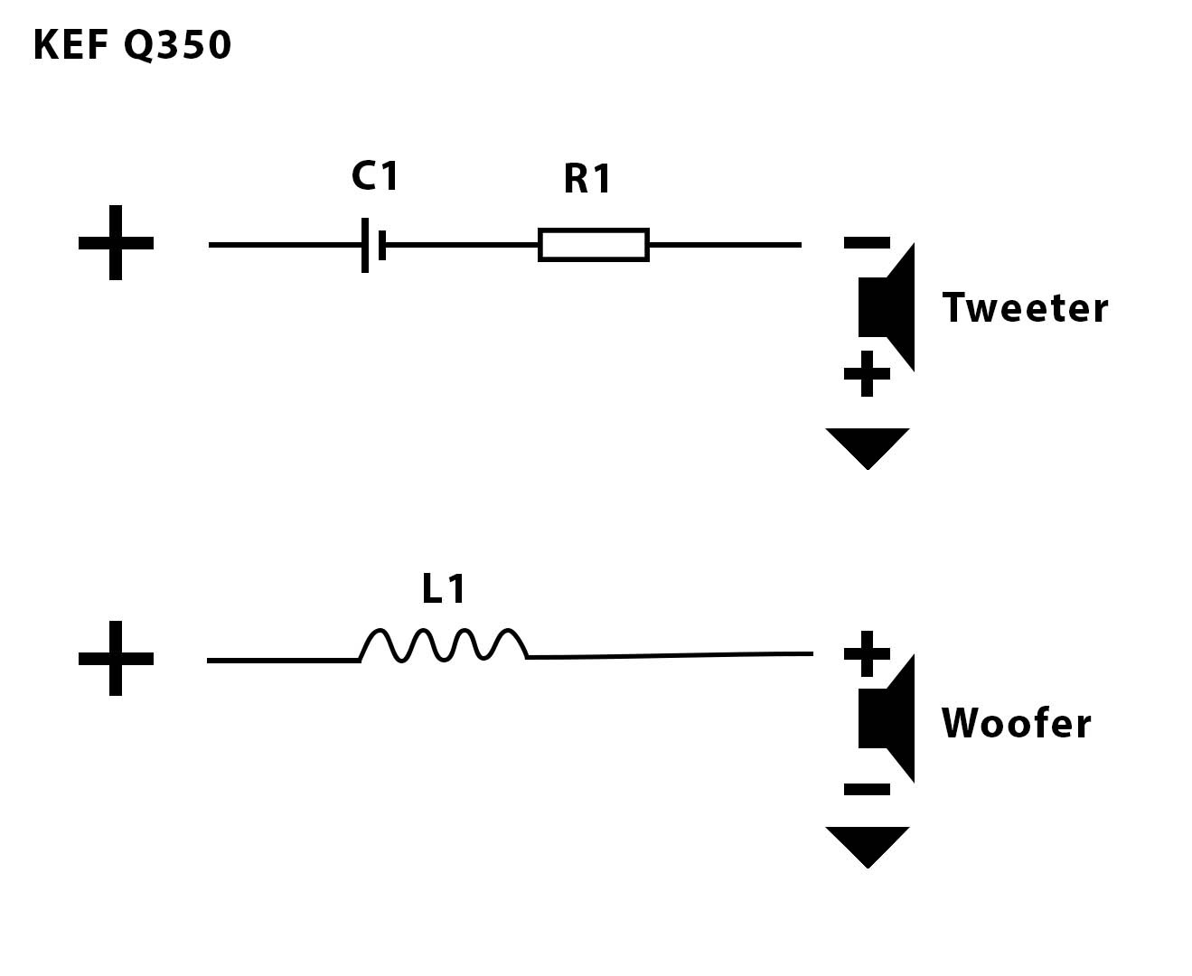

It looks to me like the original crossover had three parts in it, a resistor, a capacitor and a coil. I could be wrong, but It seems the guy bought three parts of identical values to the original crossover and just wired them exactly the same. If it were me I would have just swapped the parts directly on the existing circuit board one at a time and the job would be done. No rewiring required. Pull the resistor, put the new one in its place. Same for the coil and cap. I don't actually believe there will be any audible or measurable difference from these boutique parts if they are of the same value as the originals as the original parts were of high quality. Of course it's fun to do a project anyway. Hope that helps.

Here is an image of the original crossover design. Notice the reverse polarity on the tweeter.
The parts were hot glued onto the circuit board, they weren't going anywhere.
