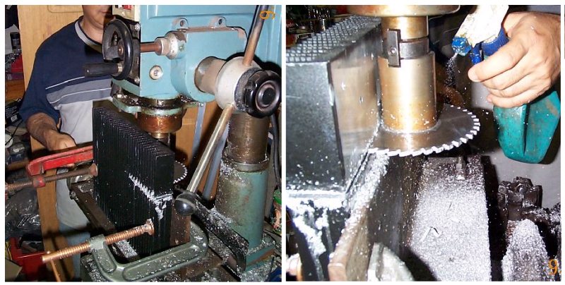

I used a tile cutting saw with a diamond disk
Andy
