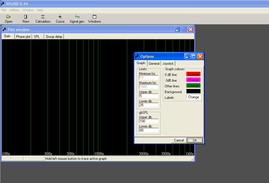

I have been using winisd beta for a few years with no issues. All of a sudden it just stopped working. All the horizontal lines are not working, and there is no woofer response at all. Oddly, I can find f3 by moving cursor around 😀 So I can still calculate a sealed box.
It started when I changed the lower db on the graph options.
Now it won't work even after uninstalling program and rebooting computer.
Only file I could find, were the woofer parameter files, but not sure if that is the cause.
Any ideas?
Here is a pic of the screen.

Have you read and followed everything in the help file?
If not, that's a good place to start.
If you have, and the problem persists, then perhaps posting a screen grab of what you see may help, as your description is a bit vague so far.

Hi David, thank you for your follow up answer, I did read the help file, but cant find the answer to my problem, I will read it again. You are right about my description here, it is a bit vague, my lock of terminology is the problem. I just star a new post with better info about my problem. Let see if this explaying is a little bit better, it says: Hi, Please help with Winisd. After entering all values for new speaker driver and saving it,
I go to the new project window and after clicking finish, the PLot Window dont show any graphics.
What Am I missing, I am using Winisd 0.50a7 I have restared the program several time etc, and
no fix. Thank you very much for helping me. Thank you again David
OK, thanks for the extra info.
I haven't used 0.5 for several years, (the current version is 0.7.0.95), so I'm not sure if this will help.
Does the plot window show anything if you start a new project with any of the drivers that come already in WinISD's database?
If so, that would suggest an error in how you're saving the data for the new driver.
