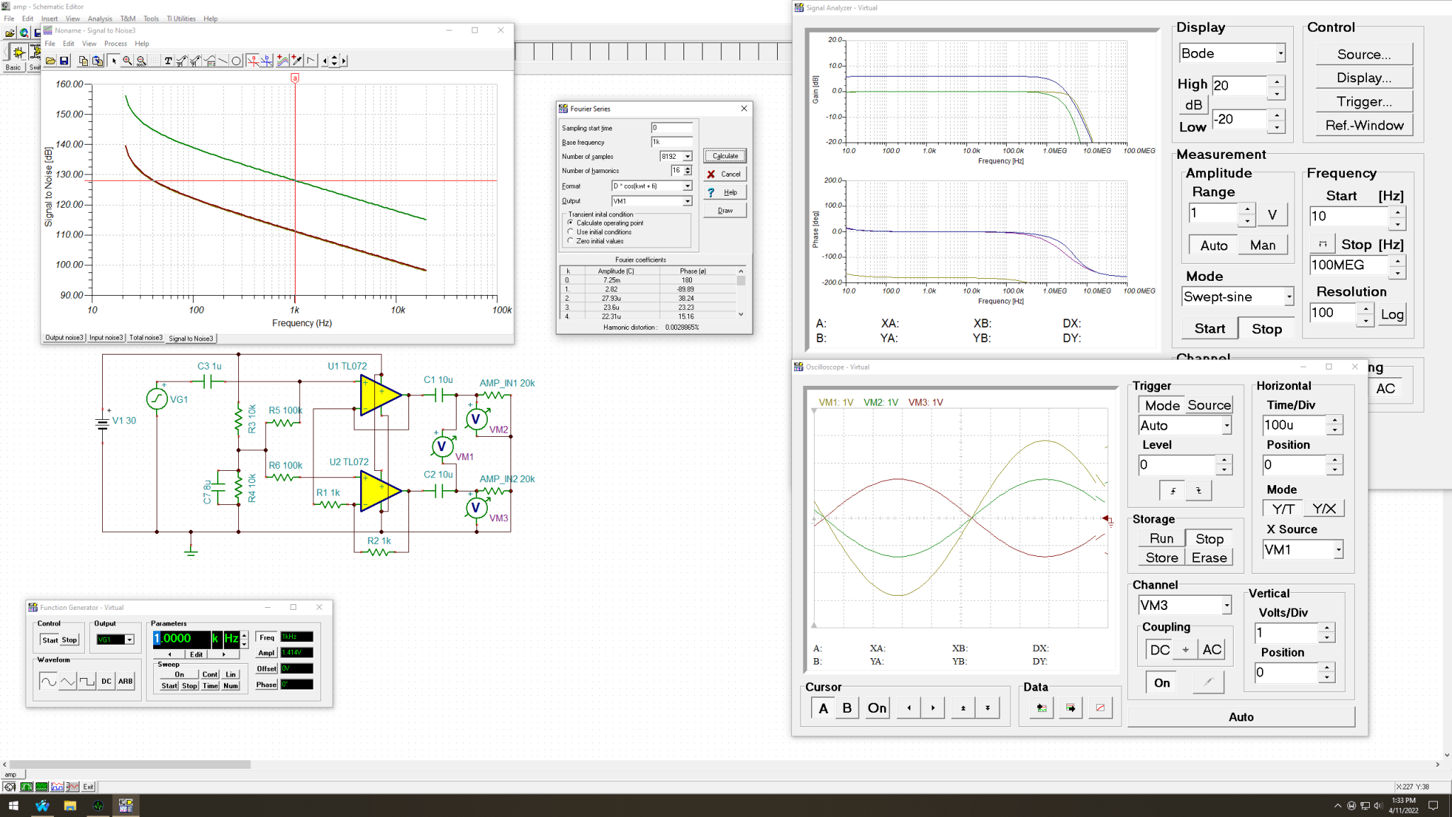

I've been playing around with the attached circuit lately and I'm very happy with the way it performs. I sim'd it with a TL072, but a higher quality op-amp will give even better results.
Reactions: jaycee
There must be something wrong with your noise simulation set-up then; a 40 nV/sqrt(Hz) noise source added to an 18 nV/sqrt(Hz) op-amp should be quite noticeable. Unfortunately I can't tell what is wrong from the screenshot. How do you define the output and input quantities for the noise analysis? Do resistors in your simulator produce thermal noise by default, like they do in SPICE and Spectre?
Reactions: theAnonymous1
I'm using TINA-TI but don't have much experience with it. From what I can find, it does model Johnson noise by default. Noise analysis was 20Hz-20kHz with an S/N signal amplitude of 1.
EDIT: Ok, it was just something weird going on with the program. Now when I change R6 to 0 the noise figures lower by more than half.
