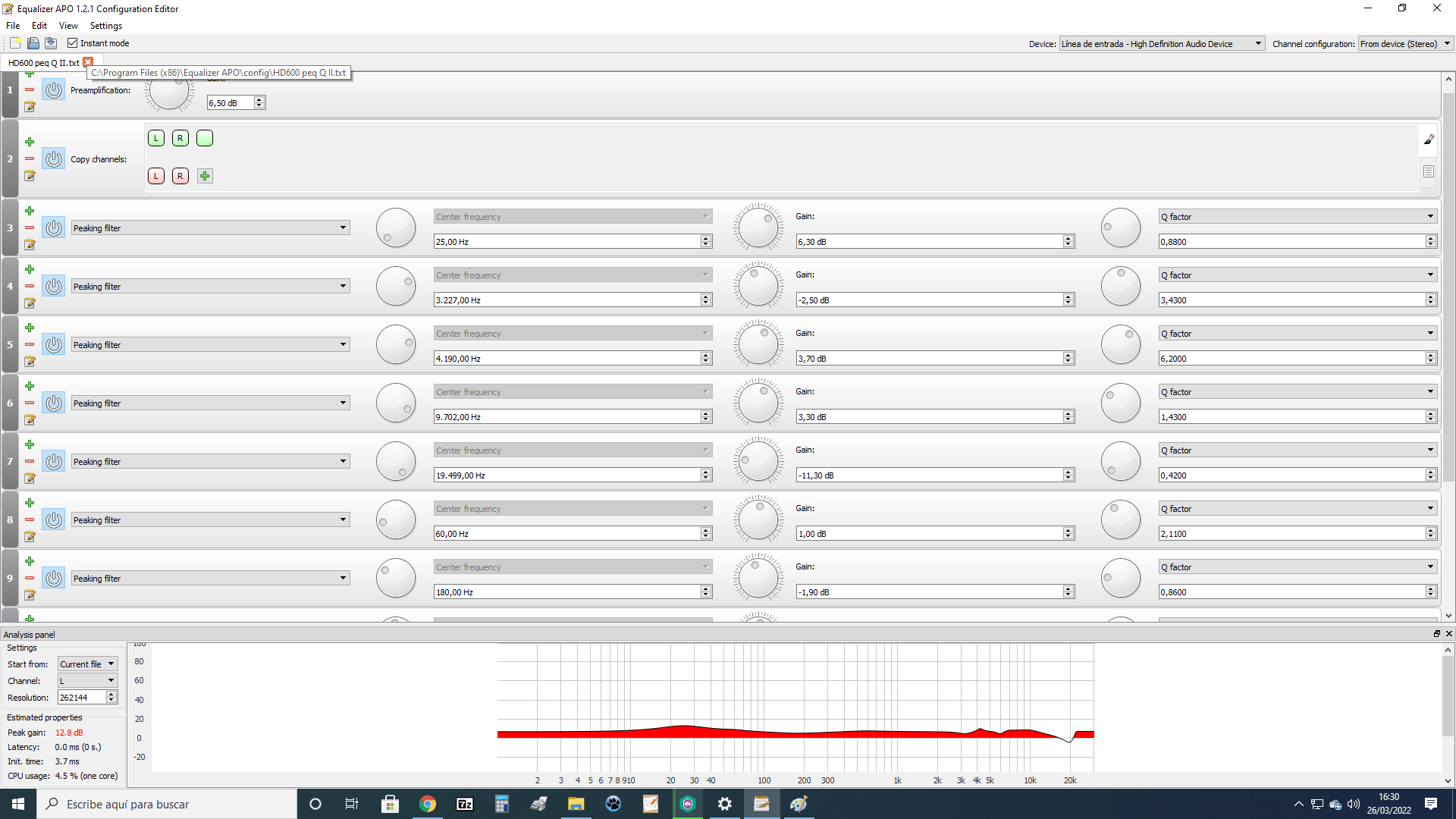

Do you refere to Analysis Panel?
C:\Program Files\EqualizerAPO -folder and then write Benchmark

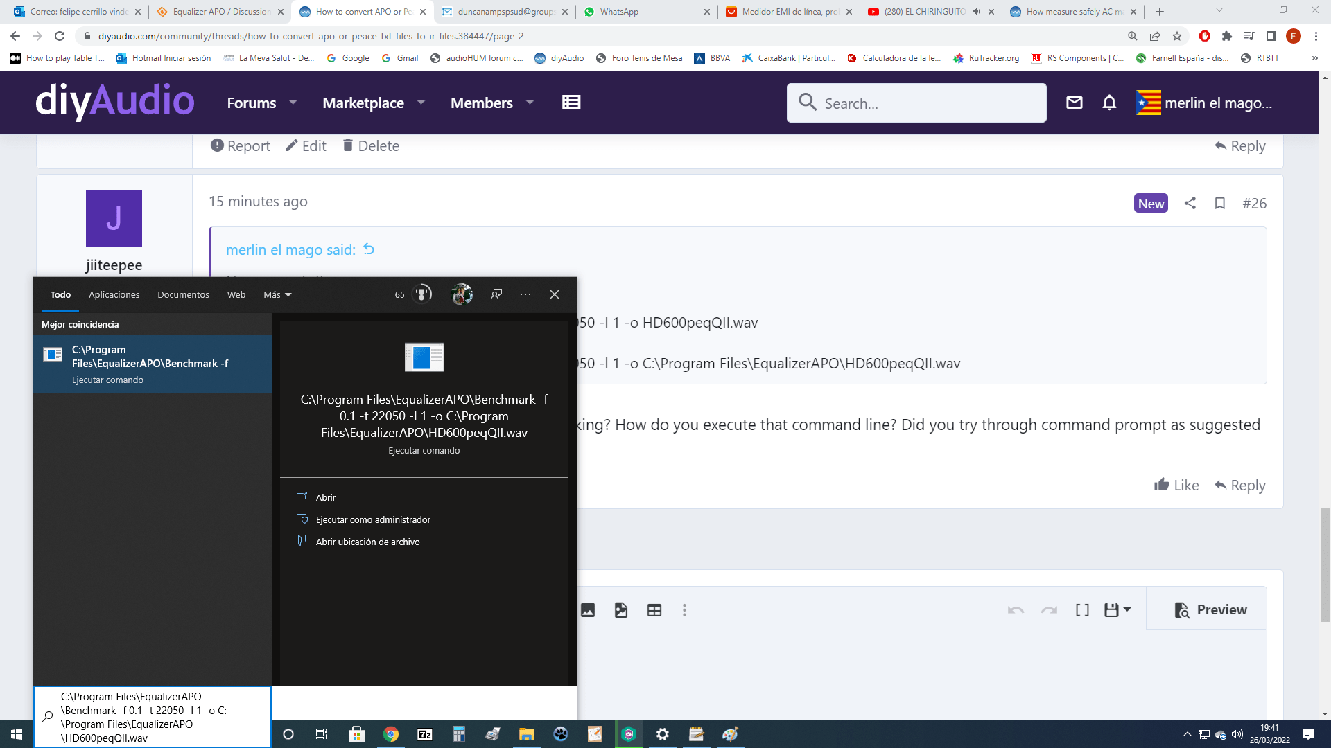

Guess: If you start Benchmark from Run -dialog then you heve to use full paths with Benchmark and probably for your output file too. An example:
Code:
C:\Program Files\EqualizerAPO\Benchmark -f 0.1 -t 22050 -l 1 -o C:\Program Files\EqualizerAPO\HD600peqQII.wav

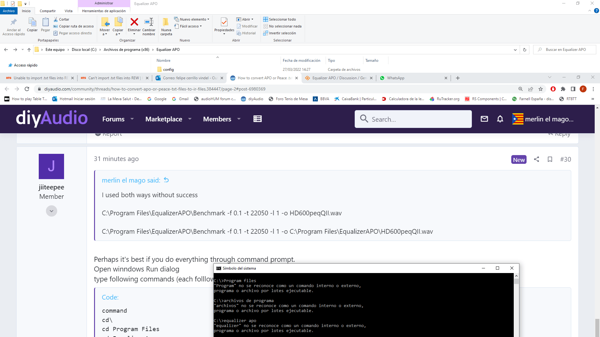

I used both ways without success
C:\Program Files\EqualizerAPO\Benchmark -f 0.1 -t 22050 -l 1 -o HD600peqQII.wav

Perhaps it's best if you do everything through command prompt.
Open winndows Run dialog
type following commands (each folllowed by ENTER)
Code:
command
cd\
cd Program Files
cd EqualizerApo
Benchmark -o HD600peqQII.wav
or
Also tried, also Program File (x86) and without x86.

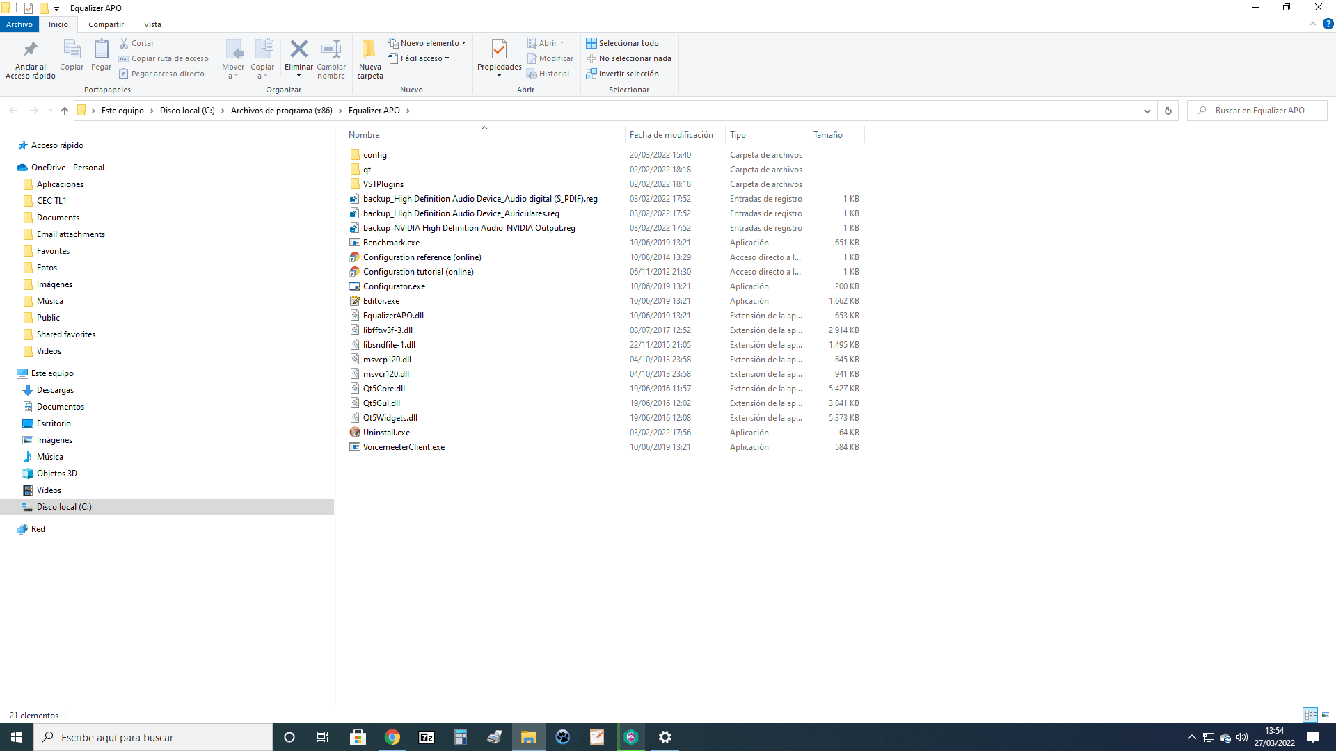

You attached an image in your post #29 above and there you can see he full path to EqualizerAPO folder (in your OS language) ... why try use C:\Program Files\EqualizerAPO when you can see it isn't there ... why not just change the folder names used in running the Benchmark by that info?
C:\Archivos de programa (x86)\Equalizer APO\Benchmark -o C:\Archivos de programa (x86)\Equalizer APO\HD600peqQII.wav

OK, after looking that reply with picture of your command prompt ... you can use C:\Program Files (x86)\Equalizer APO but use same path with the output file to get it saved to Equalizer APO -folder:
Code:
C:\Program Files (x86)\Equalizer APO\Benchmark -c 1 -o C:\Program Files (x86)\Equalizer APO\HD600peqQII.wav

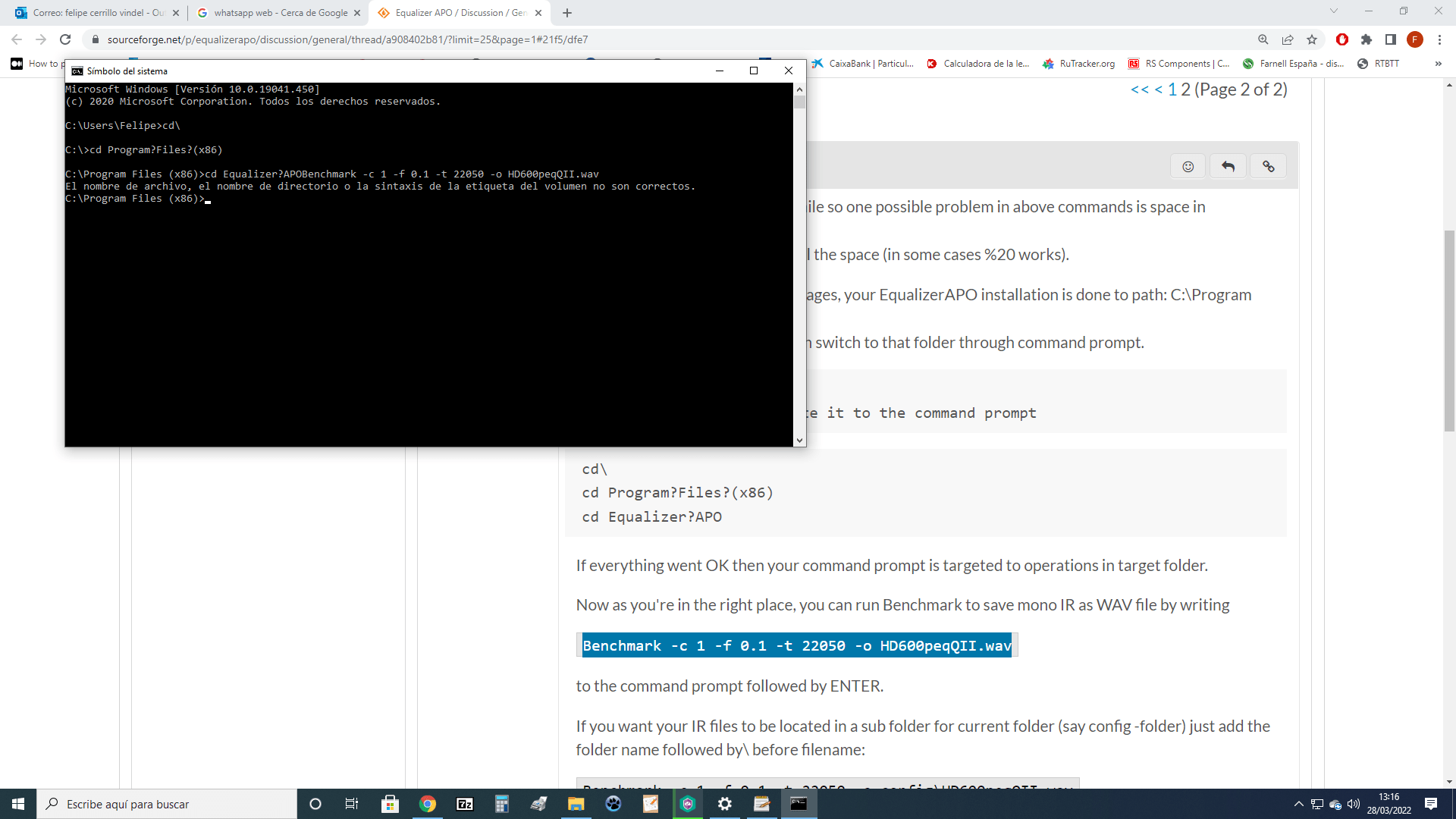

OK, by your previous attached images, your EqualizerAPO installation is done to path: C:\Program Files (x86)\Equalizer APO. If it is not this then make changes in the command set below.
Here are instructions how you can switch to that folder through command prompt.
  • start command prompt
  • copy below text and paste it to the command prompt
Code:
cd\
cd Program?Files?(x86)
cd Equalizer?APO
If everything went OK then your command prompt is targeted to operations in target folder.
Now as you're in the right place, you can run Benchmark to save mono IR as WAV file by writing
Code:
Benchmark -c 1 -f 0.1 -t 22050 -o HD600peqQII.wav
to the command prompt followed by ENTER.
If you want your IR files to be located in a sub folder for current folder (say config -folder) just use
Code:
Benchmark -c 1 -f 0.1 -t 22050 -o config\HD600peqQII.wav instead
If you want to save to a new sub folder then create folder before using it.
Check what all command line options there are for Benchmark utility. Remember also that you need separate IR files for each sample rate. Value to be used in -t option is usually sample rate / 2.
Everithing was OK till Benchmark -c 1 -f 0.1 -t 22050 -o HD600peqQII.wavView attachment 1039091View attachment 1039091
Looks like you have combined "cd Equalizer?APO" with Benchmark -command which won't work because of you are changing directory with cd -command.
Be sure second command is just
cd Equalizer?APO
so that after command the command prompt text is C:\Program Files (x86)\Equalizer APO and when this is OK then you can write (or copy paste) that Benchmark -command or just write Benchmark to see if it creates default file to this folder.
Enable full access rights to this folder if you get access errors.
