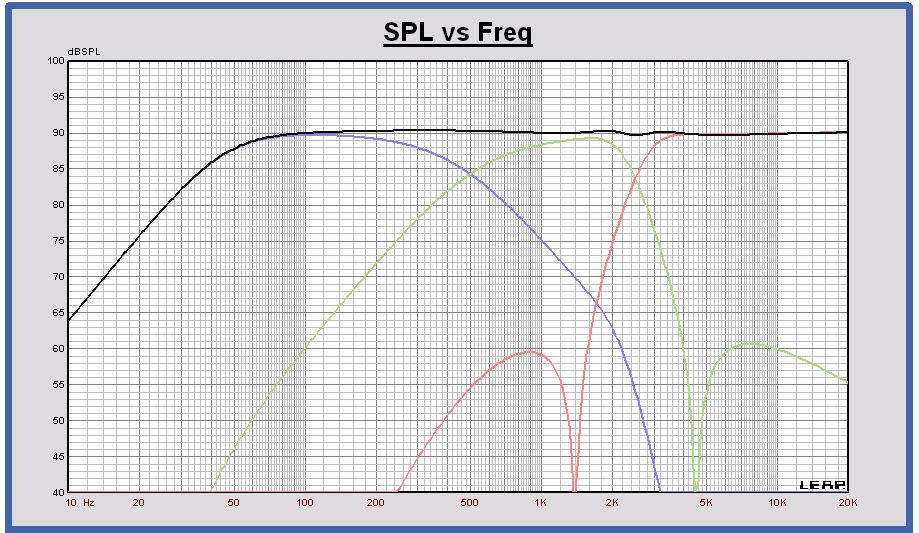

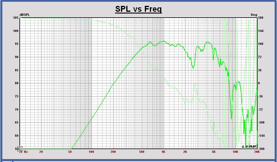

You can see the woofer is far from textbook ( because of baffle step issues), and so is the filter transfer function. Combined they yield a textbook acoustic BES 3 transfer function.
and hopefully now with pictures
The procedure is as follows: you measure an in-box raw driver and produce a .frd file of the measurement. Than you start with a more or less textbook filter connected to the driver and choose a so called target function. The latter is the desired textbook acoustic output, eg. LR4 lowpass @ 750 Hz. You then either manually optimize the filter components until you have a match, or let the optimizer do the dirty work for you. I have on purpose left out a few steps. You can both use active analogue blocks or passive filters to do the optimization, but the you also need the impedance. After optimization you have the exact transfer function of your corrective filter. Transform that .frd or .txt file into filter coeffs and you can use Eq Apo (or Camilla) to do the filtering for you. There are more elegant ways, but this is the Basic Old School approach.
Ok, so does the optimizer then gives you a suggestion for an active (or passive) analog filter? Or does it just give you a curve that you are expected to turn into something useful by yourself?
No, you have to start with a given topology. The more components you throw in, the more freedom the Optimizer has to achieve the desired result. I believe MachinaXP, which has its own thread here on Diya, is the only programme that does all this fully automatically, leading to rather complex passive filters. But that is no problem: the filter design itself is only the vehicle you use to find the needed corrective filter transfer function.

To answer HenrikEnquist question: it simply depends on what the user finally prefers. Some use the DSP as a development tool only, and then build it analogue (active may be somewhat cumbersome with complex topologies including gyrators) others use the DSP as a final solution. Of course the DSP version offers additional bonusus such as phase and room corrections. But the audio world -including the diy scene- is rather conservative: relatively few people make use of any form of room correction, convolution, Harman or House curves etc. Most here seem to stick to A/B amps and passive filtering, not to mention the use of totally uncorrected full range drivers.....
