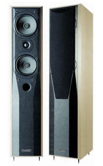

In fact I made a mistake they are not 703e but 773e s 🙄
The cones are approximatly 10.5cm or 4in in diameter. I am not sure though if they recieve the same signal or if one does mid and the other does bass??

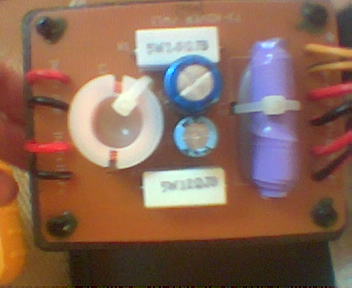

The speakers have two sets of terminals and I have already taken the passive XO out to have a look, unfortunatly the value of the inductors isnt marked on it. I dont have my digital camera with me but i should be able to post a picture of it tomorrow if that would help.

Sorry about the quality of the image but like i said i dont have my digital camera here today. On the left are the inputs on the right or the outputs, when i measured the voltage on the outputs for both the drivers they were always identical so i am assuming they recieve the same signal.
Neither inductor has any markings on them. the top resistor is a 5W 1.5 ohm. The bottom one is 5W 12ohm.
The dark blue capacitor is 4.7uF 50V +/-10% and the other one is 20uF 50V
I hope this is some help

It isn't just a matter of the crossover frequency, it's a knowledge of the entire transfer function of the crossover. You can't determine that by just looking at the crossover board, you have to go in and measure it.

I think that if we know the crossover as mission did it, we'll have a useful clue about what someone decided was good. Then you'll have to take the decision
Maybe the big resistor is for impedance compensation.
Is it possible to get the scheme of the board, following the cooper tracks?
Obviously, not only the crossover point is the target, the slopes are too.

But I think that deducing the crossover scheme from the board could be also helpful.
