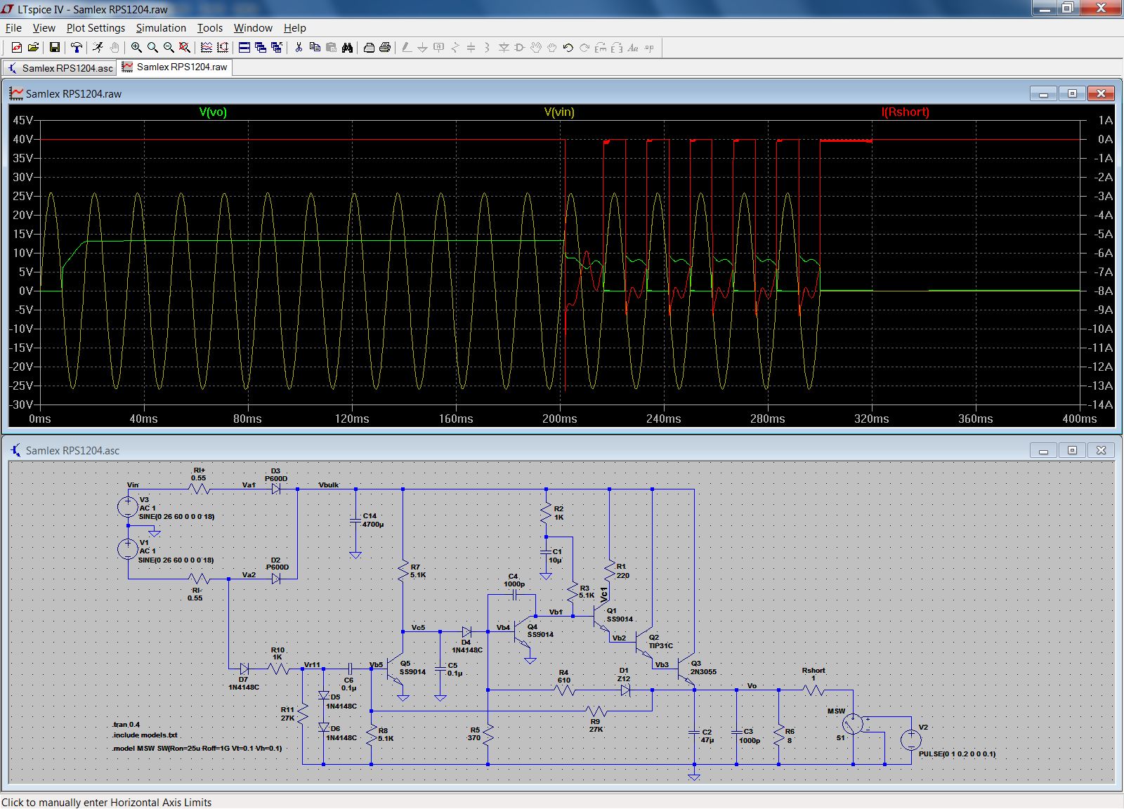

How to change the output voltage from 13.8V to 12v with this circuit
Disconnecting D4 breaks the loop as well as R9. The input circuit seems to place the regulator in hiccup mode during a shorted output. The asc is attached for anyone who wants to play.
With an output to low (short) there is no base current for Q4 via the zener nor for Q5 via R9.
So now the collector of Q5 has positive pulses from the base drive via C6 making Q4 conduct followed by the rest, Q1Q2Q3.
Rather bad condition.

it´s not a startup circuit , but a switch-off circuit; as soon as 50hz fails, the feedback transistor with it´s emitter to gnd is driven such that the supply turns off.
during turn off the NPN driver is challenged in it´s VBE as the base is drawn negative vs the emitter that stays on 12V from the output capacitance. so the NPN base will zener around 5V, and probably it´s base current will exceed temporarily the maximum current allowed. over time this will result in reduced beta.

Yes, that's what I thought based on an informal analysis (see above), but another member dug deeper and went as far as simulating it, and only found minor differences with/without the additional circuit.
I am pretty sure that the sim is accurate; there might be a typo in the component values, causing the lack of effectiveness, but the main goal does seem to be a quick and clean shutoff anyway
That will not happen.
The fast turn-off starts when Q1 (reference original shematic) doesn't conduct anymore. But as long as the output voltage is over 5V or so the Q1 base is kept positive via R2.
So, no quick turn-off exept for the last 5V , seems rather useless ??

Q1 is a protection circuit that shuts down the output when it is shorted. The AC input is a pulsed restart attempt.
As others have pointed out, no change in R7, R10 etc will reduce the voltage below DZ1+Q2 = 12 +0.65 = 12.65. A better design would be to add a base series resistor to Q2 so that R10 could be zero, but perhaps a wider voltage range is not desirable.
