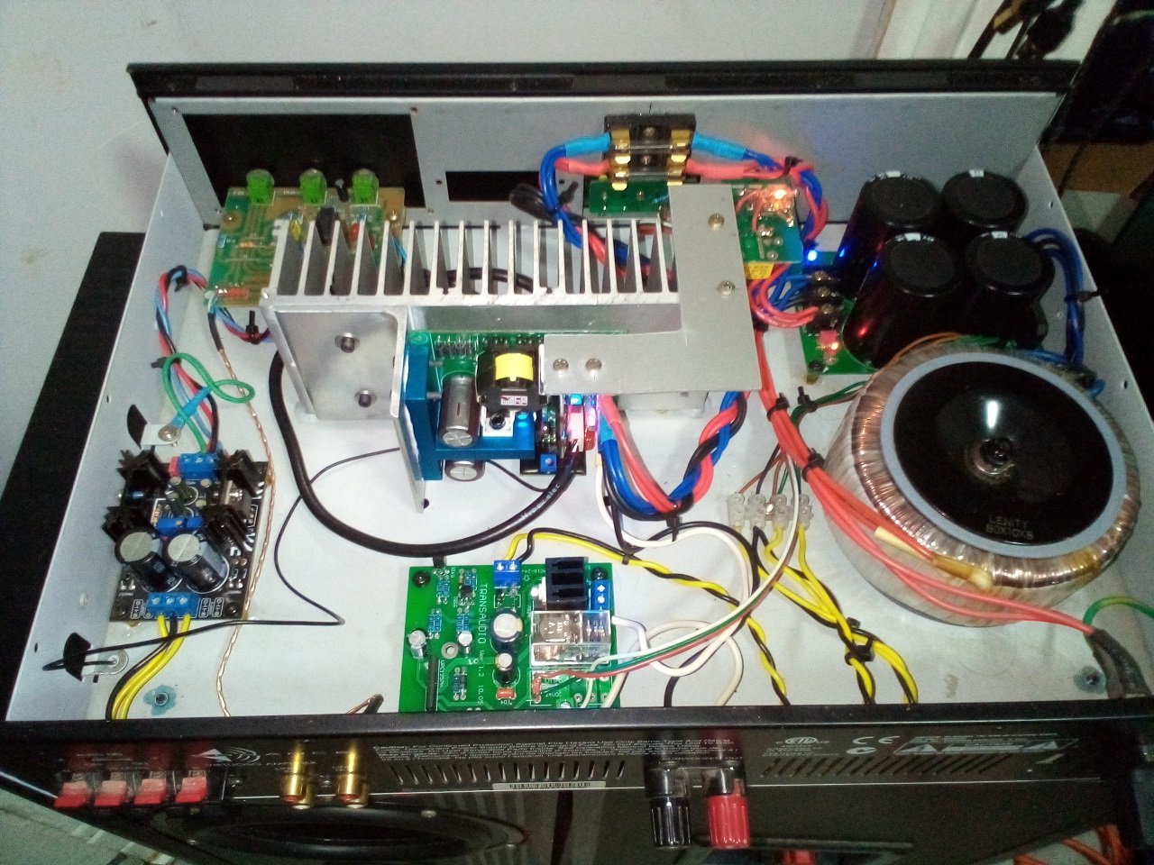

Class D (Hypex) is VERY interesting to me , fully out of phase self oscillating amp , with the output duty cycle
of said oscillation modulated with the audio ! I'll oscillate for 400 watts !!
(below) One big loud freakin' oscillator !!! 🙂
