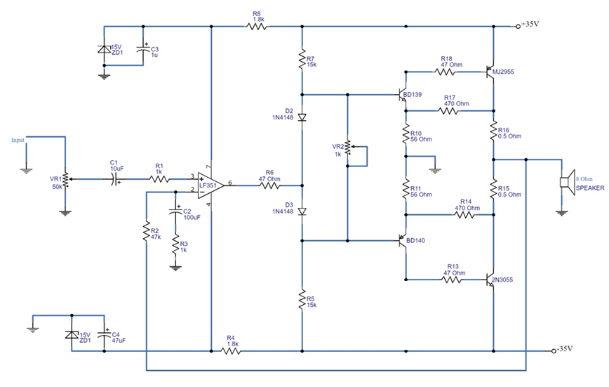

How to change the circuit of power amplifier ?
Wow , as well as him not having enough power to run the circuit - - - look at the circuit ! Not too good ,
man !! No nothing (compensation , decoupling).... nothing. Alibaba circuit ??
Yeah , I second a little chip-amp tda 2050 , or other TDA's direct coupled.

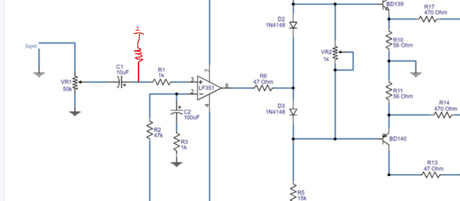

Per OStripper this schematic is pretty basic. Feedback direct from the speaker line to the op amp input 3 is an invitation to oscillate driven by radio interference. 14 turns .5 mm hookup wire wound around a china marker or 8 mm dowel series the speaker could really help that. Feedback line goes inside that. If still oscillates, I'd try 50 to 100 pf parallel R2. And for RF pickup from the input, I'd put 100 to 130 pf to analog ground between c1 and r1. Of course, needs a grounded steel or aluminum case to also keep the RF out. I use portable steel file case with a square hole cut to allow the heat sink to be outside.

If he has a split secondary , just double up ( or join the CT for 50V). And use a capacitor coupled OP stage.

I can't believe the OP posted circuit. Not dangerous , but "childlike".
His PS would not run a class A amp !
His power supply would be bare minimum for my "pitchfork " headphone amp.
He needs to scout the dumpsters for some big toroids !
Wish he was local , I have 1-150VA 35-0-35 and a 200VA 40-0-40 in my junkbox. I'd give it away.
