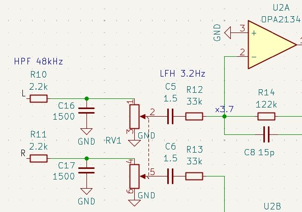

Dear friends!
I am assembling a headphone amplifier. I have a question: how to correctly calculate the value of the potentiometer RV1? I heard that it should be about 10 times less than the input resistance of the amplifier. In my case, the input resistance is determined by the value of R12 and is equal to 33k. Then I need a potentiometer of 3.3k? But everywhere where I studied the circuits of similar amplifiers, they recommend a potentiometer value from 10k to 100k.
How to choose correctly?
PS. Input signal goes from PCM2704 DAC (recommended output impendance 10k or more).

If you use 3k3 you will lose 40% of the signal across R10. I would lose the input filter circuit, make the pot the input loading, and make the 48kHz filter part of the opamp NFB loop. You’re compromised in how big the pot can be because of the inverting amplifier following, and how small it can be because of what loading the source needs.
Ok. I can remove R10 and C16 and change the value of C8 to 27pF. After that I can use 3.3k pot. Am I right?
But what will be the input amp impedance in this case? 3.3k? That's too little for my signal source. I need at least 10k. Or it still will be 33k?
...I heard that it should be about 10 times less than the input resistance of the amplifier. In my case, the input resistance is determined by the value of R12 and is equal to 33k...
10 times more, not less!
With R10 and C16 removed, the impedance seen by the preceding stage is:
Rin=RVu+(RVl//R12) where RVu is the upper section of RV1 and RVl the lower. "//" means "in parallel with".
So: Rin=RVu+(1/RV1+1/R12)^(-1)
It turns out that the minimum impedance is when the wiper is at the top of RV1, i.e. RVu=0. We can plug in different values for RV1 to see which values keep the minimum impedance above 10k.
Rin(min)=(1/RV1+(1/R12)^(-1)
If R12=33k, different values of the potentiometer result in the following Rin(min) values:
RV1 Rin(min)
10k 7k7
33k 16k5
47k 19k3
100k 24k8
I assume RV1 is intended to function as a volume control, in which case I would suggest a 47k log pot is the most suitable.
With C8=27p, the LPF is correctly set to c. 48kHz.

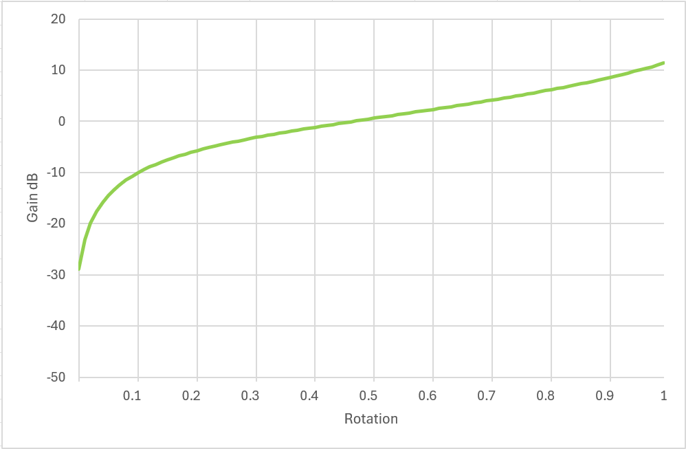

You can use a 100k linear pot, which loaded by 33k will give you a roughly log taper response, with the added advantage that dual linear pots usually have much better balance between gangs than log pots. For details of this technique, see here: http://www.geofex.com/article_folders/potsecrets/potscret.htm
A 100k lin pot is a great idea in principle, but will it provide enough attenuation to be a useable volume pot? Here is its gain plot:
