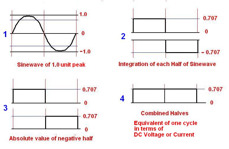

RMS
Can we agree on what this is?
See jpg.
The 0.707107 of peak is 1 / (2 ^.5)
But is derived by simple (no calculus needed) math. (unless you count finding the sine of a value as calculus)
In your favorite spread sheet make a column of 0 to 359 (A1 to A360)
In the next column find the sine of those angles in degrees (not radians) (B1 to B360)
This would be the equivalent voltage (or current @ 1R load) at each degree.
In the next column put in the results of B squared (divided by 1R) (C1 to C360)
This is the power in one degree of the cycle.
Average this column.
You will get 0.5W
P = V * V / R so V * V = P * R so V = ( P * R) ^ 0.5
The equivalent DC to produce the same power in a resistor is ( 0.5W * 1R ) ^0.5
=0.707107V
or in this case 0.707107 * Vp
Yes?

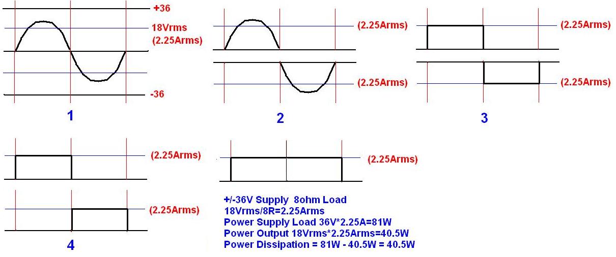

So, getting back to power dissipation on a +/- 36V amplifier with an 8r load.
From post #3:
With 18Vrms, 8R load the power output is 40.5W
Current drawn from the supply is 18Vrms / 8R = 2.25A
I get a power drawn from the supply at 81W (72 * 2.25 / 2)
Power dissipation is 81W - 40.5W = 40.5W
I learned that max power dissipation was at 50% of maximum theoretical output:
Max power diss = Vps*Vps / (16 * RL)
(Both are calculating for class B...Quiescent current for class A or AB adds additional power dissipation)
See jpg
Dug,
Your spreadsheet approach will get you the right answer if you set up the problem correctly.
Assume 1 Hertz to make things easy, then each degree represents 1/360 of one second. Calculate the energy delivered by the power supply. That is Vps*Ips*1/360.
Sum up all the energy taken from the power supplies, and divide by the total time. In this case, it's 1 second, so the division is trivial.
If you're careful with your factors and definitions, you'll come up to the result in my white paper.
All the best...
Dan

I did as you suggested and came up with the following results. (see jpg)
"...Sum up all the energy taken from the power supplies, and divide by the total time...."
(copy and paste values of the spreadsheet results).
Max power at 32.8W
Now the question is:
Where is the flaw in my "method"?
Is the rms current in the load not the same as the rms current seen by the supply?
I thought about it...
I think I have the answer that satisfies both methods!!
Your method assumes that a sine wave is the signal.
I will now agree to that.
