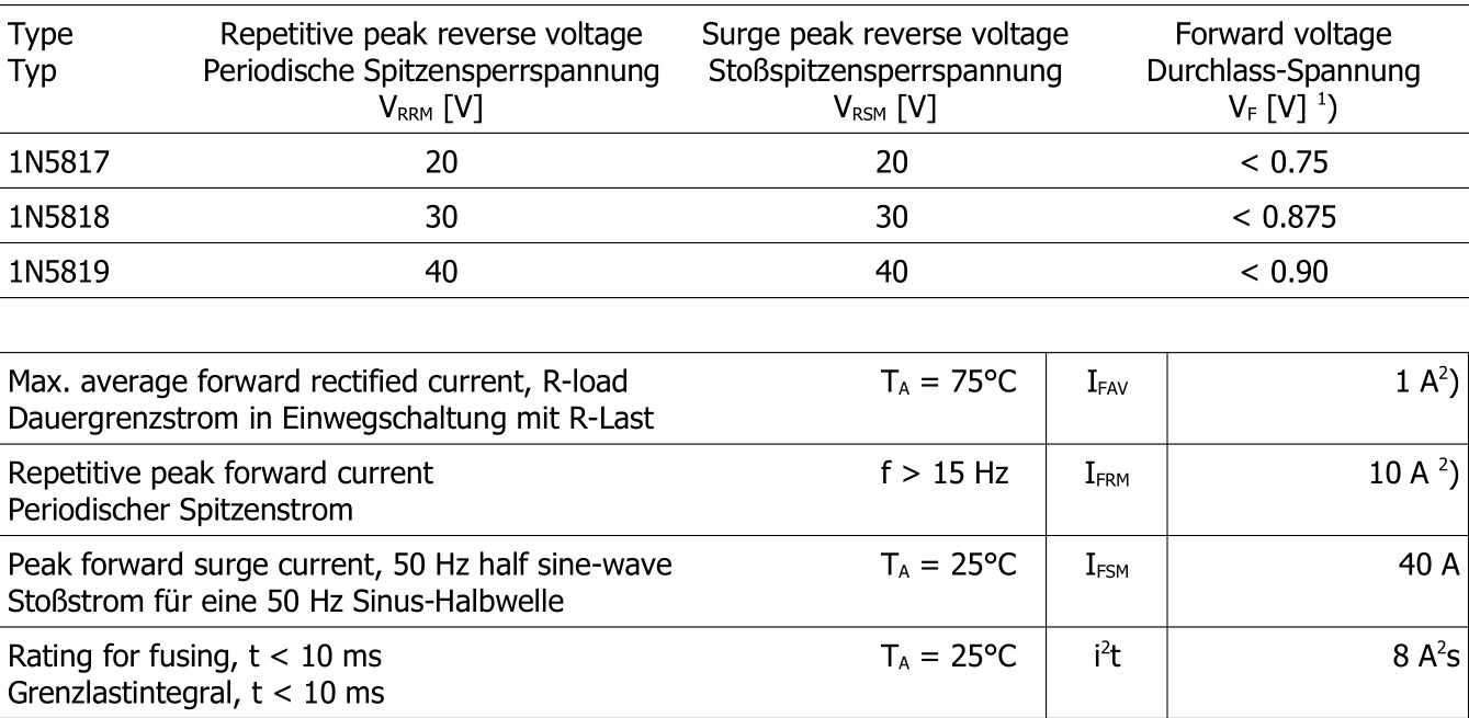

Can’t be as 1N581x diodes are 1A rated Schottky diodes. Normally one checks parameters and sees a 1A diode is not the right one for a 3.25A load. Checking/comparing parameters is to avoid mounting tractor wheels on a car and vice versa. To avoid even hotter diodes than the previous ones.

That's why I included 1N581x series as an example to illustrate that "old" type Schottky diodes forward voltage (thus dissipation) is more than modern ones.

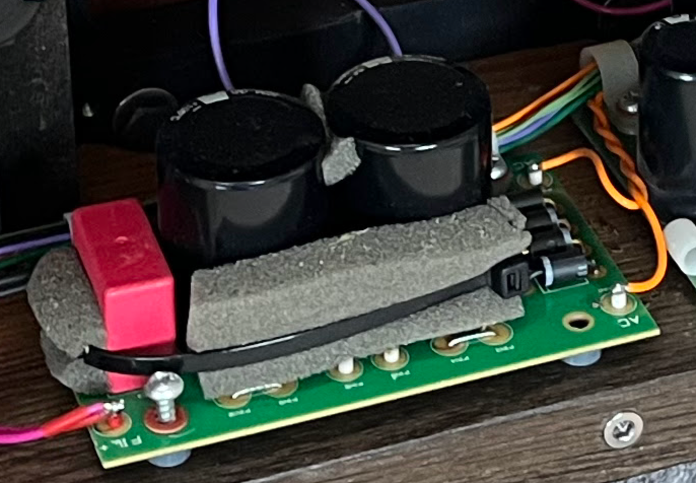

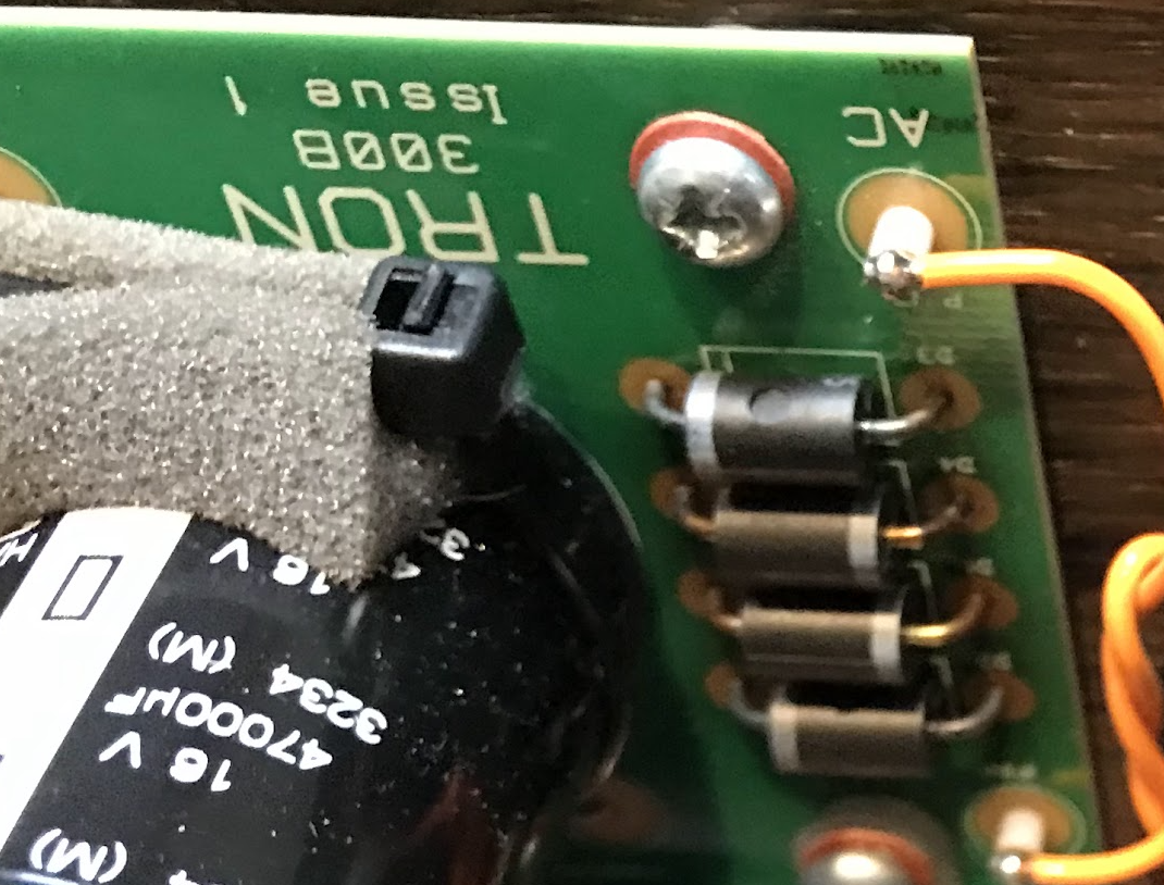

Measured the Diodes with my IR gun. They are orientated vertically and so each diode sits above the next, the top diode getting the hottest
D4Top =80 DegC, D3 65 Deg, D2 50 Deg C, D1 40 Deg C
How does that sound, assuming the IR gun is correct
Correct. It helps to keep distance between them and having distance to the PCB for unobstructed air flow. Also to bend the highest one a little further. They have been placed incorrectly but that is just like that. Drilling the holes will help to create air flow from another direction.
Measurements should be done after about 30 minutes operation.
Temps as they are are not shocking but less warm D3/D4 would be good.

Once I find out what they are I will get some new ones with longer legs and get some air around them.
They are located vertically, as shown from this view of the underside of the amplifier, so drilling the PCB will not help much

It will! There will be an extra path per diode for air drawn through the space between wooden side and PCB. It will work together with elevated mounting of the diodes (again creating an extra path to loose heat to the environment). They have indeed been mounted the least optimal way for even heat transfer.
What they are? They are rectifier diodes of the 5 to 10A kind. What type the diodes are?

Assuming the IR temp was of the surface of the plastic encapsulate of each diode (IR guns likely have a spot size larger than a diode), then could guesstimate the junction temp as a slightly higher value.
Designers likely ballpark for a Tj below 100-120C, given a max rated Tj of 150C, and range of anticipated ambient. D4 seems to be significantly below 100C, but you have described the ambient environment.
So far you haven't assessed the operating current, or its waveform, or identified the diode, or the conduction paths on the pcb, so lots of variables before honing in on a better awareness. D1 is obviously isolated thermally with a lower local ambient, and likely less thermal conduction along tracks.
