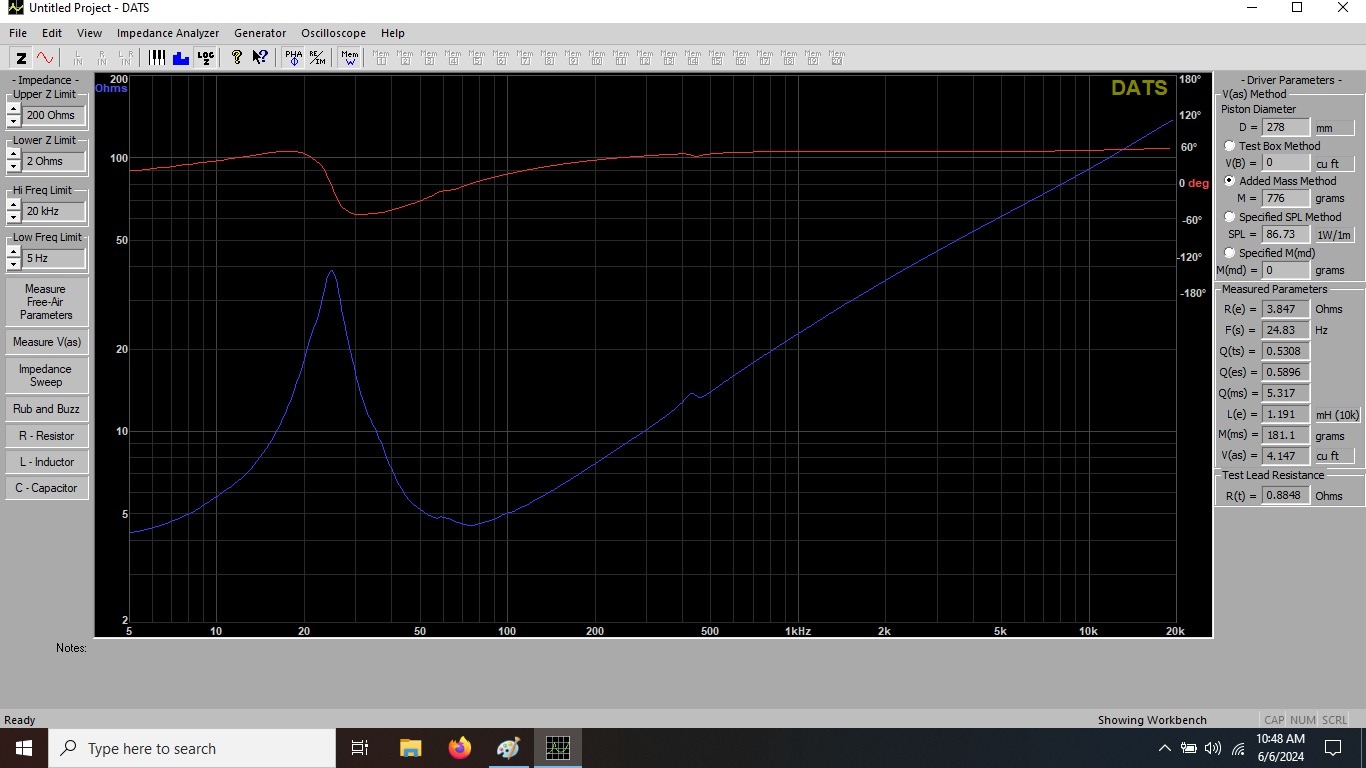

Just working through what I've measured and comparing to the snippet:
Single driver in free air:
Re = 3.847
Fs = 24.83
Qts = 0.5308
Qes = 0.5896
Qms = 5.317
Vas = 4.147 ft^3
For snippet use:
Fs = 24.83
Qms = 5.317
Qes = 0.5896

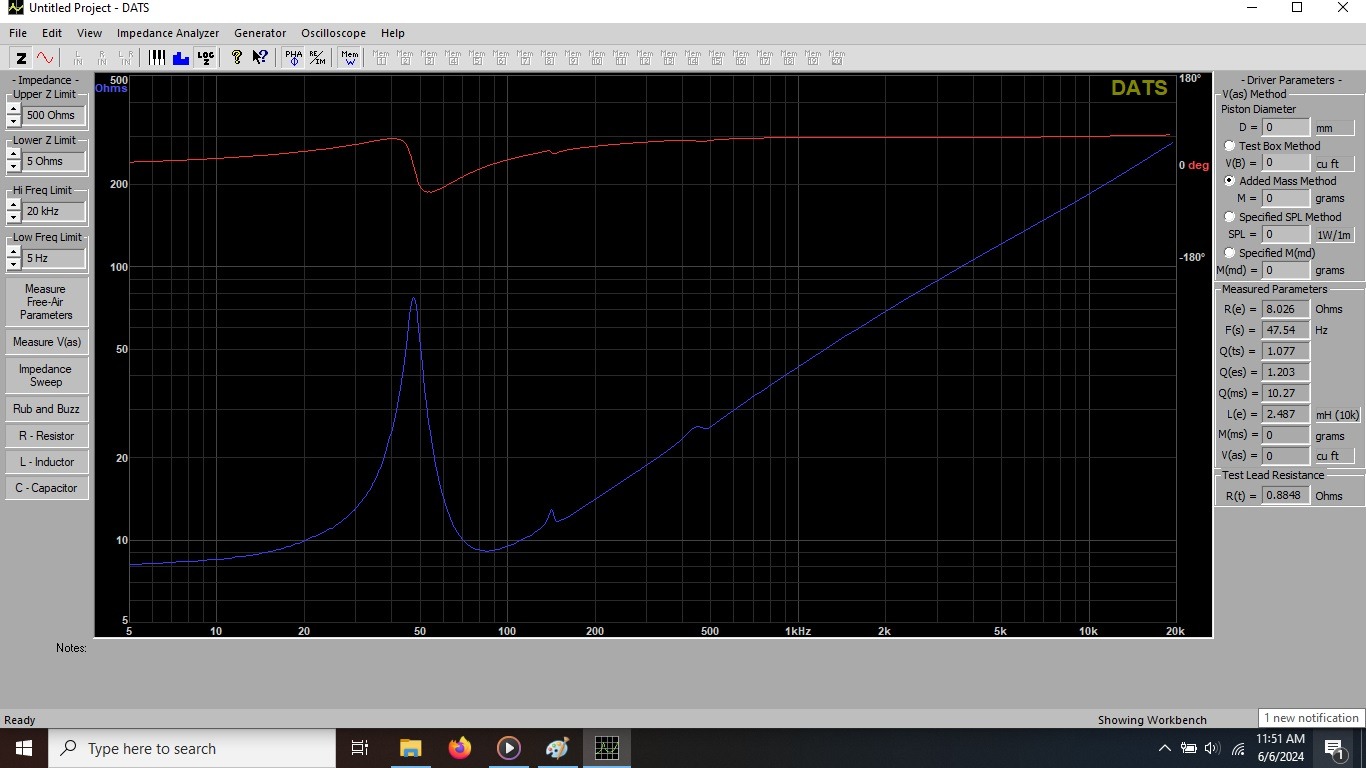

Both drivers in the enclosure without filling:
Fct = 47.54hz
Qmct = 5.317
Qect = 1.203

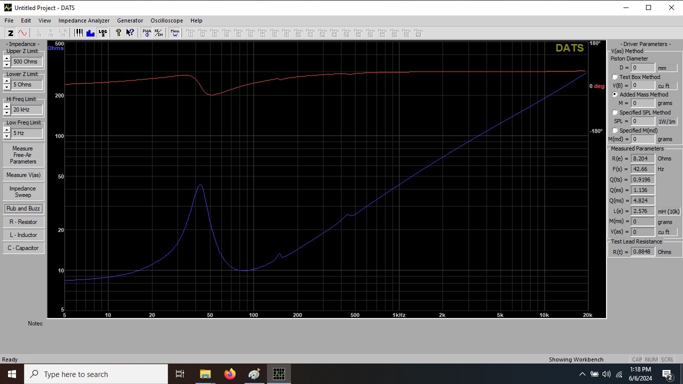

Both drivers in the enclosure with filling:
Fc = 42.66hz
Qmc - 4.824
Qec = 1.136

However, if I assume the above for filled:
Qtco = QmcQec / (Qmc+Qec)
Qtco = 4.824 * 1.136 / (4.824 + 1.136)
Qtco = 5.48 / 5.96
Qtco = 0.919
What am I missing there? If that's true, then Q went up? But the efficiency changes suggest Q should have went down? Maybe I have that incorrect? A larger Qtc suggests my box is "smaller" for the drivers' behavior. Stuffing shows the Q droped a tiny bit (0.060).

Since you have a DATS system, in your case the procedure is very straightforward
1 - Measure Qms, Qes, Fs and Re of driver free-air
2 - do the same with unfilled box
3 - same again with stuffed box
That's all you have to do.
For just knowing only the Q factor of the total system + damping material, you can just only do step 3.
Connect the speakers as you're gonna use them in the system.
Just see this as DUT.
If you're interested in how much volume has gained, see the Vab/Vb formula.
This will just give you a ratio (like a percentage) of increase.
There is literally nothing more to it.

So, going back to moving mass ratio:
Mac / Mact = FctQec/FcQect
Mac / Mact = 47.54hz*1.136 / 42.66hz*1.203
Mac / Mact = 54.005 / 51.31998
Mac / Mact = 1.0523
This ratio implies its minimal I assume?
Now, volume change:
Vab / Vb = ((FctQect / FsQes) - 1) / ((FcQec / FsQes) - 1)
= ((47.54hz*1.203) - 1) / ((42.66hz*1.136) - 1)
= 56.19062 / 47.46176
= 1.1839
Or 18.39% change in volume?

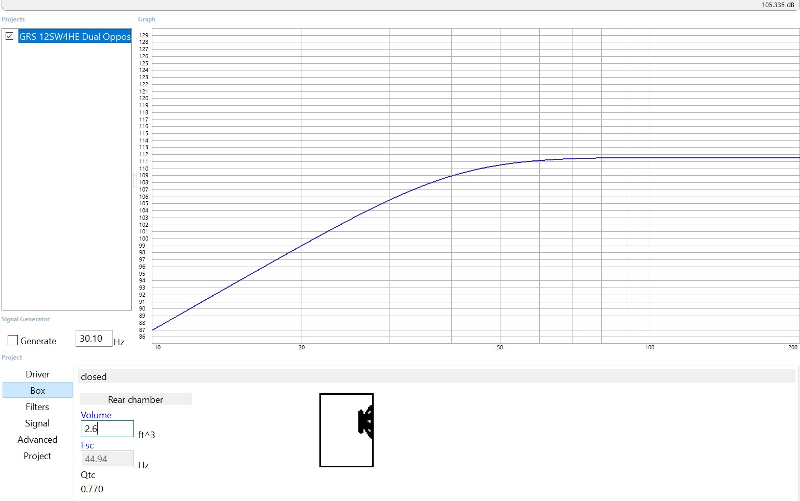

This is the simulation.
Qtc = 0.770
My measurements are of the built enclosure after this.
Just trying to see what the Qtc is now effectively, not simulated, and after stuffing to see what it is.
From my measurements and these calculations, the Qtc > 0.9 implication and the effective volume increase of about 18% don't seem to match what I would expect. Qtc > 0.9 implies a smaller volume, and an increase in 18% of effective volume from stuffing means my Qtc should go down, correct?
Very best,
I assume that's simulated with the parameters from the datasheet, not your actually measured parameters?This is the simulation.
Qtc = 0.770
We know the Qt of the actual driver(s) from your free-air measurements.
How much is the difference between the datasheet values?

Correct, this is from published values.
I'll model based on the measured values. This is probably where the difference really is. I've yet to see a driver close to its measured values, unless I'm measuring incorrectly or unless my calibration is way off.
Edit: Welp, I tried to simulate the driver in WinISD with the measured values, but it won't pass integrity and fails. I think the values just don't allow the derived values to come together properly. It crashes. So I don't think I can really check this. But that said, the measured values are significantly different from published, so this is likely the problem. In reality it probably never was 0.770 Qtc and was probably over Qtc 1.0 based on measurements I'm rough guessing and came down from there, implied by calculations from measurements.
Very best,
Or when manufactures don't cherry pick 😉I'll model based on the measured values. This is probably where the difference really is. I've yet to see a driver close to its measured values, unless I'm measuring incorrectly or unless my calibration is way off.

OP, how did you take this measurement? driver resting on a table?We know the Qt of the actual driver(s) from your free-air measurements
a jig needs to be used to support the driver so it is "in free air" away from other surfaces
test out your measurement setup with some 5R and 47R 0.1% resistorsunless I'm measuring incorrectly or unless my calibration is way off
It was supported on a jig so the vent pole was open and away from a surface. The only contact points were small areas on the magnet.
Very best,
