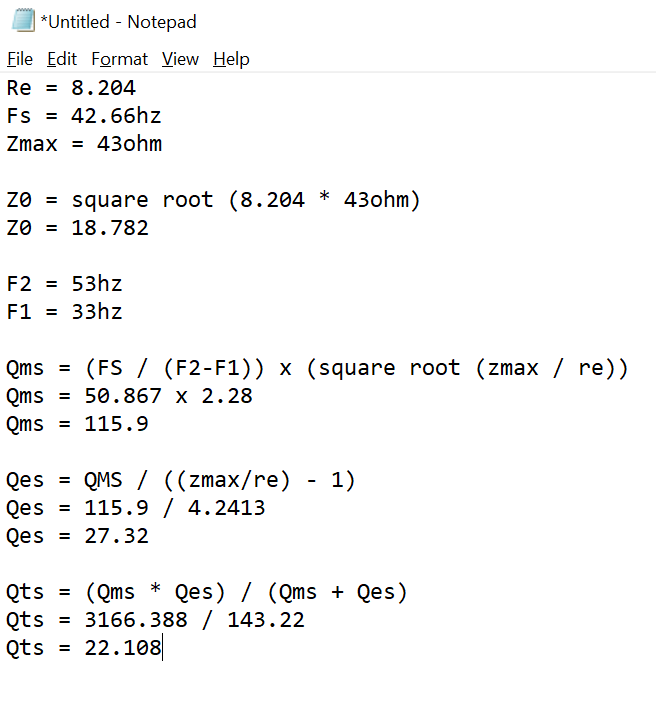

Thanks. I'm trying to follow the logic. It seems easy. But I'm not getting sensible results.

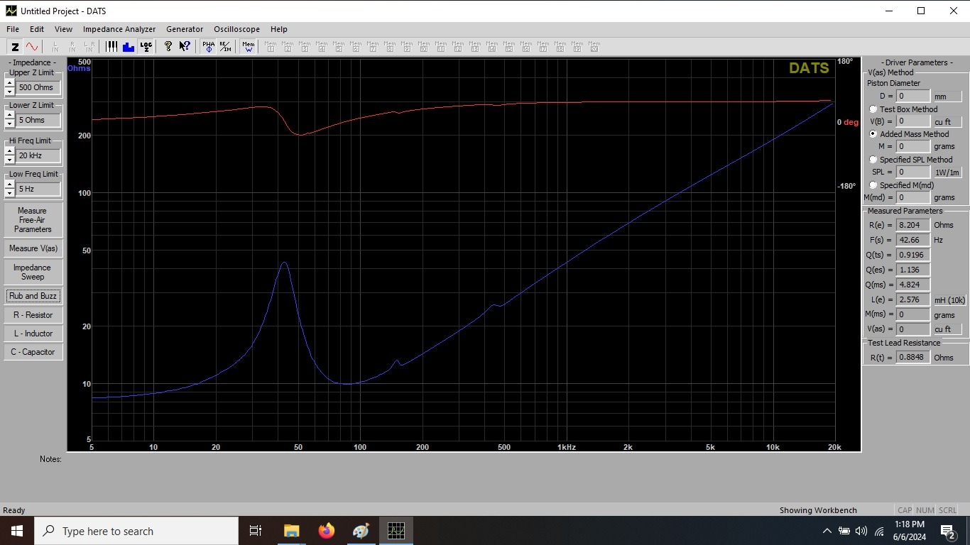

New enclosure with 2 drivers, sealed. Here's the DATS on it:
Using this logic:
Calculating with my values from DATS:
I'm sort of lost with what happened there.
I must have missed something?
Very best,

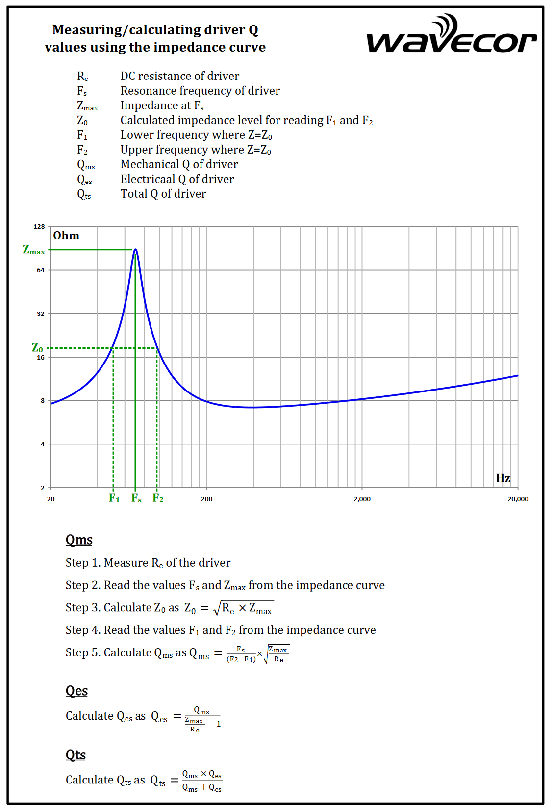

Your calcation for Qms is off.
Z0 = SQR (8.204 x 43) = 18.71
Qms = (42.66/(53-33)) x SQR(43/8.204) = 4.88
Qes = 4.88 / ((Zmax/Re)-1) = 1.15
Qts = 0.93
The above method is sensitive to errors reading from the graph though. You can check accuracy to check that SQR (F2 x F1) = Fs.
In this case SQR (F2 x F1) = 41.8 Hz. This is close to Fs = 42.66 Hz, so I would say that Qts is as reliable as you can expect from this method.
Qts = 0.93

I zoomed in on your tool, and the info you are seeking is right there on the middle right hand side. LOL
Qts = 0.92.
Hi thanks, that was the issue.
Yea, it's measured there, but I wanted to derive it from just the impedance sweep just as a learning point.
Qts is the driver(s) of course. That's two drivers wired in series. I'm not sure if that matters here.
Ultimately though, is this the Qtc of the box? Or is the measured 0.92 Qts just the Q of the drivers?

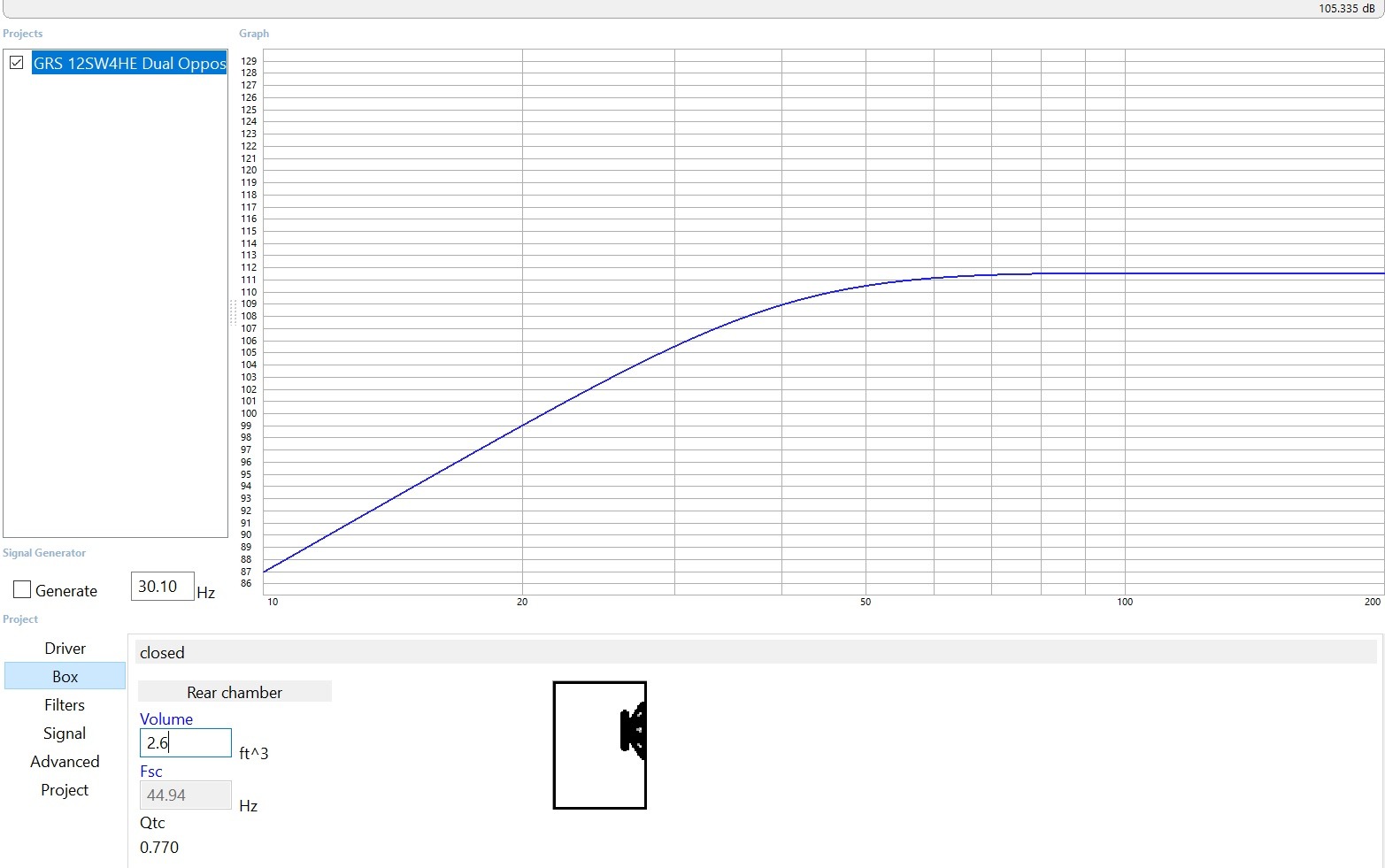

My enclosure's net internal volume is 2.6 ft^3 and I stuffed it at 1.538 lbs per ft^3 with polyfil. It has 2 drivers wired in series. I have the before & after stuffing impedance graphs if needed. The simulated Qtc was 0.770 in my model. I'm trying to discover what the Qtc is now after stuffing and real world (not just my model) to account for differences in execution relative to the model.
The model (with Qtc = 0.770):
The 2.6 ft^3 net volume sealed enclosure with the two drivers wired in series with no stuffing:

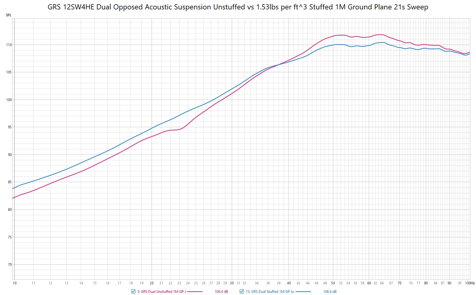

The above but with 1.538 lbs per ft^3 stuffing polyfil, or 4lbs total of poly fil and the resluting changes:
Resulting ground plane measurement differences, stuffed vs unstuffed (blue = stuffed):
I'm trying to discover what my Qtc is now. I think I have the rest figured out here. It's just the Qtc that is still difficult. It's not 0.770 I imagine anymore. But what is it?

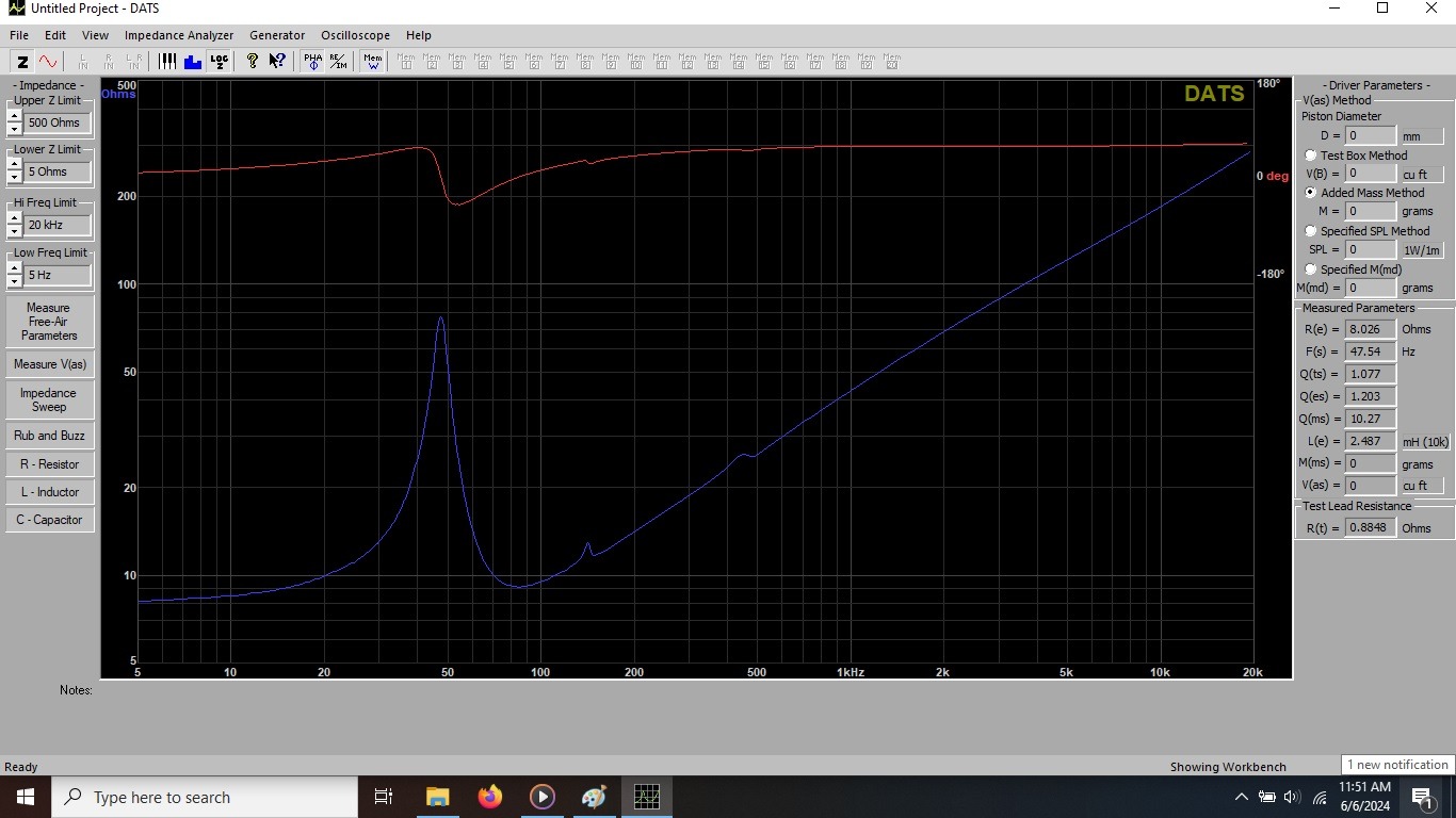

Fc is the box resonance with the driver, in my case, unstuffed it's 47.54hz and stuffed it's 42.66hz. Right?
Qtc is currently unknown, so I'm trying to solve for this.

You can use the same 'Wavecor method' for both free air and inbox calculations using the correct impedance plot, free air plot for Qts, in-box plot for Qtc.
Vas is a difficult to determine parameter, hence using the impedance plot of the driver in its enclosure is a workaround where you don't need to know Vas.

The ground plane measurements imply I should have a Qtc that is lower than my simulated Qtc. But, I'd like to calculate it to know, unless its measured here and I'm oblivious to it.
