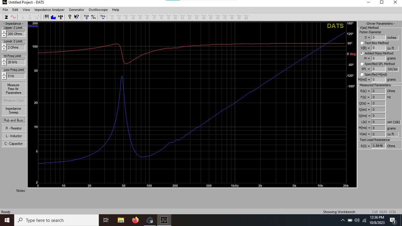

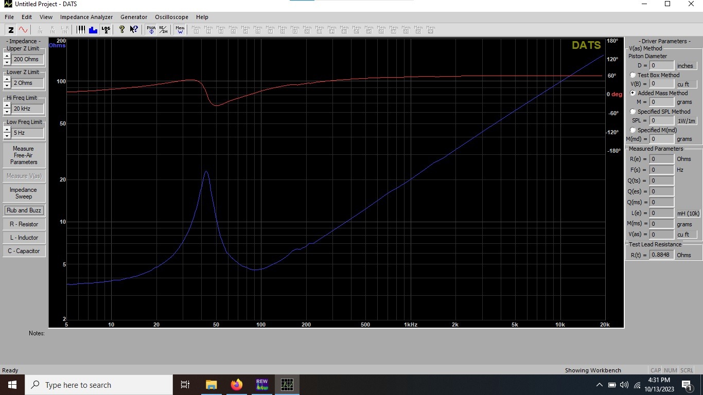

Hrm, Ok, let's see if any of this makes sense then.
Here's the unstuffed impedance measurement:
Here's the same thing, but with stuffing (about 1lb per ft^3) in the sealed enclosure.
The impedance spike shifted left from about 48hz to closer to 42hz and the impedance itself went from close to 43ohm down to 23ohm or so.
Simulated values:
The enclosure's net internal volume is around 7.870 ft^3.
Qtc before stuffing was around 0.834.
Fsc: 44.69hz
Driver T&S for discussion:
Please note, I'm using four of these drivers in the above configuration (wired series-parallel, final 4ohm load).

Maybe this is complicating it? I'm just trying to understand a little more about how this worked out. Perhaps the 4 drivers wired together in series-parallel is throwing off my numbers expected?
When I do the calc based on the modeled numbers, they don't land on what I simulated.
And I'm not sure how to incorporate the post-stuffing impedance information to see how it changed in the calculations.

The two look closer to 41 and 48??Fsc: 44.69hz
The two look closer to 41 AND 48??
Yea, the Fsc 44.69hz was the simulation value.
The 41hz and 48hz were my measurements.
Just trying to see what else I can figure and calculate to know more about how things shifted, and how it compares to a model, etc. Mainly trying to see what changed with the stuffing that I can use to then compare to modeling or explain a change.
Very best,
That much we know. I'm trying to understand the discrepancies as this is needed before moving forward. Fs, Qt or Vas may not be as published, etc..
If published Qts is correct then 48/(0.834/0.57) suggests Fs was 32.8 ..This puts the new Qtc at 0.71

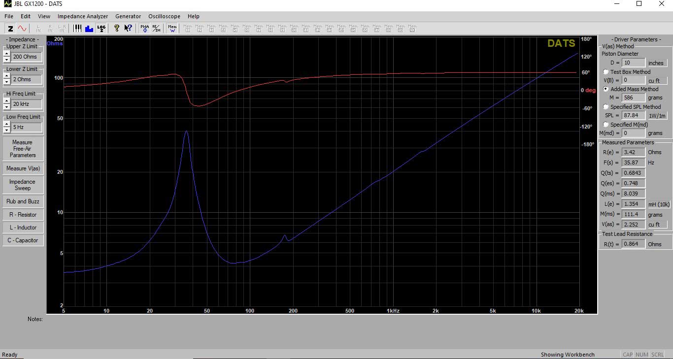

Here's my DATSV3 on one of the drivers. Again, the above measurements were 4 of these together in series-parallel.
Here's just one (free air, no enclosure):
Suggests:
Fs 35.87hz
Qts 0.6843
Qes 0.748
Qms 8.039
Vas 2.252 ft^3
So then, Fc=Qtc/Qt*Fs: 44.69hz = 0.834 / (0.6843 * 35.87). Or if we assume Qtc is not correct, we re-calc for it:
44.69hz = X / (24.5)
X = 1094
I'm confused. LOL

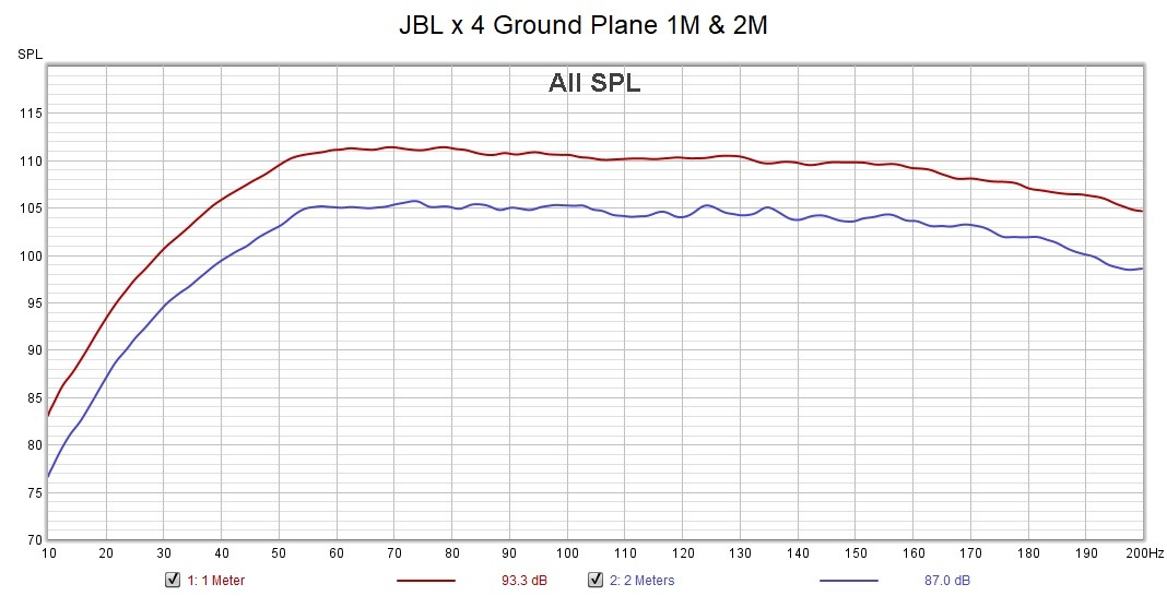

I did some pre-stuffing ground plane measurements of 4 of the drivers in a sealed 7.87 ft^3 enclosure at 1 meter & 2 meter:
Very best,
