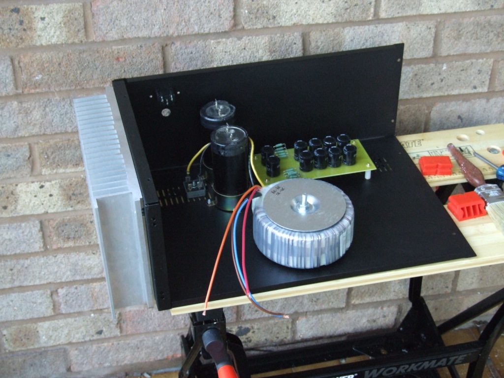

Does anyone have the F5 schematic with the correct measured voltages around the circuit.
I got a little puff of magic smoke out of mine when I first turned it on.
The supply rails are OK, there is no measured output voltage but the initial bias is very high.
Well, I've just turned both P1 and P2 to ZERO and thought I'd give it a go.
V(R11) and V(R12) are both 0V and output offset is 0V.
Good sign that output devices are not short.
Gently varying P1 I can get the bias up to 0.6V/0.47R = 1.27A with the output offset climbing gently but being held in check with small adjustments on P2.
So I've got 1.27A bias and 0.2mV offset.
I think I might have been lucky. Tomorrow I'll need to let it settle and warm up.
In the 5 minutes that I was playing with it, the heatsink didn't even get above cold.
