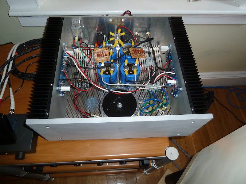

Finally got mine up and running. It sounds pretty good so far but I have not sat down and really listened yet. I will rebias in a week. I do have a very slight buzz that is equal in both channels. I may see if lifting the power gnd from earth will help. I will also attempt to clean up the rats nest. Other then that I am pretty happy!
Whoo Hoo!!! Hooray! And a very sincere congratulations!
Do you have any photos? We would love to see it!

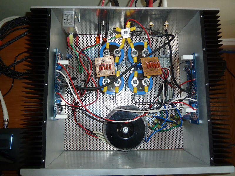

Well First of all what board are you using? I'm using a Peter Daniel's board.
Basically I took the RCA ground, (right from the RCA jack) and connected them together, and from there, I connected those to the Power ground. I did not run an extra ground from the amp board at all. I let the RCA ground that connects to the amp board run towards the RCA jack. That removed all hum whatsoever.
I hope that makes sense.
Ahh I see, attach the shield only at the RCA side. and remove the white ground from the board. Connect the RCA grounds together right at the pins and put a wire from the middle back to the star ground there. That should solve the hum.
I had the same problem until I did that.
I circled what I did (its the white wire) I should have put the ground in the middle, but oh well.. (please ignore the mess of the extra caps.... )
