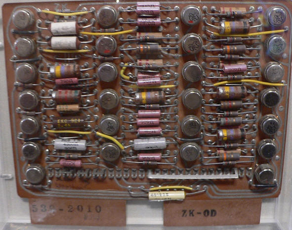

FWIW when I was young, transistors were relatively expensive (that should give you some hint about the Geological era involved ) so we young experimenters, permanently short of funds, sometimes used a similar method to get tons of (experimenter's grade) transistors for, literally, peanuts, the infamous "burn and slap" .
There was this Surplus guy who sold Elctronics, including tons of Military equipment, by the kilo.
So we went and bought an IBM mainframe computer board
in fact some 8X larger than this one for a couple bucks, covered the kitchen table with newspaper, melted solder with a propane torch and slapped the board hard against the table.
What's amazing is that practically all transistors still worked after that
Won't comment on the joy of Sherman tank (WW2) radio transceivers, pilot rescue crank operated radio transmitters (complete with (rotten) balloon and Helium bottle to inflate it), Lancaster bomber radio direction finders, Radar PPI displays (source of cathode ray tubes for homemade oscilloscopes) and other beauties.
