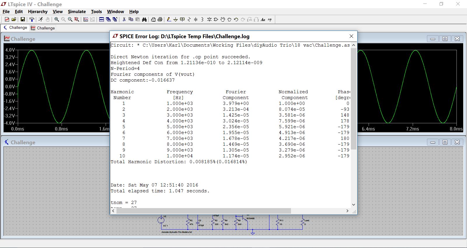

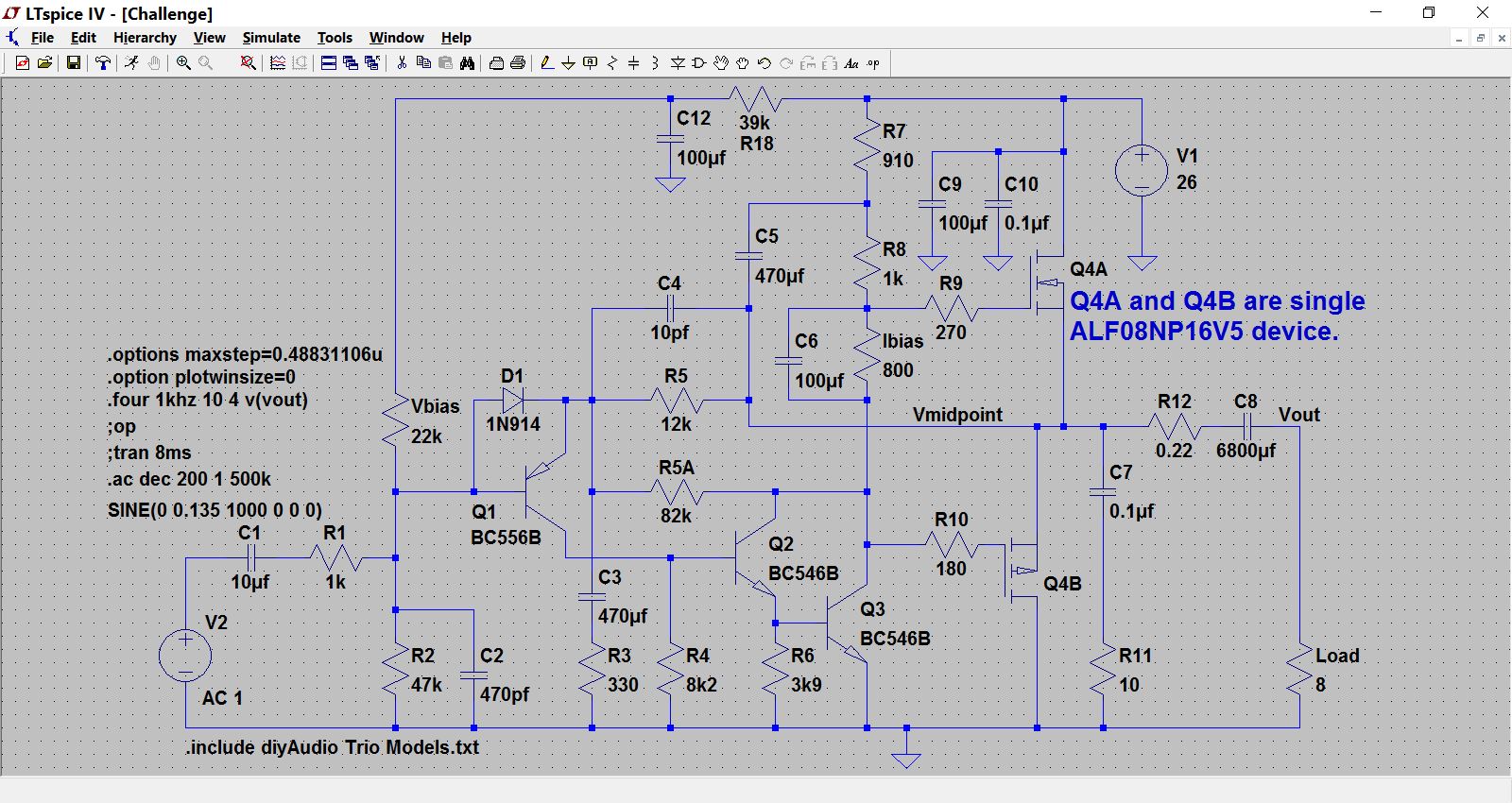

With FET's... or rather just the one 😉
Q2 and Q3 can be a single darlington (hence the name diyAudio Trio) but its much much better with a discrete two transistor arrangement. The output FET (just the one) is a unique single device containg an N and P channel FET.
So that's my idea for a simple low component count discrete design.

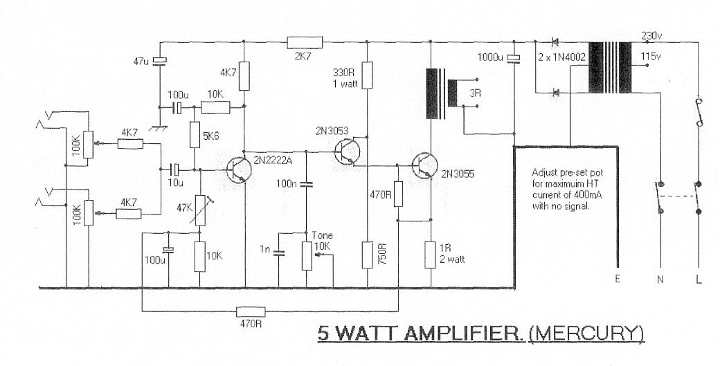

Some ideas from the past.
Now we are talking!

More to show how the cat was skinned before.
Took me a while to understand that remark!🙂More to show how the cat was skinned before.
Anyway, the Red circuits 10watt amplifier is closer to what i am after, but maybe it is a little less minimalistic (aka more complex than i dream).
