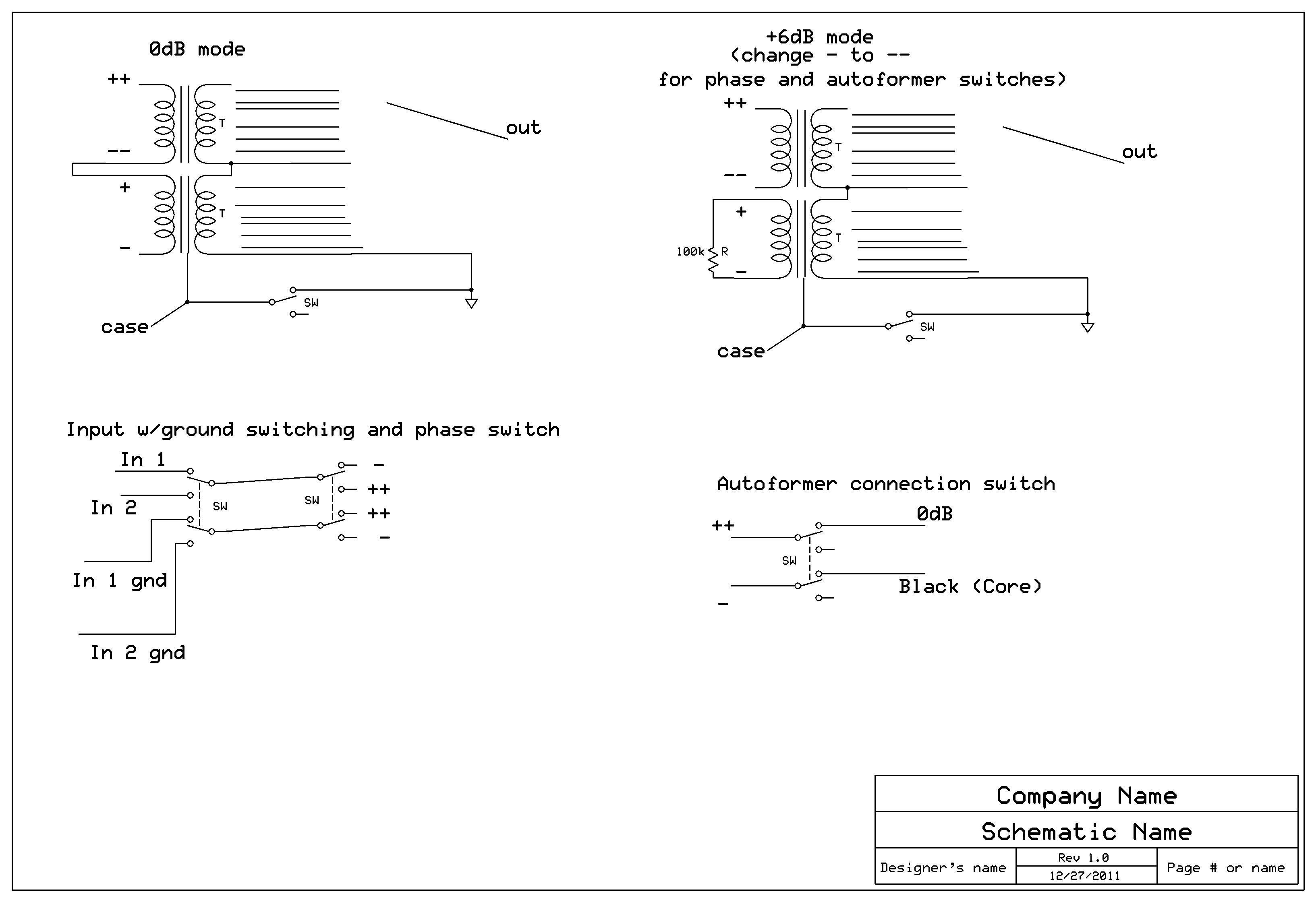

Seems to me that would be like joining the transformers to create a centre tap.
Can't quite visualise that Jon. One wire on the input winding will be connected to the common input ground and the ++ wire is switched between my two inputs. The -- and + wires are connected together as I don;t need the 6db extra gain. I don't understand how that would make a centre tap.
Sorry, I'm on the wrong side of the transformer!! 🙄 Input ground is common, and IIRC, this is how I ran my source switch.

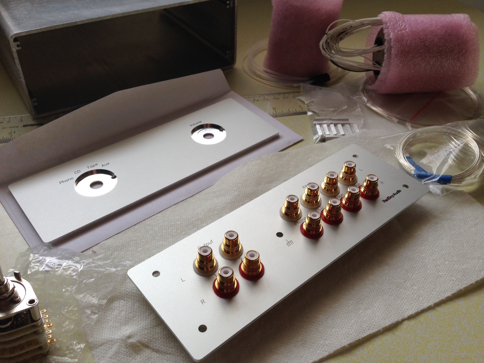

Finally got it all rehoused and wired up. I had forgotten how good; natural; detailed and dynamic these thing sound. Shame they no longer support the diy market.
Nice one!! Any chance of a pic?
I'll try and post in the next couple of days.

I just picked up a TX102 preamp someone made by DIY a few years ago. I think it might use the Mk2 TX102 transformer as the treble sounds a bit over smooth, - as someone else commented here compared to the other MK1 and MK3 version. I want to try to address this by running in AVC "Autoformer mode", which I read might give some potential for for giving more treble sparkle.
Wanted to ask (sorry if this is a stupid question). Is it only possible to run the AVC mode when using 0db operation, not 6db? I think that's the case, but just wanted to confirm.
My preamp is currently wired for 6db, so I will try 0db and AVC mode.
I know AVC mode involves connecting the ++ lead to RCA hot and also to the 0dB output lead, but do you need to make any other changes (perhaps to earthing or the cold part of the signal etc), or it that it?

Colin, BTW I'm sure I have mkII's. I don't have ++ or --, there's a single primary 0+ and - with a +6 output option for 6db of gain. Is this how your's is marked?
Hi there,
That's interesting. I might have jumped to conclusions about my trannies being mk2 based on the over smooth treble. I have two primaries. Marked + and - wires for one, and ++ and -- for the other. Right now only one primary is used, the + and - side hence its must be 6db mode. If your single primary txs are typical of the mk2 then perhaps I have a different version. Shame there are no markings or labels on the casing to know for sure.
