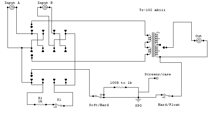

Phase switching input
Hey,
I've been toying with switching phase on the input switch of a TVC without tying all the input grounds together.
Below is a sad representation of what I'm trying to do. The mess on the left side represents the input selector rotory switch(no rotory switches on my copy of circuitmaker!!); 3 pole, 4 throw and as represented the three switches would move left/right as one unit(one channel). As connected would allow switching of input phase.
The bottom row of switches just allows the signal negative from the inputs to go to the "ground" part of the preamp regardless of the phase. Is this a good idea??
R1/S1 is just an option to tie the input grounds together in the event that switching inputs causes a "thump" due to different ground potientials of the source units.
The other switches are for Hard/Soft grounding of the inputs and Hard/Float of the output.
Seems to me there would be no problem with this arrangement if the output ground is "floating". But, will there be problems if both input and output are hard grounded?
The funky looking "variable transformer" on the right represents the Tx-102 and the volume control.

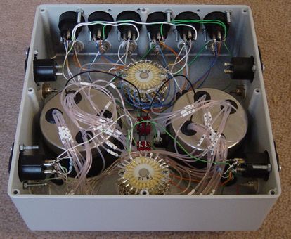

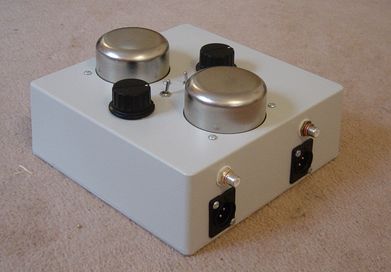

mikelm said:...and a look inside
the small size made wiring a bit more fiddly but I do like the 'cute' look
How much did a pair of those transformers cost ?
about £300 plus tax

TX102 Mk3
quite expensive but better that most.
any reports you may hear that the treble is too smooth may be reffering to TX102 mk2. To my ears the treble with the mk3's is excellent ( I have tried both )

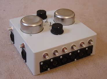

UCD400 integrated with TX-102s
I just finished this integrated up earlier this Thursday night. It has totally blown me away with how clean it is. After its been running a while if I pause the sources and crank it all the way up I can only just barely hear the hiss. Its easily the quietest system I've heard so far.
Notice that I said after its warmed up. For some reason the right channel makes a gound hum/buzz for about three minutes of music before lapsing into almost total silence. Right now the inputs are hard grounded. I had originally wired up a lift switch, but I thought maybe I was picking up noise from the amp transformer so I pulled it out.
I'd think it was just grounding problems, but the fact it totally goes away has me very confused.
I also am worried I did something dumb when I wired it together. I went ahead and wired both the volume and input selector switches to the TX102s before I wired up the input jacks. I used my meter to tone out the positive and negative because the wire was enameled and braided (2+2) so I couldn't tell them apart. Without thinking I toned out the active selection so I'm worried that my meter could have dumped DC into the transformers. What would the symptoms of a magnetized TX102 be? Could that explain startup humming?
Any other ideas for this mysterious disappearing hum?

Ooops my bad, nothing to do with TX102s
I rewired the amp portion when I did the preamp part the other day. When I first got the amp parts I noticed that /ON wire in the hypex molex kk connector was loose. I had carefully pushed it in before and gotten a good connection. Unfortunately this next time I had accidentally pushed it below the connector and it was touching the signal- pin too. /ON is connected to the power supply ground so I was shorting the signal- on the floating balanced signal from the TX102s to the UCD400s. I just fixed the wire connector and its clean now.

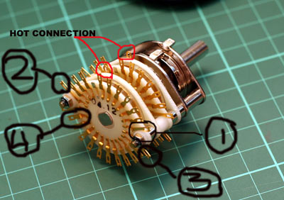

Help a Novice
Hello,
I am a novice.
Already have the S&B Tx + Selden rotary switch and parts.
Will only use only a RCA In / Out Configuration
Now I am a bit foxed by the Selden Rotary Switch, It came with no schematics and I am figuring the Hot switch will be as marked and the Ground should be the '0' switch, However which is the zero(mute) switch?
Kindly check my jpeg and help me confirm if the Hot is as overmarked, adn which is the Mute point.

It's a trivial issue. Just look through the transparent window and you'll see the pins for GND-Mute (extreme anti-clockwise position of wiper) and Max (extreme clockwise). I've used the same switch as yours and it was really quite obvious.
Hi all, I bought a pair of 102's recently and have had them rigged up on the test bench sounding pretty good. I decided to wire it all up yesterday like so.
Transformer + and -- together
RCA input Hot to ++ of transformer
RCA Ground to - of transformer
numbered outs of transformer to 24 way switch
Output pin of switch to pin 2 of XLR
xlr pin 1 to ground
pink wire from transformers to ground
black/white wires from transformer (unlabled) to ground.
This produced hum so I grounded the RCA cold to the same ground point.
Now the issue is that it appears to be in mono, disconnecting one chanel at the input still plays through both amps. The only place I can see the two channles being connected is at earth, is this where my problem lies you think?
Should I try a seperate earth? Have I made an obvious error?
