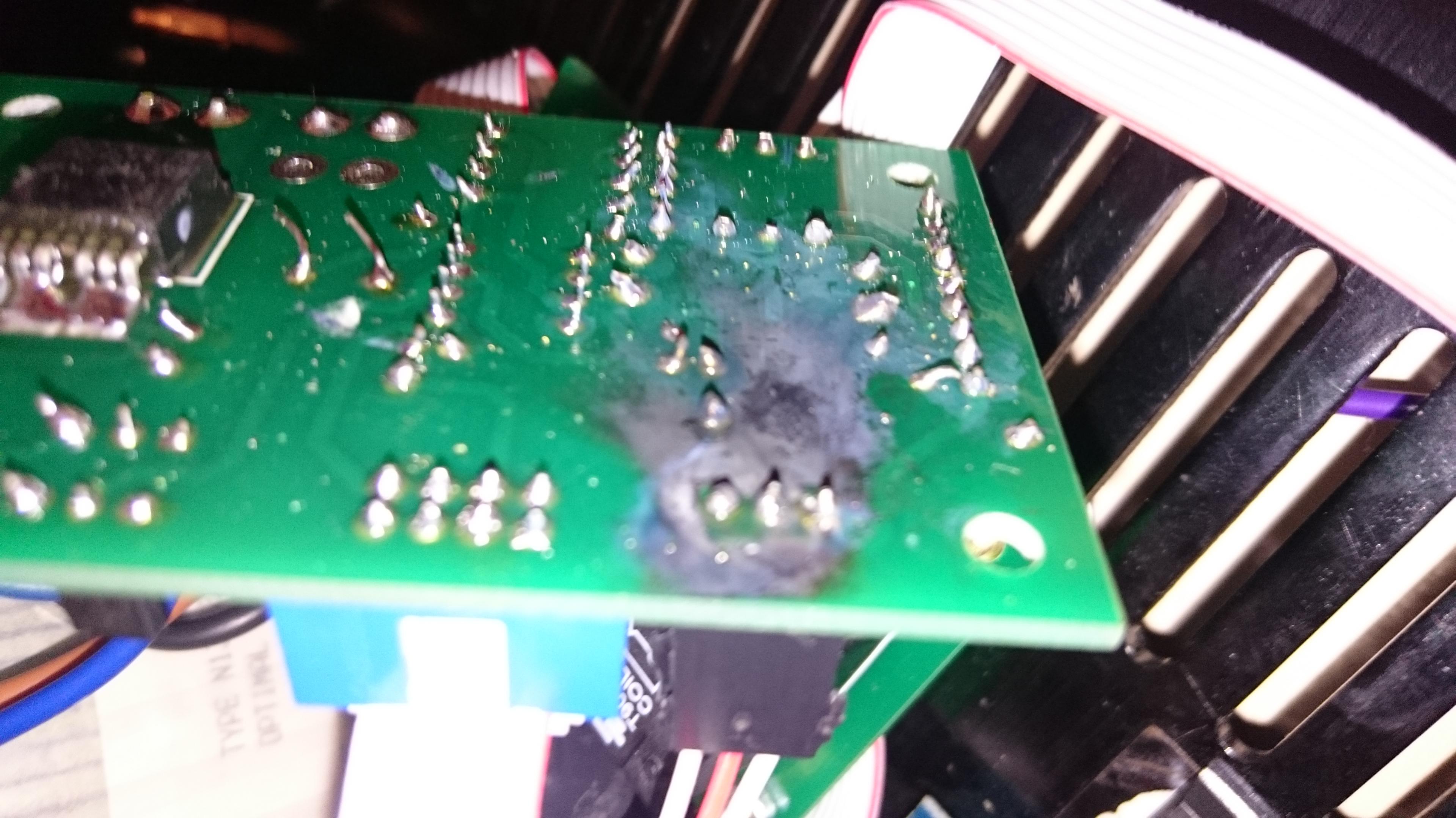

Shorting rail to ground would definitely look pretty exciting, but unless it blew a trace off the board it's unlikely to hurt anything.
Something seems to be limiting base current on Q9. It should be around 125 x gain at that collector current, so it's going to need .1mA base current at least to operate U2. Can you measure the voltage on J3, pin 3 or 4 to digital ground and U1, pin 6 to digital ground? Let's verify the control board is signalling with a good 5V and the optoisolator is turning completely on.
II did the same thing on one of my speaker protect boards. Measuring the rails from the solder side of the board. My wife came in and asked me something. I looked up to answer, the probes slipped and there was big boom and sparks.
Then I had to explain that the hobby is perfectly safe, I have full control and my amps won't catch fire and that this very board is meant to protect them from catching fire. 😛
Everything worked fine after this accident. 😉
