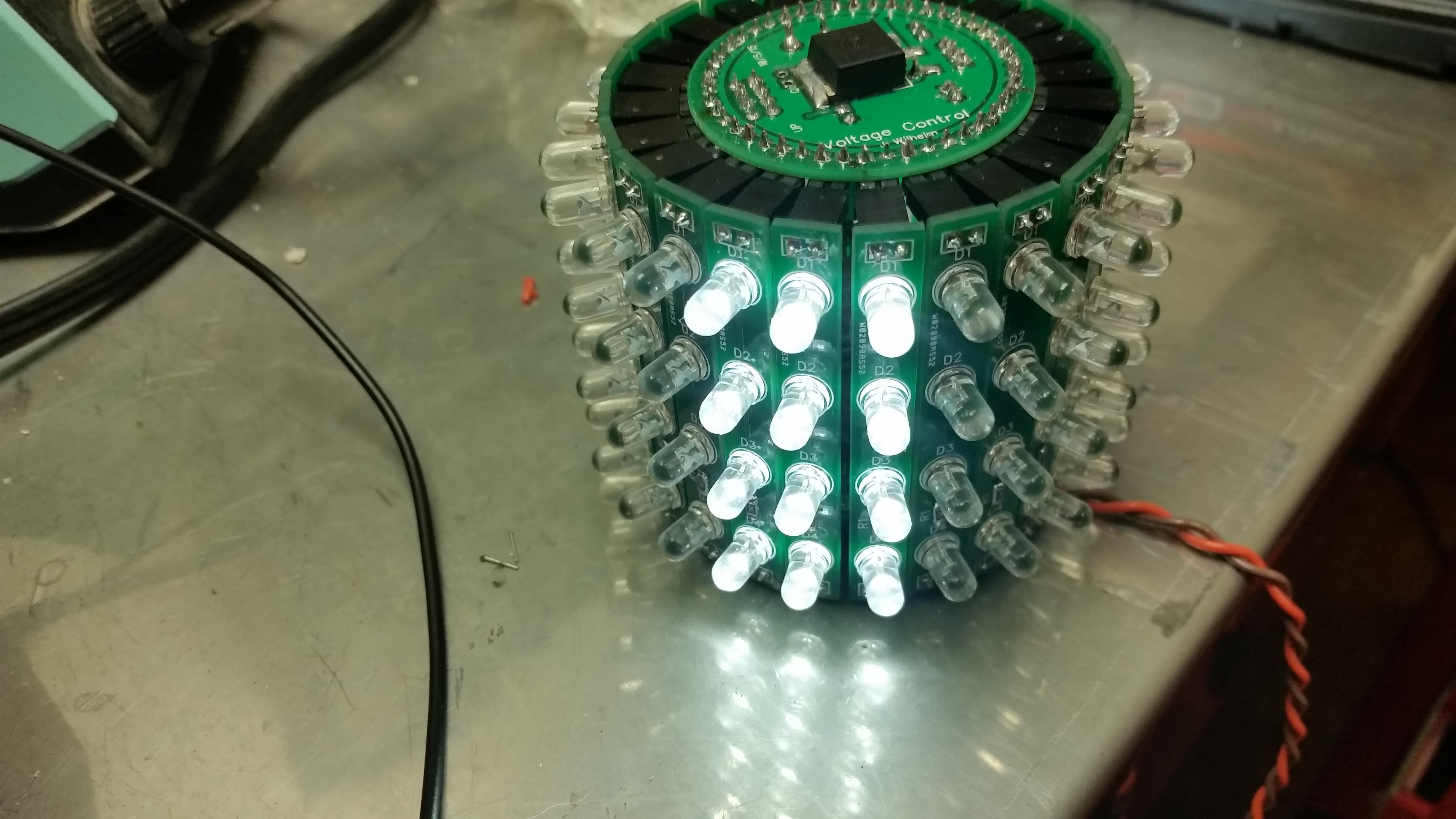

I've been finding a lot of uses for the Arduino platform. Hopefully in a couple months I'll have software writing down. It's starting to get easier. Here's a lighthouse beacon I've been building for a guys cottage. Remote control rotation speed, brightness and output pattern selection.

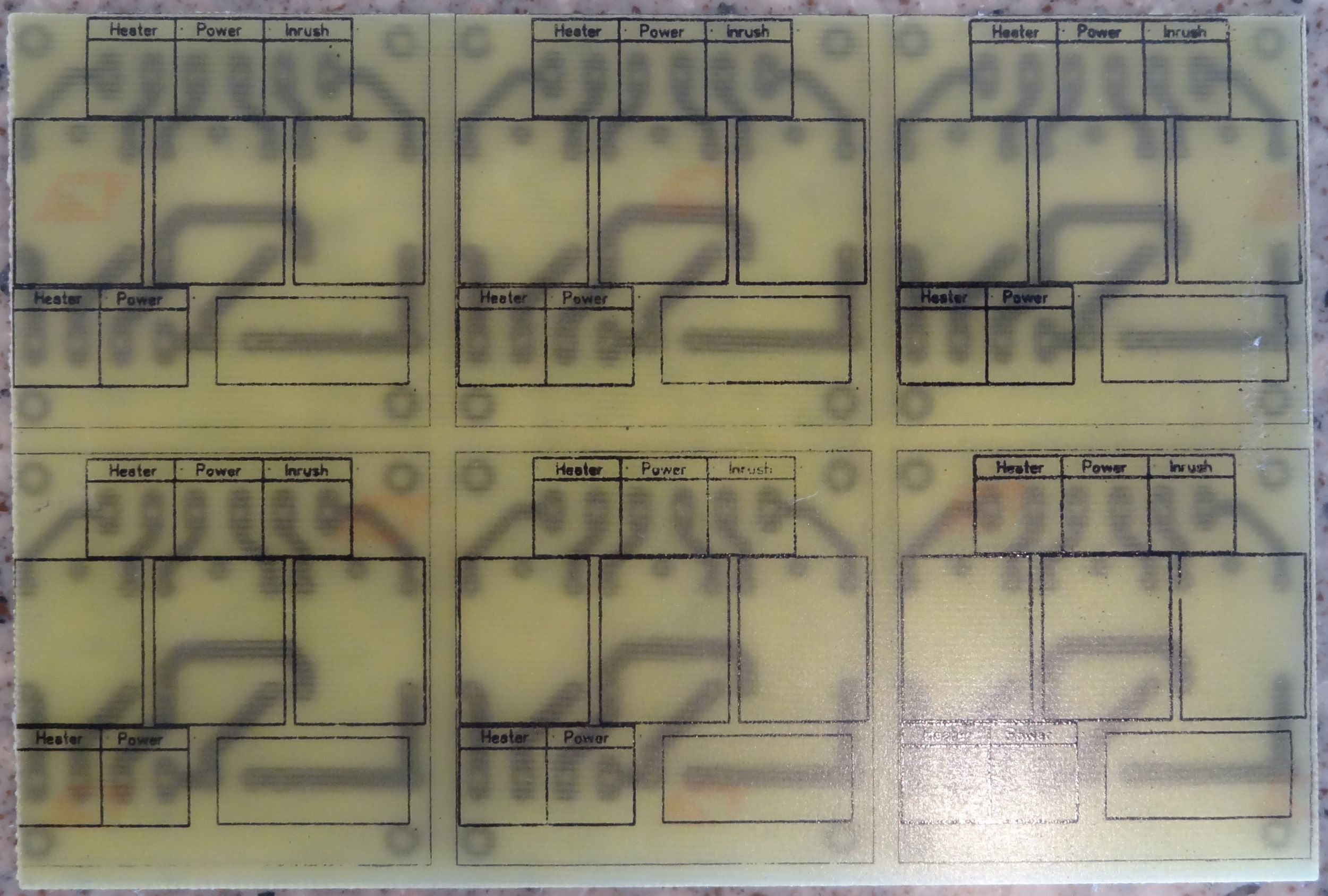

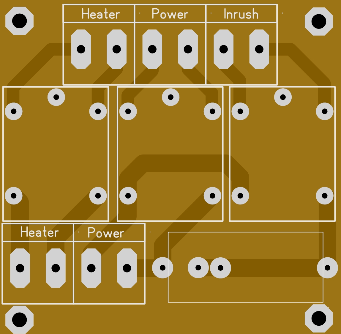

Here is a board for use with those relays.
How fast does it reacts in case of a short circuit?
Way faster than a 10A fuse will blow.

Relays should be ok.
800VA/220V=3.6 amps divide by .8 fpr power factor and double it for safety at switch on, gives you 9 amps.

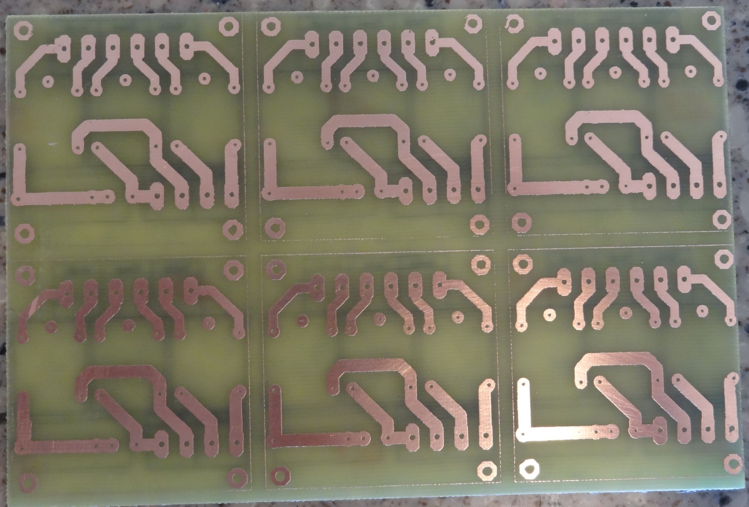

Shouldn't be too tough to do on a vero-board. I could also provide gerbers if someone wants to order some. Should be very inexpensive.
The control board is 77 x 97mm. I haven't put any thought into a group buy. Gerbers are always available, and I usually have a couple left over test boards with minor errors to work around.

The board or 48mm x 48.5mm.
we could fit 4 of them on one 10cm x 10cm board and get in under the prototype discount. I'm not sure what they charge for score lines but that would be a really cheap way to do it. I was able to put 6 of them on a 4" X 6" board. These should work well in a tight chassis when using a reasonable sized PSU.
