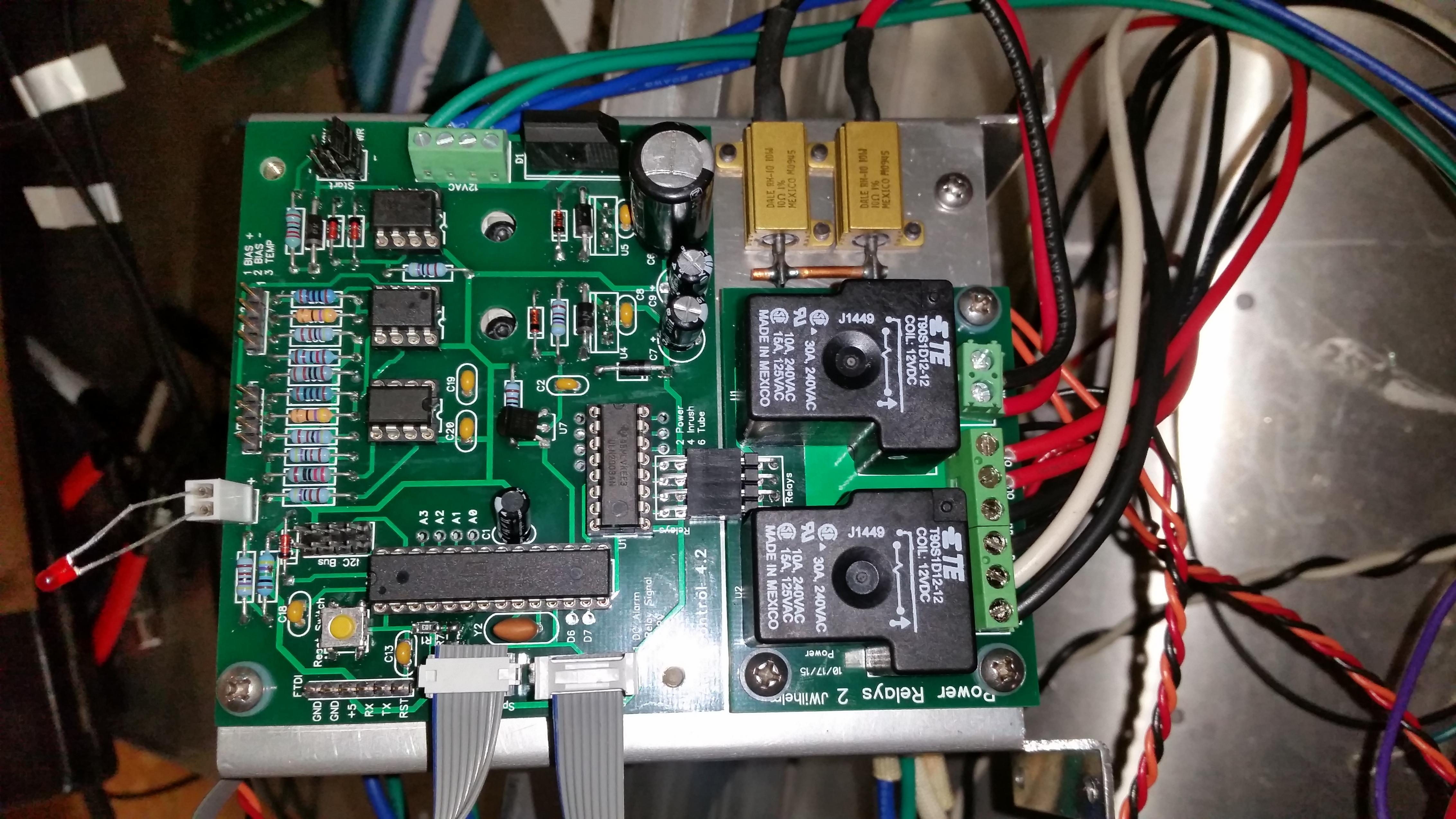

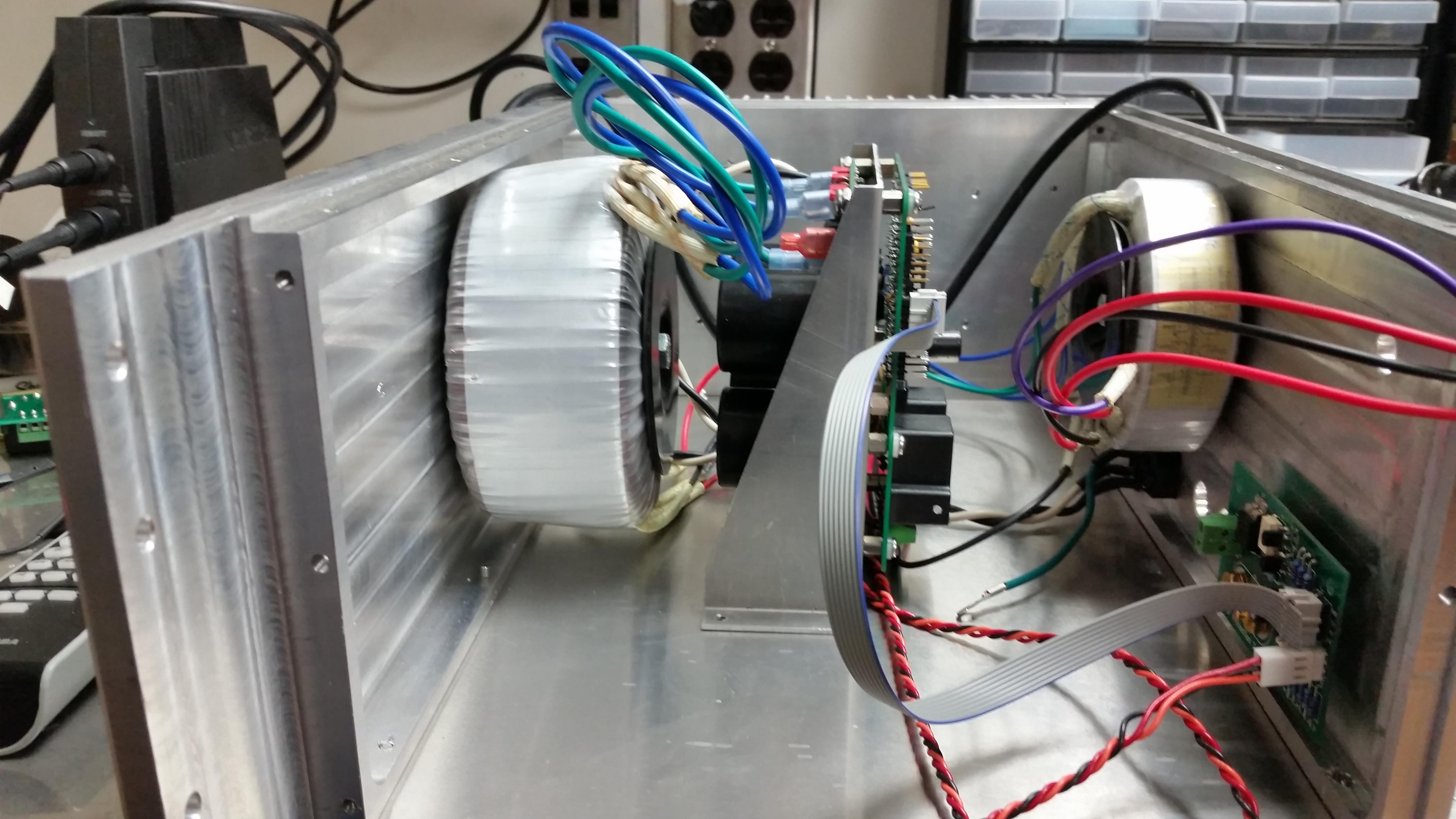

This is all mounted vertically on the backside of one of OS's modular power supply. the control board is 77 x 97mm. Terry's NTC resistor would make it neater still.

I ordered the transformer that fits this board but looking at it it appears that it will block the mini usb plug. How do you get to it to if you need to reprogram the board?

The Nano is meant to be mounted in a socket. You pull it out of circuit for programming.
I didn't get the memo. 🙁 I soldered in the nano. Too much trouble to unsolder now. I guess I'll just use a different transformer.
If you have the space, you can mount the transformer under the board and use long standoffs, or another transformer.
I have another transformer hooked up. It is 14-0vac. Seems to be working fine. The board powers up. Both LED's light. The board LED starts to blink after a while. When it powers up I read 12Vdc across the heater lugs but nothing across the inrush or power lugs. If I measure from the center pin of the RailSense terminal, I get 12Vdc at all three + terminalsl but the - sides seem to be open on the inrush and power. is the negative terminal the side that gets switched?

Yes relay switching is done on the negative side. The heater relay should become live immediately, then the inrush 30 seconds later, followed by the power relay. 3 seconds after that it should shut down and flash the led because there is no rail voltage.
Wow, 30 seconds before the inrush starts? I would think the heater would be full strength earlier than that. I'll hook up a PSU and see it it will finish.

Timing can be adjusted easily in the software, but TubSomo took almost that long to warm the tube up.
