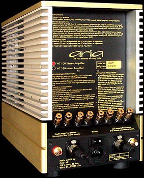

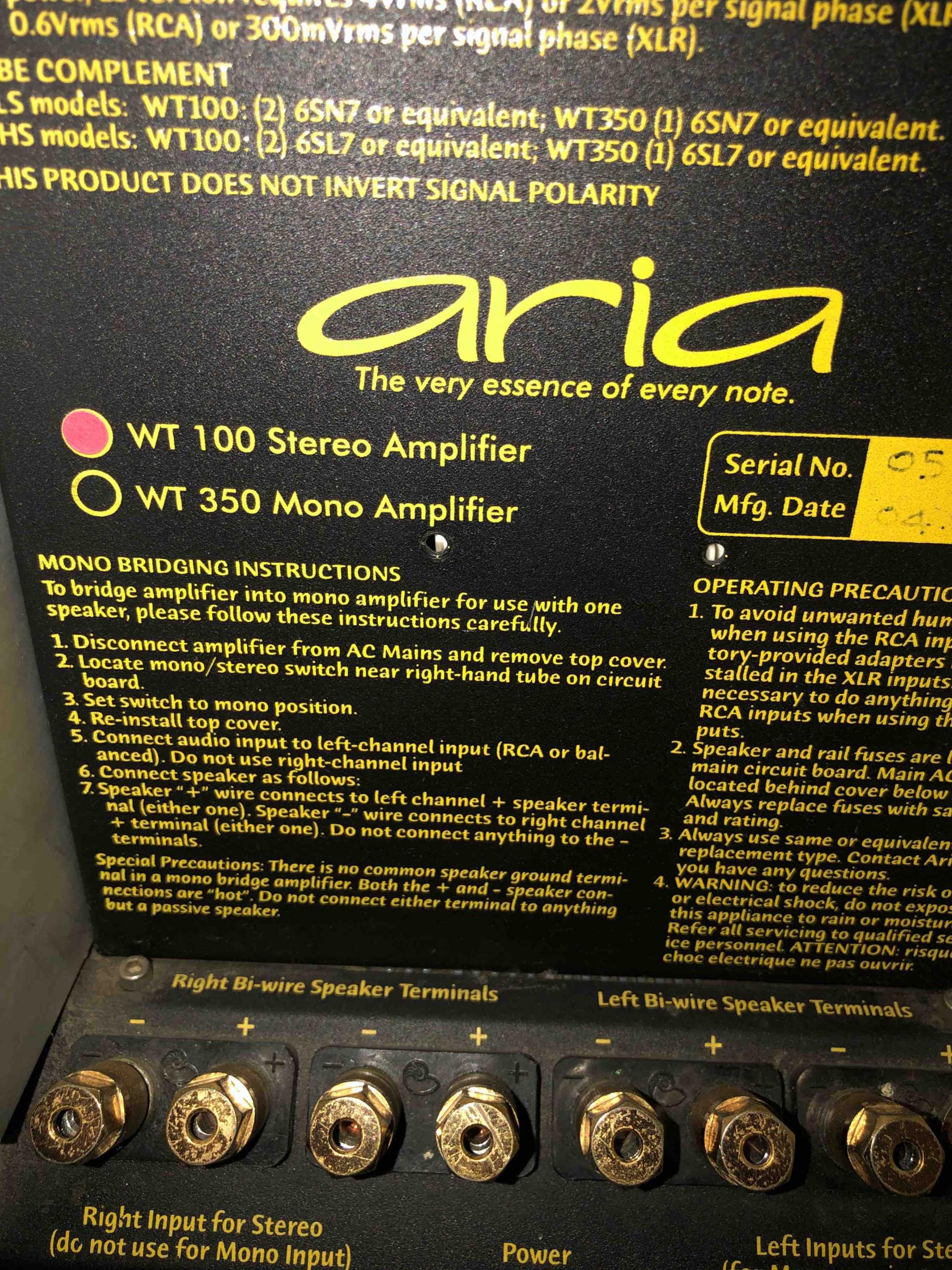

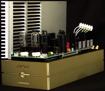

The epoxy filled tops were supposed to stop high frequency ringing but every other amp after this series didn’t include this mod.
The input cap should be a Sideral 4.0 mf as that was what he used towards the end of this series
The DCO is typical but know this amp is at least 35 years old and the PS caps should be changed out as usual
Matching input transistors will bring down DCO noticeably
I have a dual mono unit ( 2 trans ) that was modded at his shop when he was in
Paramount ,CA but one side needs work and haven’t used it in years

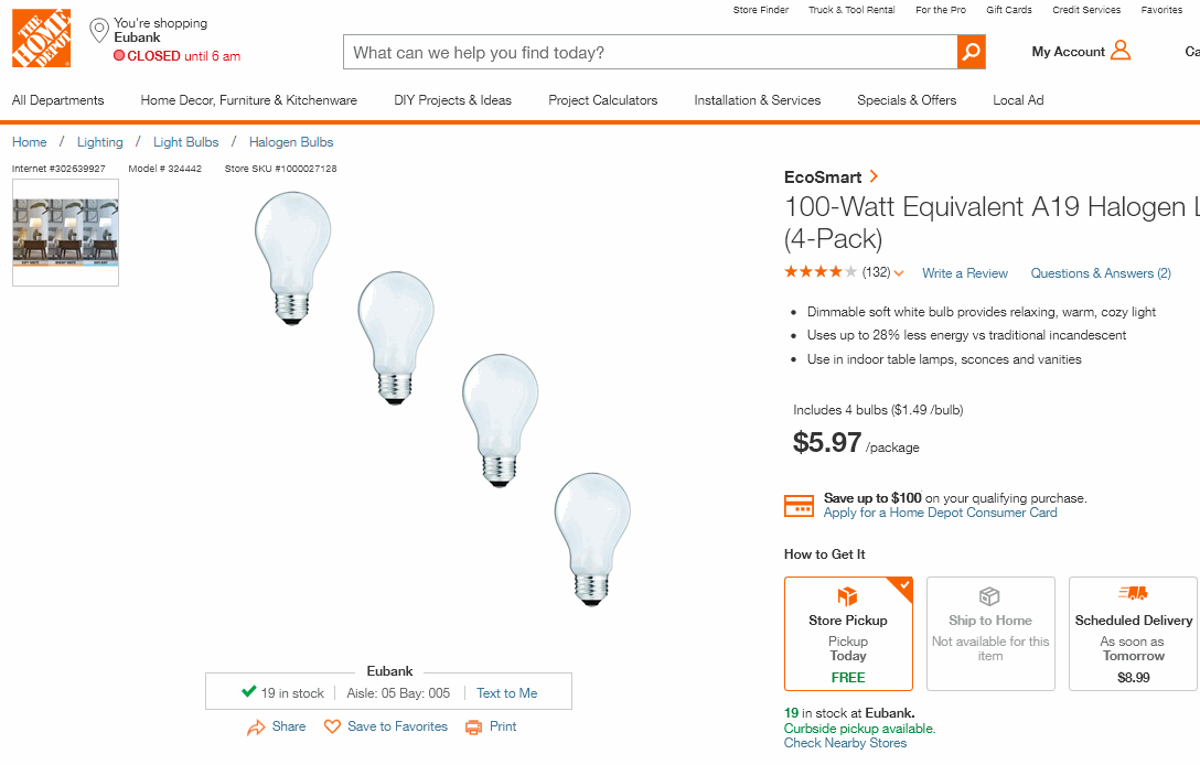

My problem with the DBT is that I cannot find any incandescent lamps in the stores. .
"Halogen" is same-as for this purpose.
The Eubank Albuquerque Home Depot has nineteen 4-four-packs of 100W equiv (72W actual) in aisle 5 bay 5.

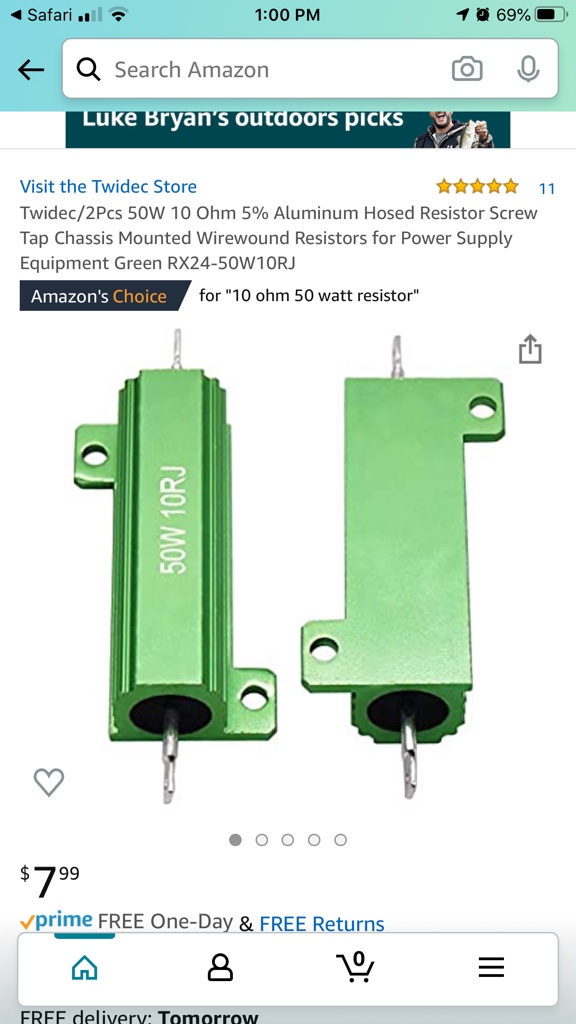

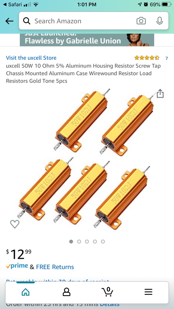

Just for my understanding, how did you come up with 10ohm power resistor ?
Remember this is a hybrid power amp
Tubes for the input and solid state for the power output . If that makes any difference
Sometimes a solid state amp will be ok without a load, sometimes not.
I don't recommend those resistors, which are a regular resistor in a metal case.
They must be bolted to a large heat sink to dissipate much power.
Without a heat sink they might be good for 5W-10W each.
Some of these in series-parallel to increase their power rating would be fine.
Dayton Audio DNR-10 10 Ohm 10W Precision Audio Grade Resistor
I made up what Rayma comments on but genuine steel cased Dale (Vishay and others ) with the full manufacturing coding /value etc .
I took them from a major electronic communications companies scrap PCB,s the 10W resistors are only half the size of the ones shown but did not overheat on a 50W heat-sink.
I am very dubious about the ones shown as no genuine information is imprinted on them only the value and even then the print on mine is fine not looking as if its stamped on .
