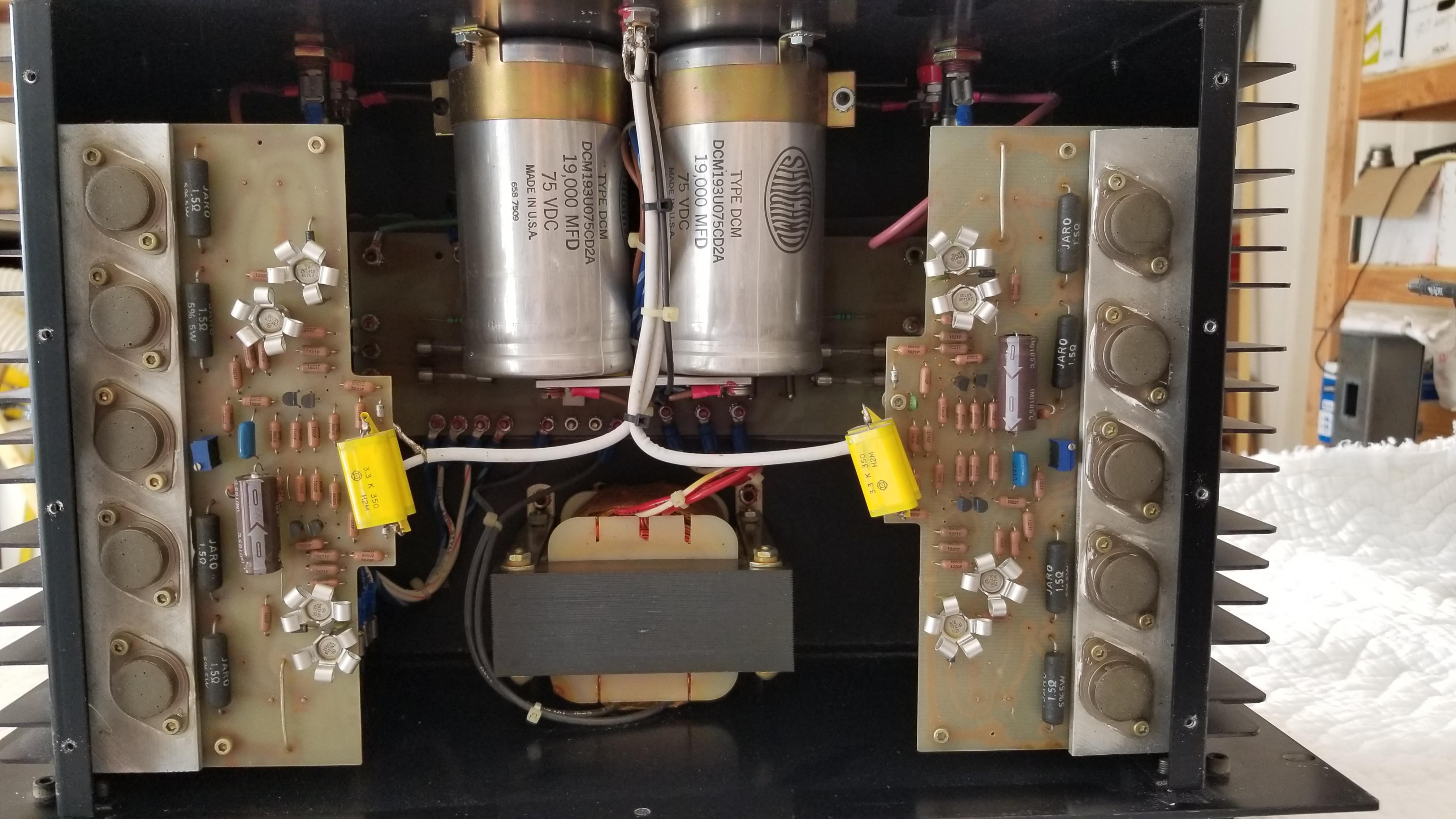

How to bring up new old amp with Variac and DBT
All the TO3,s are MJ15024
The epoxy filled tops were supposed to stop high frequency ringing but every other amp after this series didn’t include this mod.
The input cap should be a Sideral 4.0 mf as that was what he used towards the end of this series
The DCO is typical but know this amp is at least 35 years old and the PS caps should be changed out as usual
Matching input transistors will bring down DCO noticeably
I have a dual mono unit ( 2 trans ) that was modded at his shop when he was in
Paramount ,CA but one side needs work and haven’t used it in years
Bedinis drive electrostatics very well BTW
Regards
David

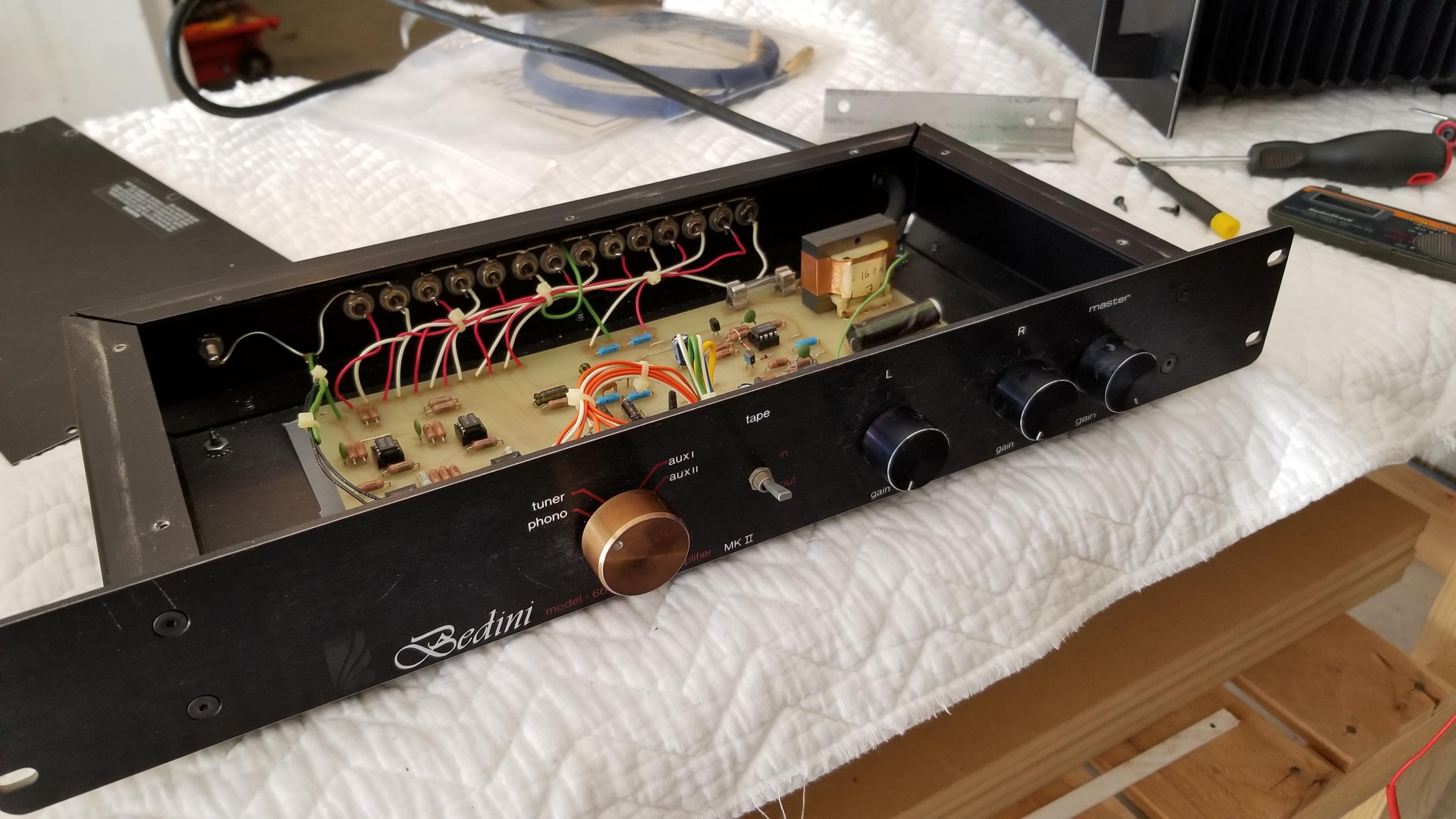

It is the preamp. I fired up the system this morning and got the normal hum and wondered if I would get the same with other inputs. This is without anything plugged into those inputs. Every input has it's own strange noise and volume level and when I flipped the Tape In toggle switch all the inputs went down by 20db or so. This is not a hotshot, cool cat-daddy, top of the line preamp so it goes on the shelve.
