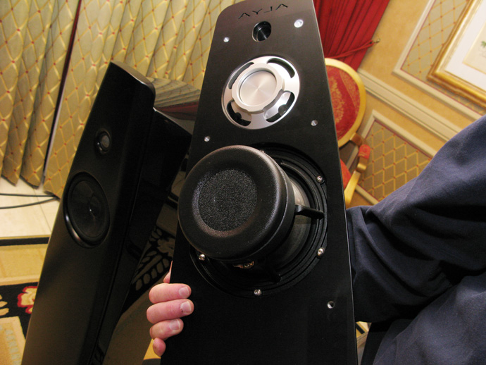

I have still the feeling that the vibrations of other panels than the front baffle should not be that impacting in the soundstage performance of the speaker.
They are extremely lower compared to the front emission.
Instead i think the "main suspect" is the front baffle.
A thick baffle (or maybe stiffened ?) could be a good point to start.
I am still confused because i see front panel only stiff and not that heavy.
Let's say that i see front baffle realized in very different way.
Some examples here under taken from good commercial speakers.
Thanks again, gino
ginetto61 said:I am still confused because i see front panel only stiff and not that heavy.
It's not just you being confused, but a an indicator that many designers even in the "commercial sector" are confused too ...
Many speaker's cabinets try to fight with physics in a ridicoulus way instead of making use of it.
In a wideband cabinet (not just a subwoofer) dominating mass and damping is needed.
Decoupling the driver - by mounting it via a damped kind of spring to the cabinet - may reduce excitation of the cabinet from e.g. 6dB/octave to even 12db/octave.
Decoupling is equivalent to inserting a higher order lowpass filter mechanically between the exiter (driver's basket) an the cabinet (=structure able to vibrate and radiate unwanted sound).
Thus decoupling in a wideband used enclosure (e.g. a 2-way) is an economic solution to reduce unwanted sound radiation especially in the midrange. See attached example below.
In a subwoofer decoupling is both impractical and unecessary, given the cabinet is designed for dominating stiffness.

Okey, then I guess you will be dissapointed to see they decouple both the midrange and tweeter.
And the designers of the Nautilus that now designs Vivid audio, also do the same. They do it for the bass driver aswell actually.
SoundStage! Ultra | SoundStageUltra.com (UltraAudio.com) | Searching for the Extreme: Laurence Dickie of Vivid Audio -- Part Two
A difference so small that it is within the measurement error of hobbyist like us do not worry me at all.
Especially when you see how much better behaved both the chassis and panels are in Andrew's example. Like it was said, it's probably the most cost effective way to lower cabinet ressonance.

Okey, then I guess you will be dissapointed to see they decouple both the midrange and tweeter....
Thanks a lot for the extremely interesting link (i read great things of Vivid Audio) but this will take me all the weekend to read 😱
