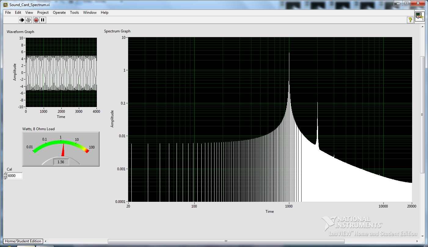

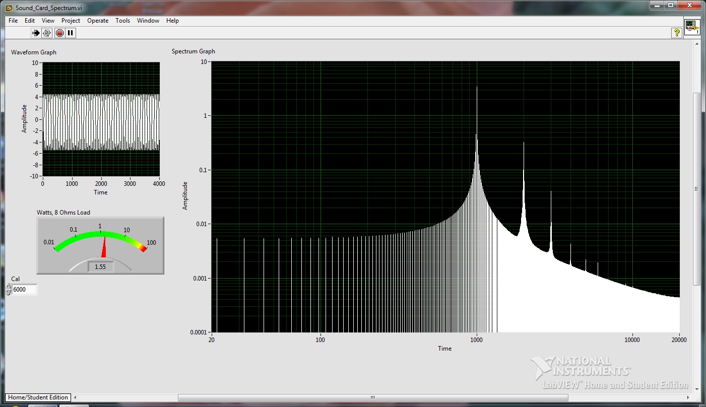

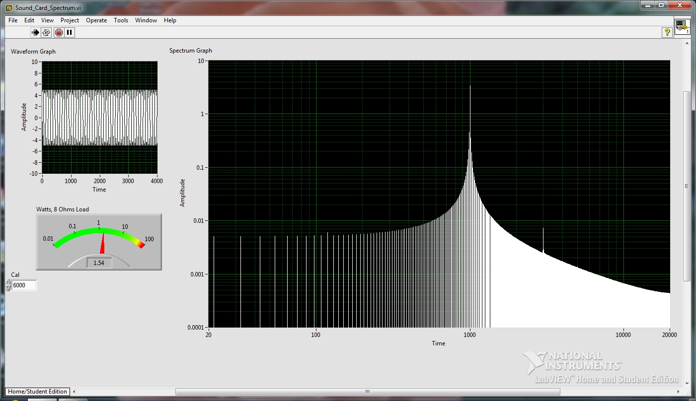

I finally got some analysis of my cathodyne unbalancing potentiometer. 1st frequency plot shows balanced position of the pot - 3rd harmonic is dominant. Second shows unbalanced - 2nd harmonic dominant. Third shows further unbalancing. So I can get 3 different harmonic responses within the pots range.
Screen plots 1 and 2:
Not only is the 2nd harmonic dominant in the unbalanced condition, that 2nd harmonic is Much Larger than the 3rd harmonic was in the balanced condition.
Balanced = Lower THD.
Unbalanced = Higher THD.

So the basic idea is to change the THD character of the amplifier at will. Of course, the perfectly balanced position (2nd harmonic nulled) is best - measurement wise. And - so they say - the predominance of even harmonic distortion gives a desirable sonic character, of course in that "measures lousy, sounds great" phenomena that we all know exists somehow in the realm of amplifiers and speakers.
Can these settings persist with regard to tube ageing, temperature changes and all other considerable factors? I dunno!?
Can one make the sonic character change as a function of frequency, i.e. have a smooth shift from perfectly balanced to unbalanced (rising 2nd harmonic content with frequency)? I bet you can.
Of course, the gain of the amplifier changes as you unbalance the cathodyne - I compensated for that when I made the plots by increasing the drive. The simple unbalancing potentiometer has consequences... But it works.

All I did was replace the 100K plate resistor with a 100K potentiometer. I guess I got lucky that the 2nd harmonic null was within range, i.e. just off the far end stop. With the pot all the way closed (or part way closed), the cathode side of the phase splitter is doing all of the driving to the one output tube remaining fully functional.
