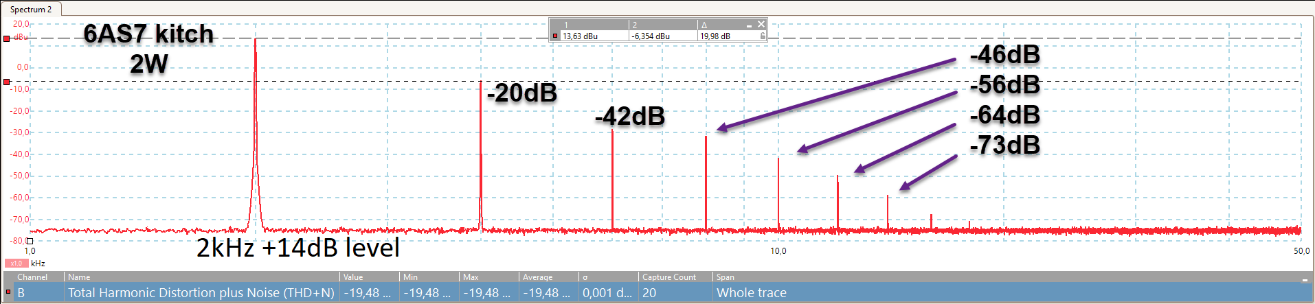

There’s really no such thing as tube sound. Different tube amps distort differently. My 300B amp is SE, and produces primarily 2nd order harmonics. But my PP EL34 amps do not sound significantly different from SS amps for the most part. Then tube amps do not produce square waves when they clip. They still look more like sine waves, and often asymmetrical, which probably contributes to some of the so-called tube sound.
But I would think that the 2nd harmonic and some 3rd harmonic distortion products contribute to most of the signatures that are referred to as tube sound.

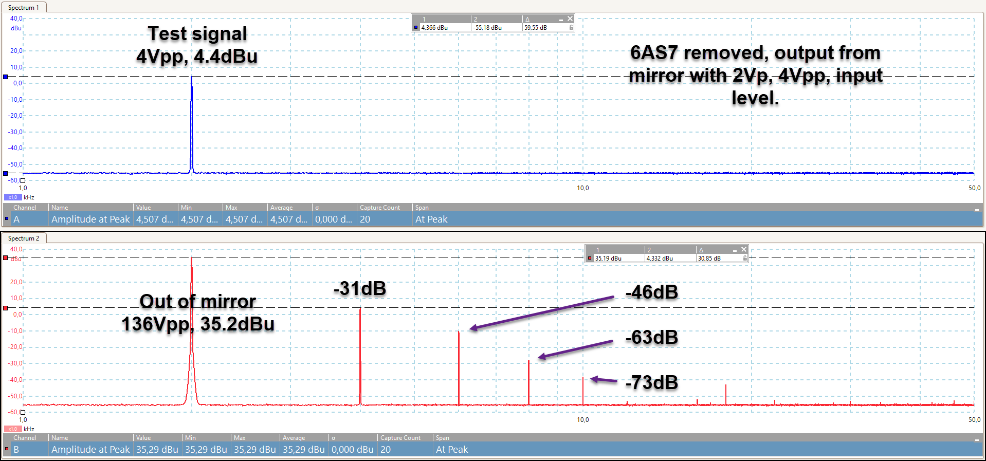

My current main amp is my reserve (kitchen) flea power 6AS7 SE at max 2W output. It has huge amounts of 2nd. Probably -30dB at less than 1W and -20dB at just above 1W. Thats ca 10% 2nd! The higher harmonics are low.
The reason for the huge amounts of 2nd is my current mirrored 6922 prviding the gain and drive. The mirror prduces same phase output so both tubes are driven positive and negative in phase. This does not give the usual cancellation we get when they are not in phase.
This amp sounds so sweet. Yesterday I noticed my teen daughter sitting on the floor between the speakers, eyes closed listening to music. She has asked me before the why she does not listen so much to music at her moms. At their home the stereo is out of sight as in most womens homes.
So there definately is something to the 2nd harmonic. Btw the sound is clear and punchy. I cannot directly hear the 2nd. Just the silkyness in the sound.
Edit: darnit. I just said I do hear it in 'the silkyness in the sound'. Well I am just trying to describe it sounds great. I actually cant hear anything is done to the sound. I contribute the silkyness more to the classA operation than the 2nd harmonic. Anyways. I dont believe anyone listening to the sound will go: oh yeah thats the 2nd I hear right there!'

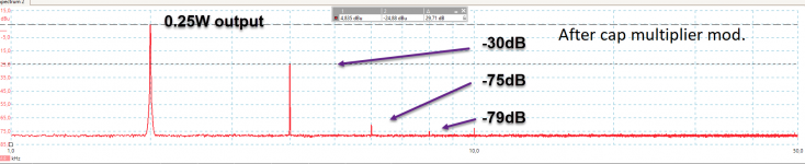

Well here are FFTs of 0.25W and at almost clip 2W. Also include the output of the driver/gain stage, having removed the 6AS7.
Not so much IMD here, but with music I'm sure you are right.
Note that at 2W, the THD out of the driver is only a bit lower on the 2nd, the higher harmonics are created in the driver, not so much the 6AS7, because out of the 6AS7 the higher than 2nd are not any higher than what is feeding it's grids.

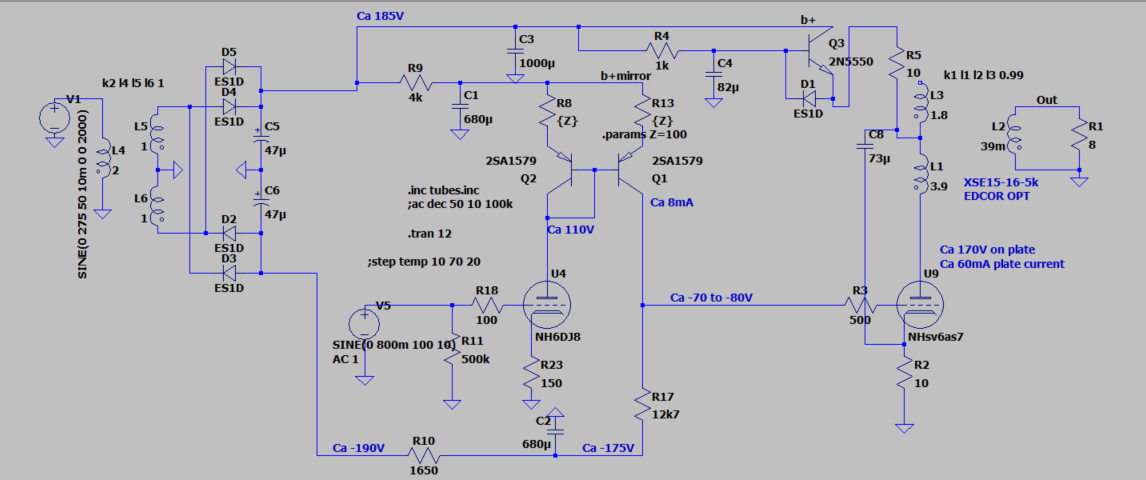

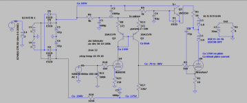

Perhaps include the schematic:
(Edit: Btw the transistor models are just picked out of LTs lib, I am too lazy to insert the actual transistors. Nothing special about them, but the LT models are not rated to the high violtages. Luckily they still work for simulations, and it gets close enough to real life measurements)
*Except the LTspice FFT is NOT accurate. As many people mention in tons of threads, LTspice is great, but the FFTs are WRONG. They do perhaps give a relative indications between two different circuit tweeks, but not as they will really be in real life.
