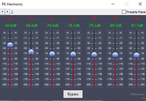

I built an Elekit TU-8600S 300B last Christmas. It clearly sounds different from all my other amps. It has a kind of clarity, detail, and holographic-ness (whatever the right word is) that is very unique. I also measured the harmonic distortion profile, and was surprised by how high the distortions are but yet it sounds so nice and "clean" (in fact very clean).
Then I came across to this PKHarmonic plugin. I entered the harmonic profile from my measurement, and played some music on my cheap $60 class D Chinese desktop amp with cheap Onkyo speakers taken from my old surround sound system. I was really surprised by how similar it sounds compared to my system with 300B amp. It doesn't have the same FR, imaging...etc. but it does have the same quality of clarity, detail...etc. that I cannot quite describe. There is a bypass button that I could do A/B comparisons, and the difference was real.
I'm now pretty convinced that there is no magic in tubes. It is just the harmonic profile at play. Good sound (and "clean sound") does not need low distortions.
Exactly. I've realized that I prefer my music playback with a fair amount of 2nd order distortion, but without any limiting or bass compression. A little bit of enhanced spatialization from "room effect" modeling is nice too. It's enlightening to see exactly what effects in our reproduction chains are giving our brains the pleasure from music that we all seek. And it's great to not have to constantly replace hardware to do it.
We also have different preferences when it comes to the distortion we call music. It would be interesting to have a knob that goes both ways. Could you remove the tube sound from audio recorded in the days when vacuum tubes were dominant? Would it sound "better" to everyone?
>>We also have different preferences when it comes to the distortion we call music. It would be interesting to have a knob that goes both ways. Could you remove the tube sound from audio recorded in the days >>when vacuum tubes were dominant? Would it sound "better" to everyone?
I doubt it. I think part of the "magic of tubes" is that their euphonic distortions might sound good in themselves, but are also masking other objectionable distortions that exist at every point in the signal chain. Adding tube sauce to a modern high-fidelity recording might make it sound "better," but having it baked into a mediocre recording made with 70 year-old equipment and techniques may just be what is making it listenable at all.
Not to say that analog equipment hasn't been refined to a very high level of performance, it certainly has. But it took at least a few decades for that to happen, and to get recordings on the level of, say, Dark Side of the Moon. And you could say the same for solid state or digital, too.
