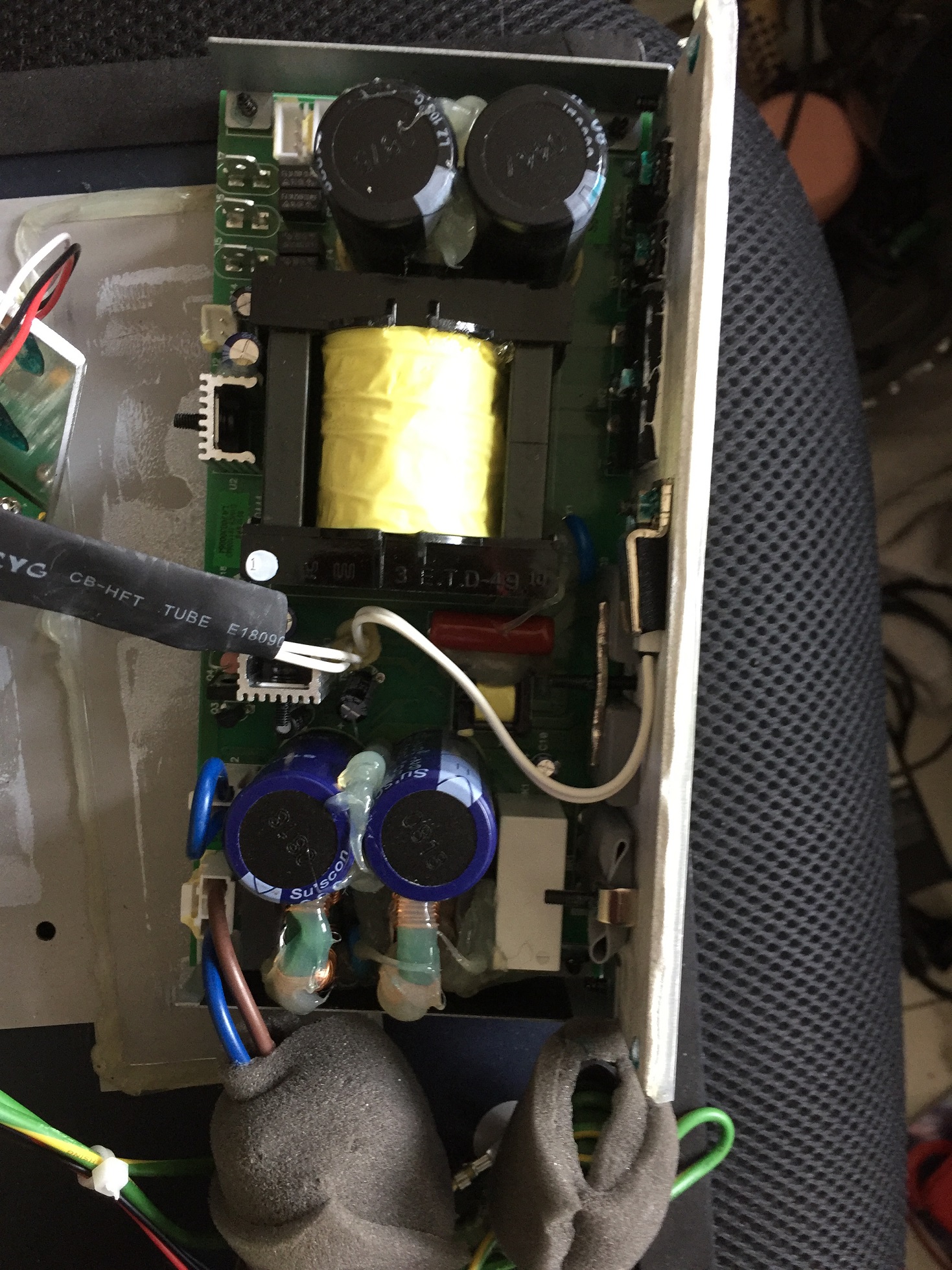

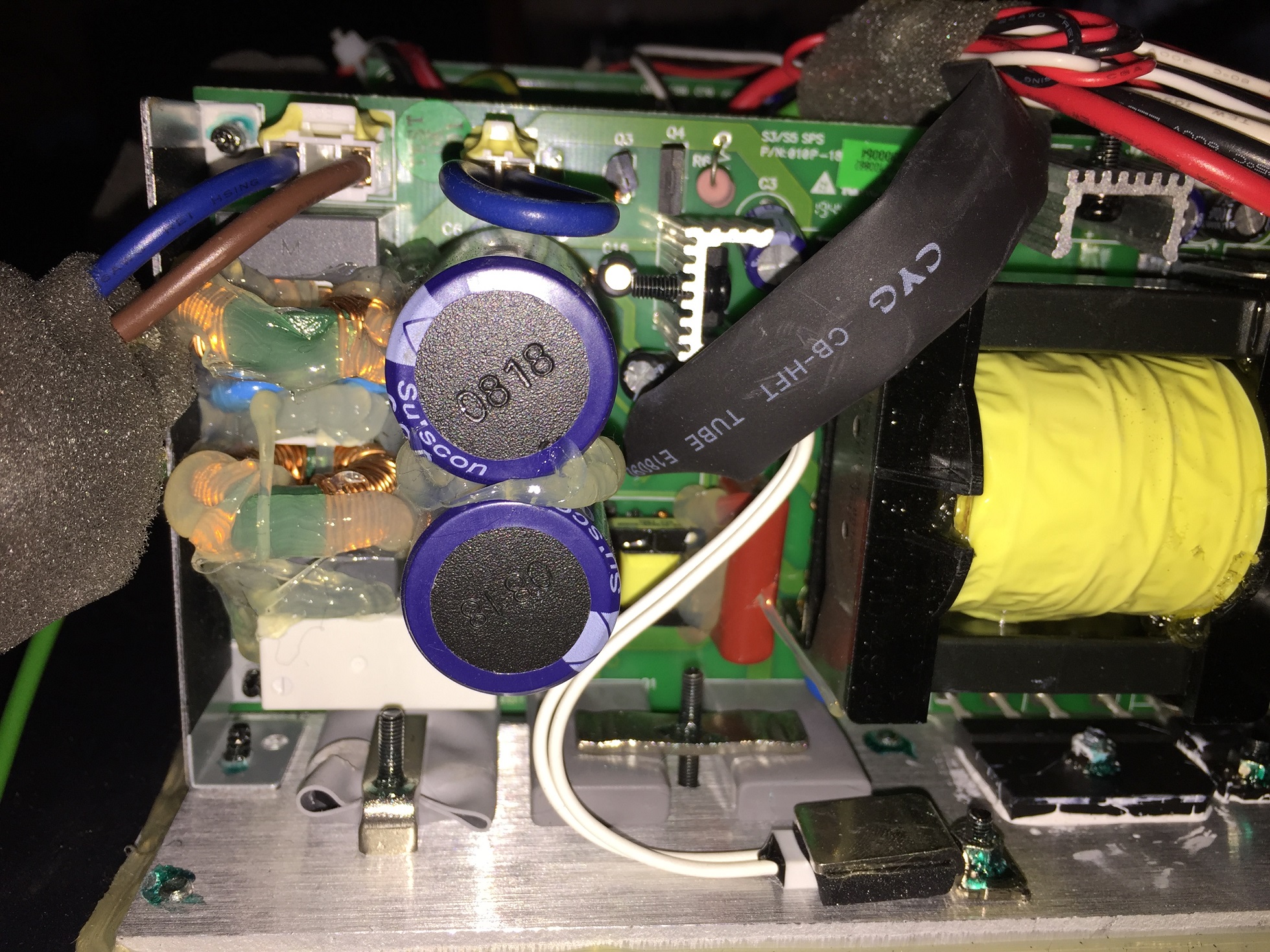

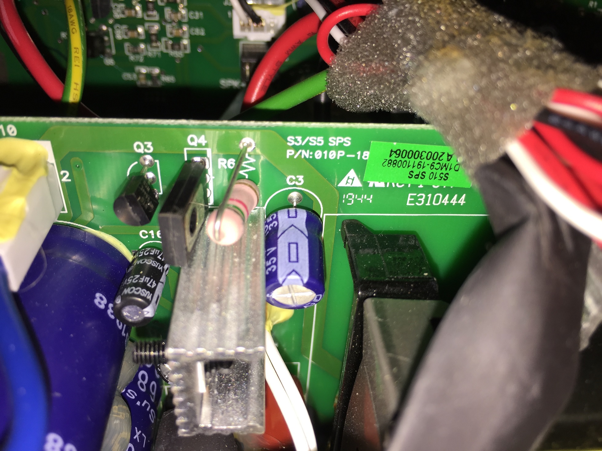

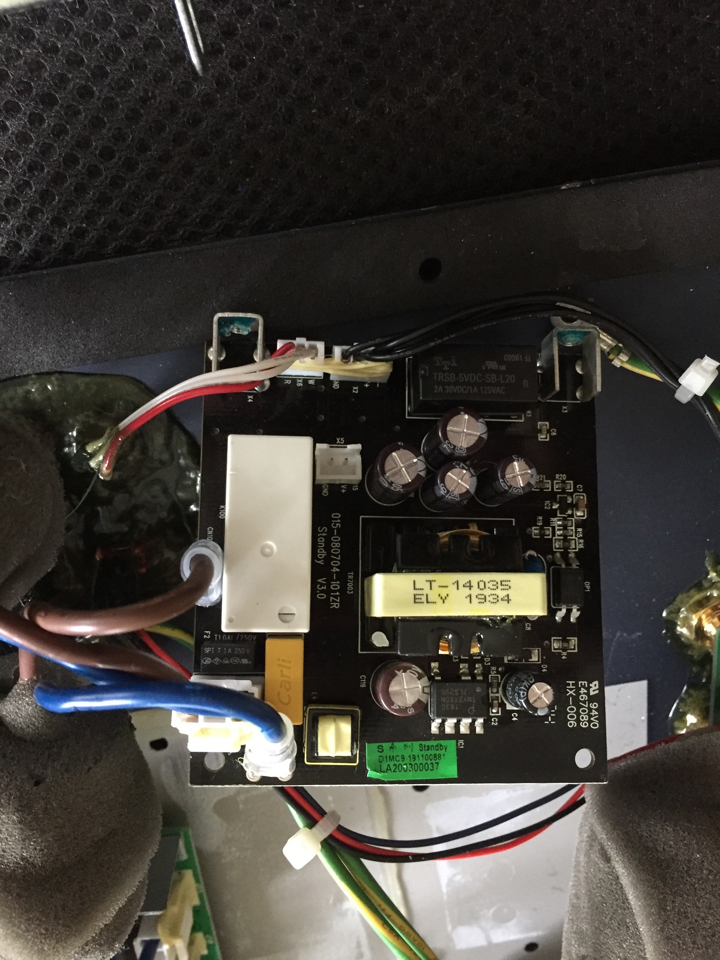

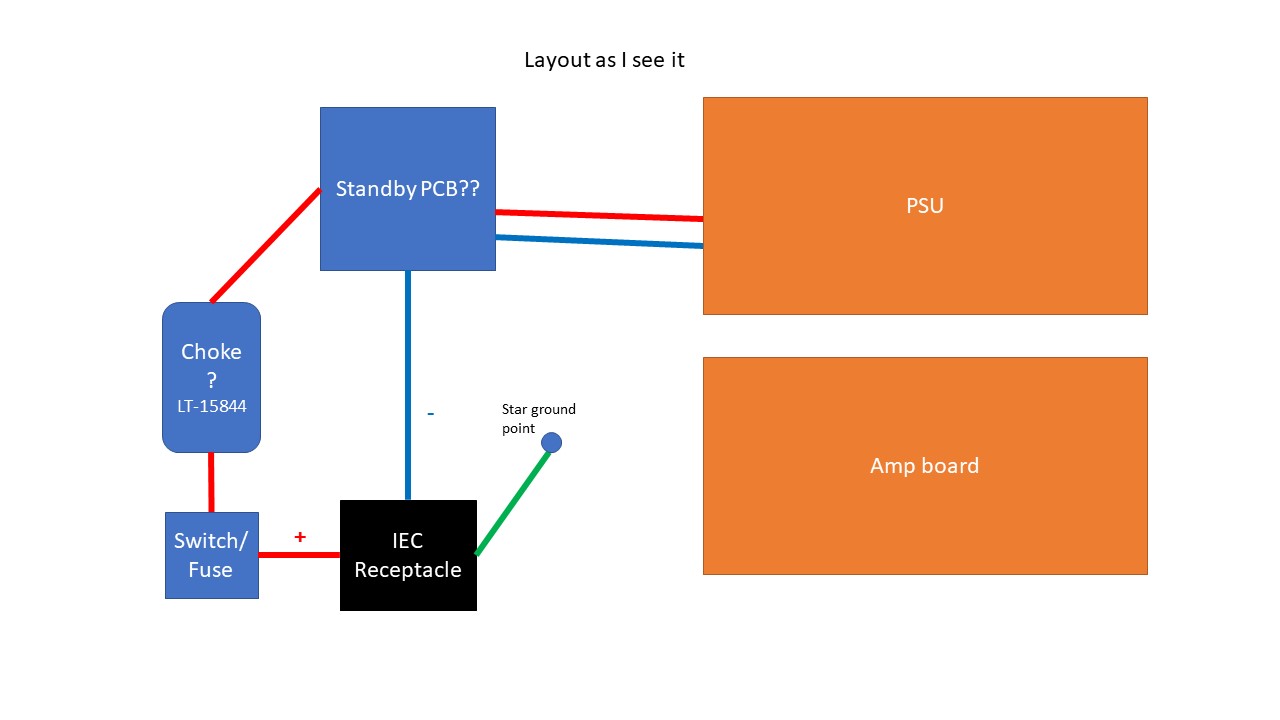

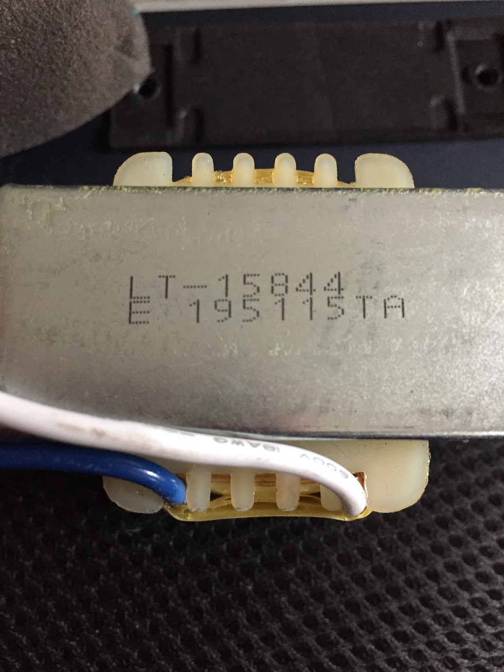

Attached are pictures of the PSU and a layout diagram as I see it.
pic 2 - connections

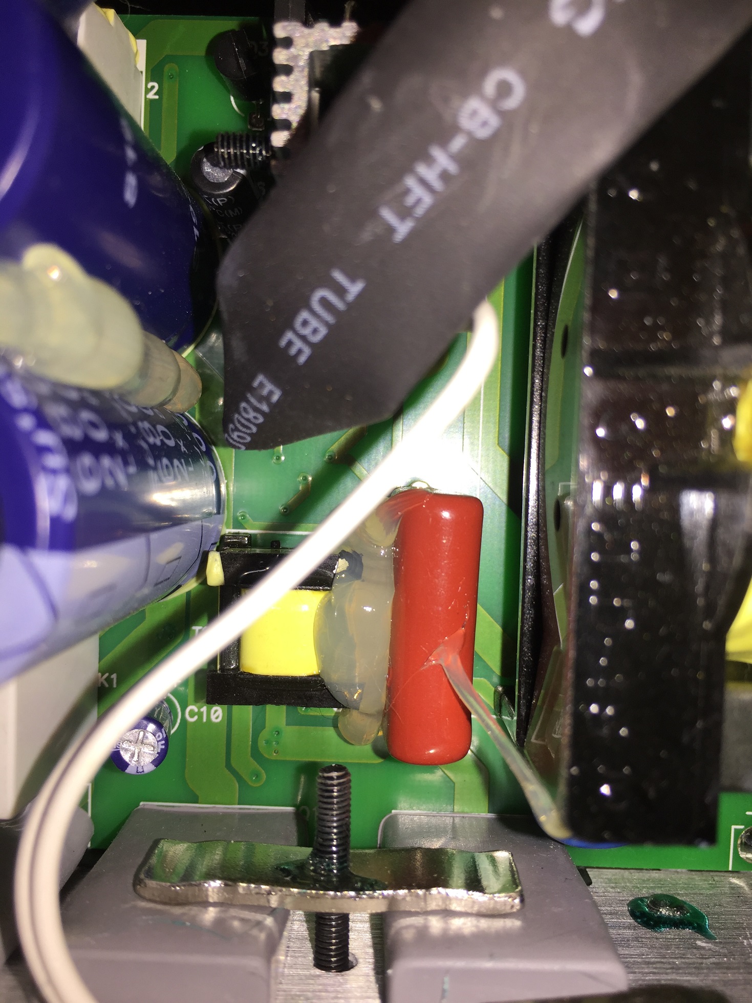

pic 3 - choke?

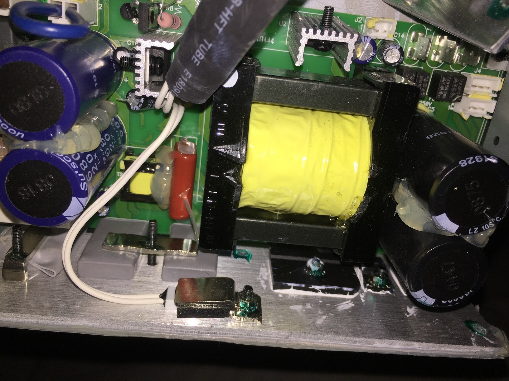

pic 4 - Standby module?

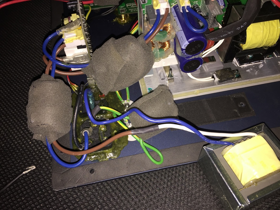

pic 5 - PSU

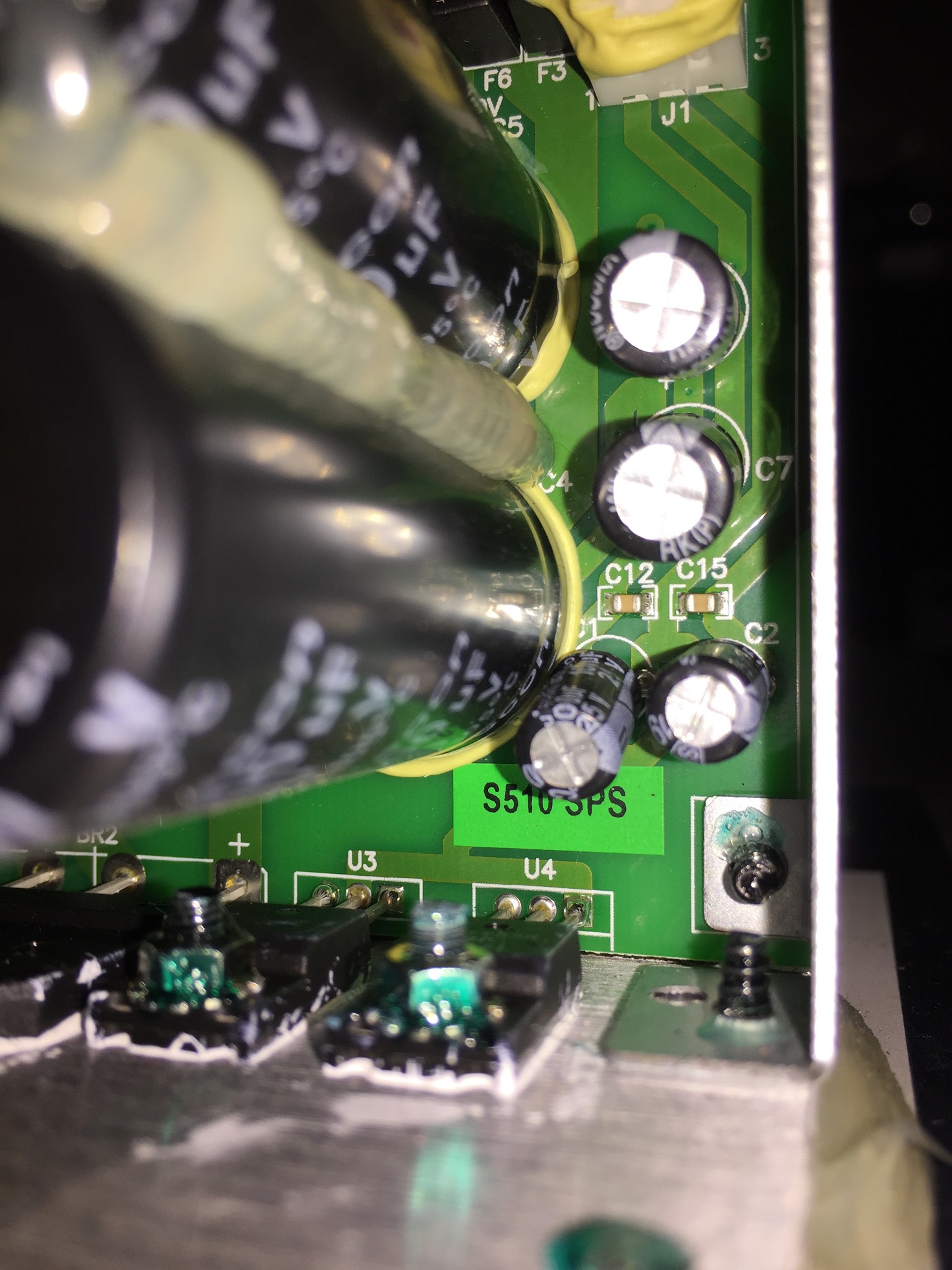

pic 6 - bottom of PSU relative to Pic 5
pic 7 - mid area of PSU
pic 8 - mid right
pic 9 - mid left
pic 10 - top of PSU
Let me know if any more details are required.

A. It has 2 caps what somewhat points to the jumper system. In cheap stuff "they" try to use a little parts as possible unless it is absolutely necessary.
B. The jumper wire (blue) seems to be fitted and with a connector in this case. It is between the mains connector and Q3.
C. If the 2 x 680 µF 200V caps are in series when the jumper is removed they become a 400V DC capacitor which seems logical for 230V AC mains voltage.
However the manufacturer chose not to indicate this with text so this is still an assumption with high probability. For 100% certainty* you'll have to follow PCB tracks and make a simple drawing and compare to the drawing in post #3. You could also measure with the jumper mounted and without the jumper to check if there is continuity with either the L or N pins on the PCB. If things are as expected removing the jumper will make it a 230..240V PSU. Most elegant, stuff used as designed and no extra complexity required.
*Now despite not being the "just doing something" type in this case I would take a look to convince myself that it is like usual (logic: why would there be a jumper near the filter caps?) and then put it back together again and plug it in. When I was wrong I'd have a laugh and think to do it wiser next time. The gains would be that I'd have something to tell on an audio forum 😀

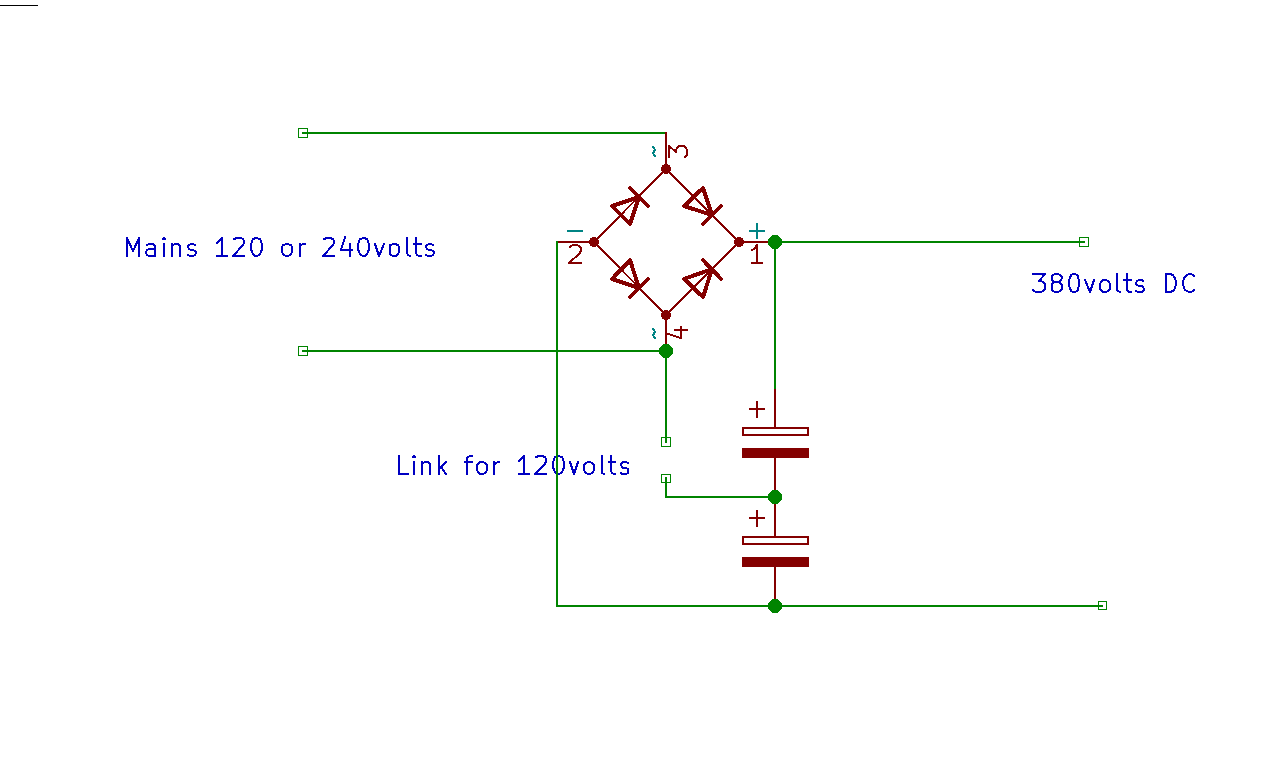

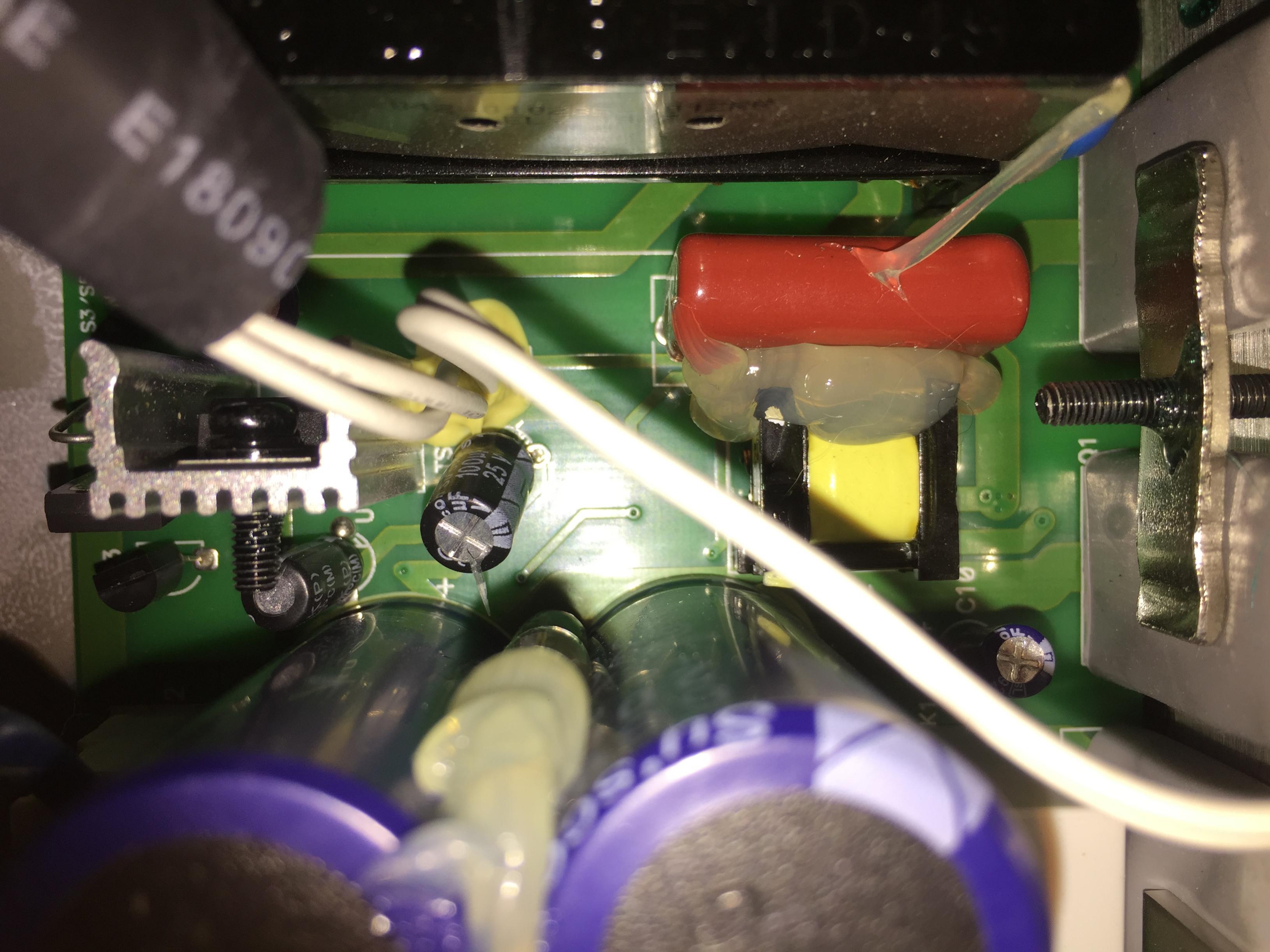

1) JonSnell is right, as usual.
I see your pictures BUT seeing components from the top is incomplete data, since no labels are visible, so YOU label them for us.
I can *guess* but that´s not safe, specially here.
I GUESS those "818" blue caps are the high voltage ones but please confirm rating.
EDIT: maybe the actual bridge rectifier is the barely visible rectangle bottom left, submerged in a sea of silicone sealer.
Not too likely but hey! , I don´tbhave bthat PCB before me.
EDIT 2: in case it´s not clear: there is a high possibility that removing that blue wire you switch mains voltage, if so I´ll suggest the safe way to test it.
I GUESS that "M" black rectangle s the high voltage/mains bridge but please confirm rating/labels ; in both cases even better if you post sideways pics showing labelling.
IF they are what I´m guessing, then Jon Snell´s circuit example applies:
and then determining what do you have there becomes simpler.
Theory:
* Main switcher works from rectified 380V DC taken from top cap positive to bottom cap negative, always.
* With 240VAC mains, bridge works like a normal bridge rectifier (so NO link) , you straight get 380VDC end to end.
* with 120VAC mains, you add the LINK, which shorts one mains wire and also one "~" (AC) labelled diode leg to series caps center connection (from lower positive to upper negative), 2 bottom diodes at the bridge become reverse biased and so "disconnected" for all practical means, and 2 top ones now become a voltage doubler, top right charges top cap to +190VDC , top left charges bottom cap to -190VDC, beauty is you STILL have 380VDC end to end, main switcher is happy.
back to practice: I GUESS the blue wire is the LINK, as mentioned by jean paul, but we need confirmation.
Plan A: draw the schematic since you have the actual PCB
Plan B: (simpler): just identify the "~" labelled pins at the mains bridge (IF "M" is the mains bridge) and fllow tracks: one track must go towards the caps center point , and passing through the blue jumper: YES/NO , confirm one.
So homework is:
* identify/label/show supposed bridge and caps labels
* follow tracks leaving bridge "~" and find if one goes to caps center point through the supposed jumper.
* post results.

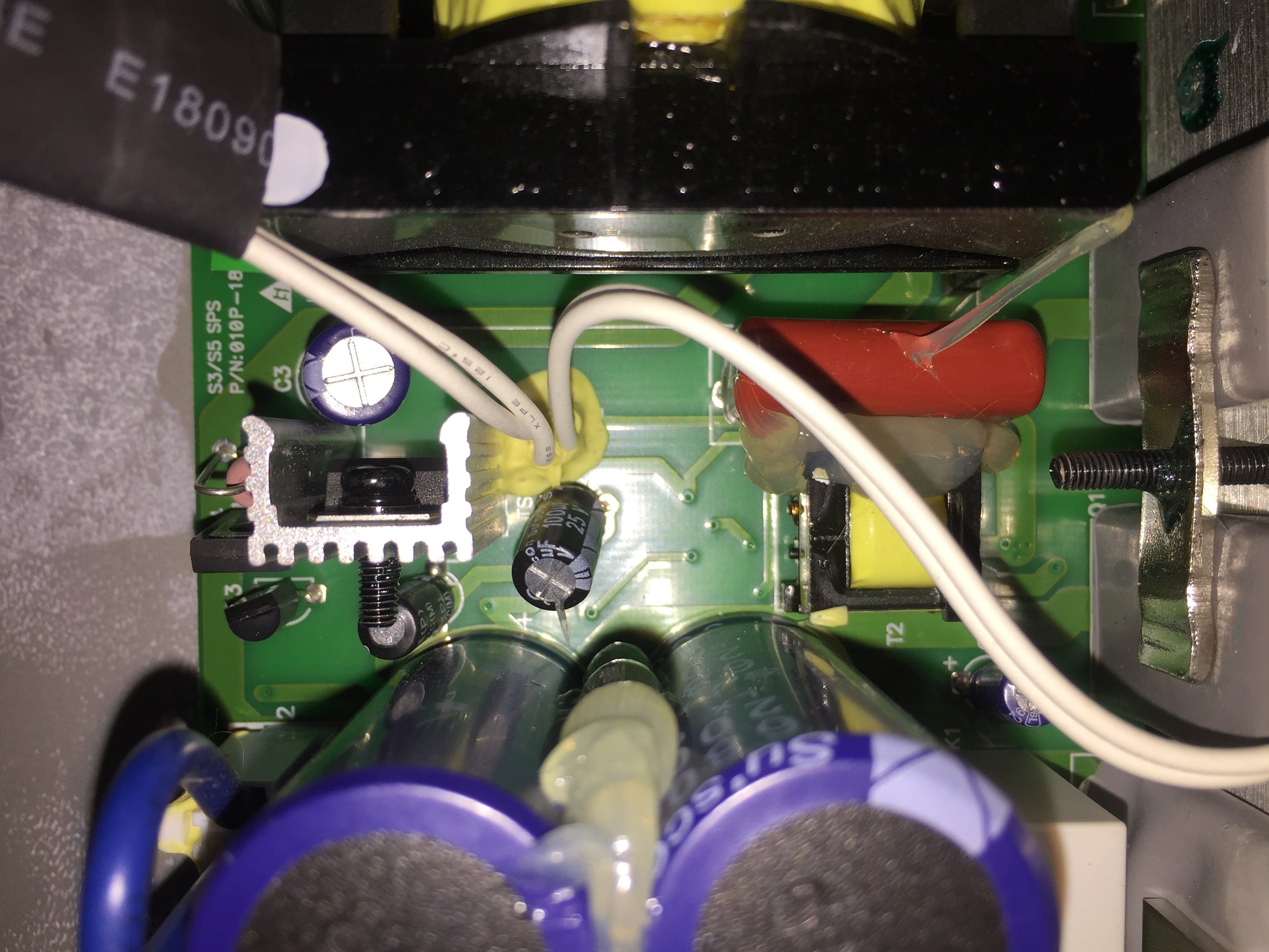

Blue caps 0818 are 680uf 200v black caps 3300uf 80v pic attached.
also some I had not included before.
Ok, one task completed, mor still pending.
Dark green over dark green has zero contrast, it´s very hard to follow tracks from your pictures, you will have to check thatb for use.
We still need you showing us the "M" rectangle on that picture, as well as thenother mystery rectangle and confirm tracks continuity with a meter setb to low ohms, "beep" continuitybtest is not enough because it has no units.
Short meter probes together and tell us what is the residual/remaining ohm number shown (it will not be zero)
Use lowest ohm scale, usually 200 ohm.
