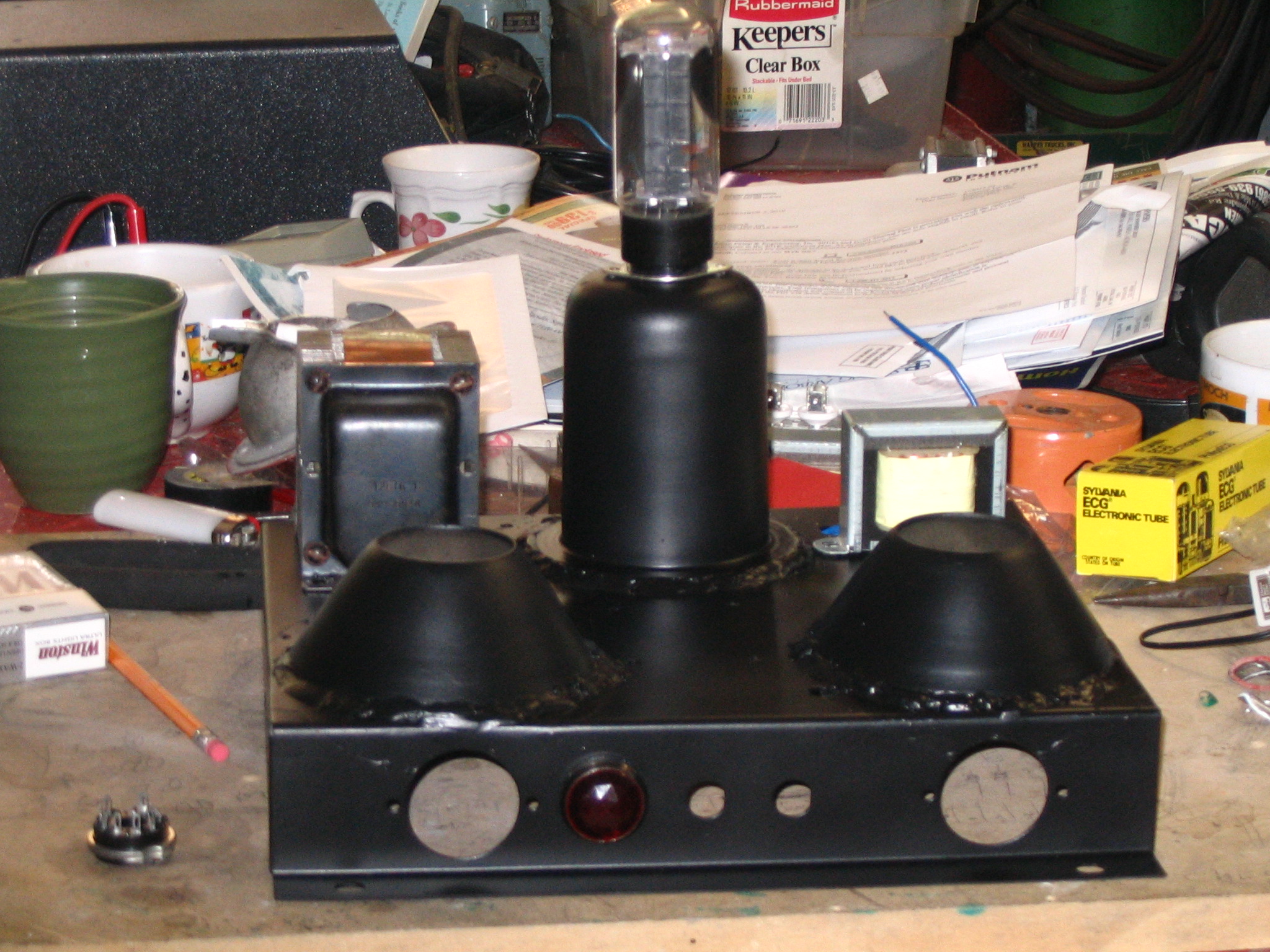

Hi All, I am building a RatRod amp with the 6LR8 compactron tube. As you can see by the pix it will be flat black and I will pin stripe it with white and red....just like a RatRod. Anyway, the two outboard holes on the front are for Oil Pressure and Oil Tempature gauges. How can I make those two gauges work as VU meters?????

At first I was going to do that but then realized that this is a RatRod amp and it should have car gauges.
Most car gauges I am familiar with have hot wire mechanisms which probably have too long a time constant to work well for this application. (I could be wrong)
I think taking some meters and modifying them to look like car gauges would work a lot better.
I'd look at Stewart Warner's automotive electric gauges and see if they have anything that might work..
You could purchase or borrow the Oil Temperature and Turbine Inlet Temperature gauges and scan the faces of the gauges. Glue the scanned images to a couple of VU meter movements.
As for connecting the VU meters, all you'll need is a bridge rectifier (using Schottky or Germanium diodes) fed from the secondary side of your output transformers and a 1k pot so that you can adjust the sensitivity of the meters.
Please share a photo after you have completed the project. It looks good so far.
Nope, no stripes yet. I just now finished all the drilling and whacking and now taking it to Ron's for pin striping.
Thanks all for your suggestions. I really don't care for VU meters, I just thought that since I was messing with it, I could turn the car stuff into VUs. When I get the meters, I see what I can do but it sounds like it might not work as I'd hoped.
