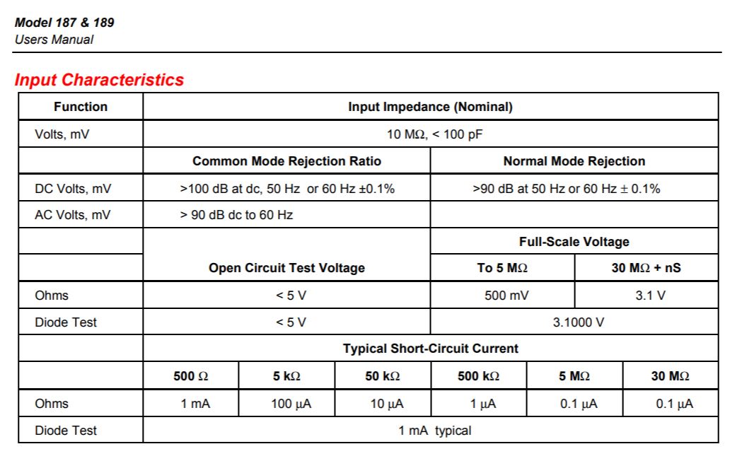

Input Z is far lower on 200mV AC range (or is it DC ranges?), than the 2V or 20V range, for example
That is incorrect. Here is the spec for one of the meters you cited. You will note that the input impedance is the same10Mohm on all mV and V ranges.
I suggest you SHOULD bother looking up this info before you post incorrect statements.

10 MegOhm AC input impedance... across ALL frequencies in its capability of measurement?
Hmm. Ok...
Precisely...at 50 or 60Hz only.

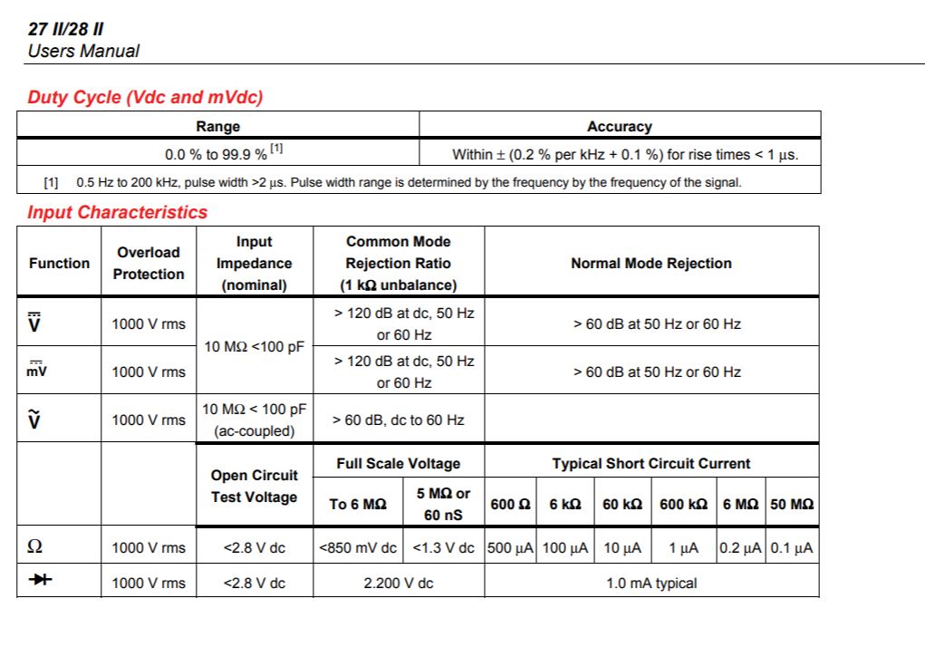

Most interesting, is that you chose the obsolete 187 data sheet to quote, and not the 28II, which has frequency response and everything.
Nope. I chose at random, but here is the 28II, same 10 Mohm input impedance on all mV and V ranges, ac and dc.

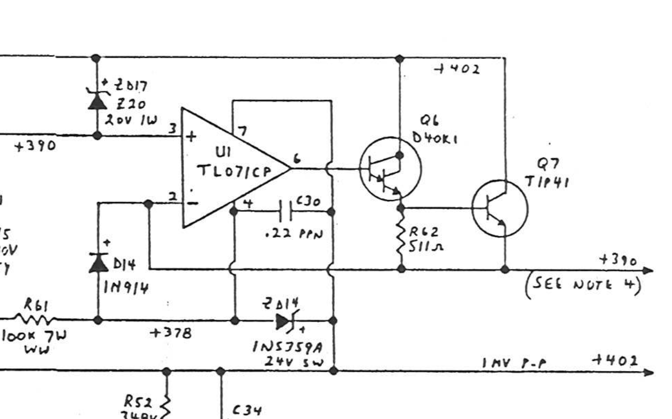

Sorry for the digression. My point is that I agree with astouffer. The input Z of the DMM is not causing loading. And even if it was, a steady state additional load would not cause the voltage to fluctuate.
I was suggesting that poking around with DMM leads can cause momentary disturbances to a high Z circuit. Stray EM coupling, ESD and whatnot. And it's hard to predict how a digital display would react to those transients. This is why I suggest connecting a scope probe solidly and posting the trace so we can see what the fluctuation looks like. And preferably with the input shorted.
Oh, and read note 4. on that schematic.
