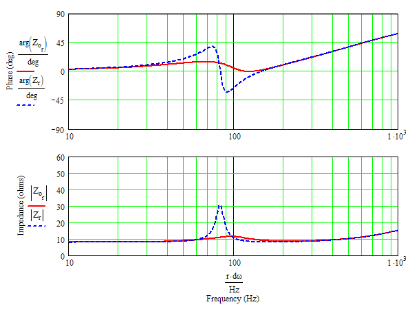

As you can see in post#15, the SAFE enclosure also provides similar effects. This version of SAFE did not have a back chamber, and the driver was not sealed tight to the enclosure. I was just curous what the impedance curve would look like. No serious attempt to optimize it. Probably I will spend some more time on it in the future.

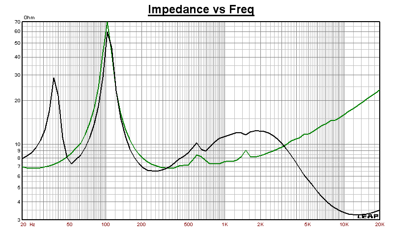

Just FYI...here is impedance for a BMS 18N850 in a 15" U-baffle with and without two layers of 6mm wool felt stretched across the back of the U. (The wiggle at 5k on one trace is just a measurement glitch.)
Paul
Paul

post#15
“an impedance comparison of the JX92S in free air versus in a Symmetric Air Friction Enclosure (SAFE)”
Which is which?
post#15
Which is which?

Great to have measurements. I want to try something similar in a sealed design I'm working on too.Paul W said:Just FYI...here is impedance for a BMS 18N850 in a 15" U-baffle with and without two layers of 6mm wool felt stretched across the back of the U. (The wiggle at 5k on one trace is just a measurement glitch.)
Paul

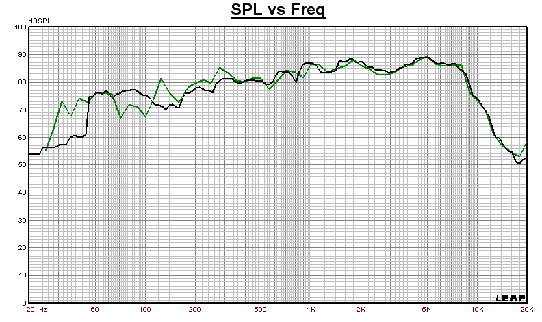

salas
Any thoughts as to why the reflex measures less lumpy (but still lumpy) than the resistive?
60-110 Hz bass hole aside, the resistive goes deeper: mustn't be the same as Small's resistive-vents (which had less low bass than a closed box) . .
Do you have a qualitative preference?
The difference in lump & hole areas is due to the interaction of the 2 different bass transfers with room modes. The resistive goes deeper bcs it compliments the particular room gain closer and easier. I prefer resistive for bass information quality and especially for better mids. The SPL loss in the hole area is significant though for a stand alone little system. The shown example blends to a bass module in actual use so the resistive option was a win win choice.
