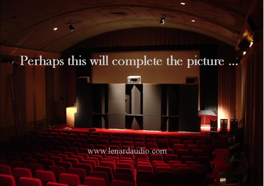

Punk will newer have an ugly A7 or anything small for that matter
How about those 105db 12" in A7
There goes Crazy Cal again with his A7s. 🙂
I'm all for the A7s - if only we could find a mid range solution in budget. Anyone got one?
