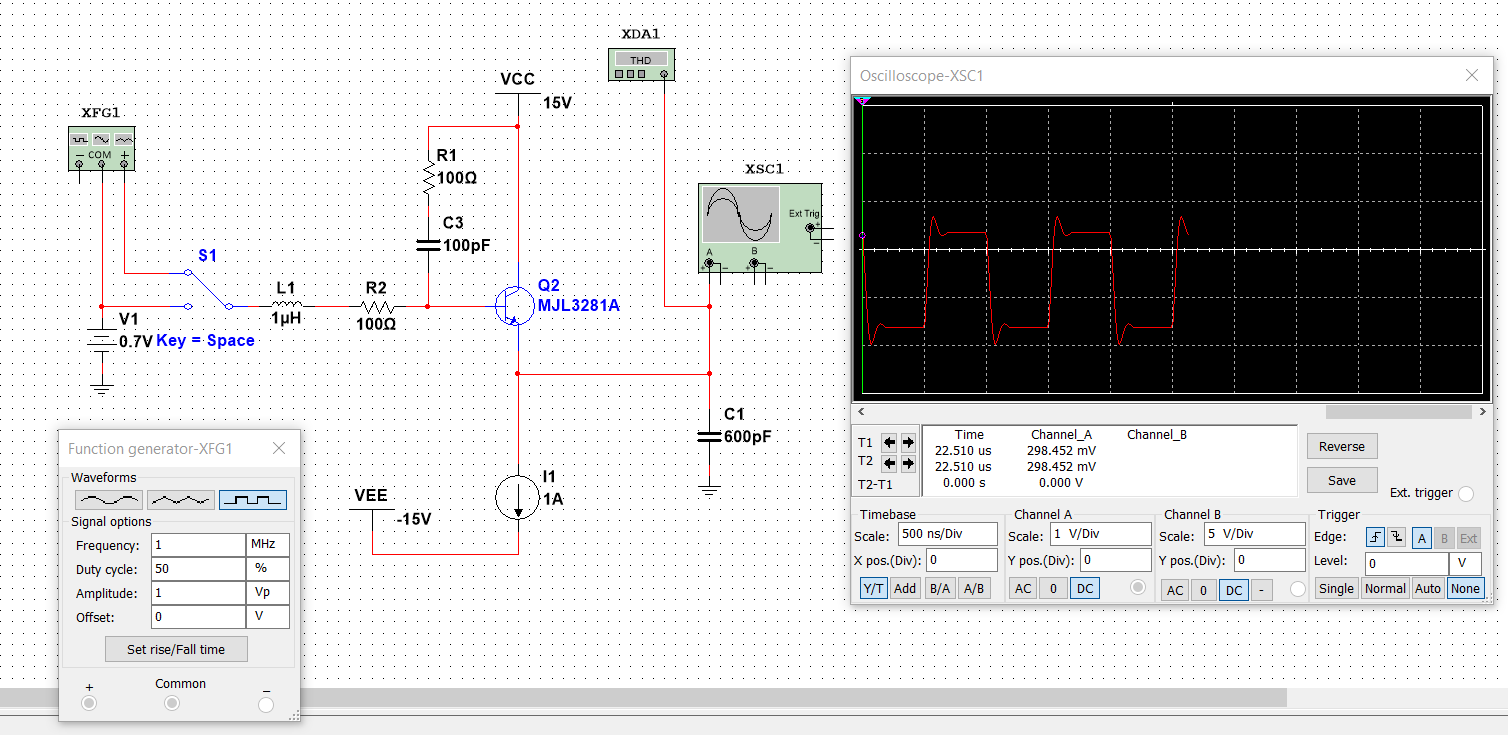

I might have found an optimal solution.
Zobel network has a very good property. If the network is balanced, the input impedance stay constant and it is resistive only.
Wiki explains it better than me. https://en.wikipedia.org/wiki/Zobel_network
If we face the constant-impedance node of the Zobel network towards the input of the emitter follower, the input only see a resistive signal source. There will be no oscillation. The tricky part is the components need to be selected in a way that they can overcome any internal capacitance from the transistor (ideally).
The condition to balance the zobel network in the circuit below: R1*R2*C3 = L1, also R1=R2

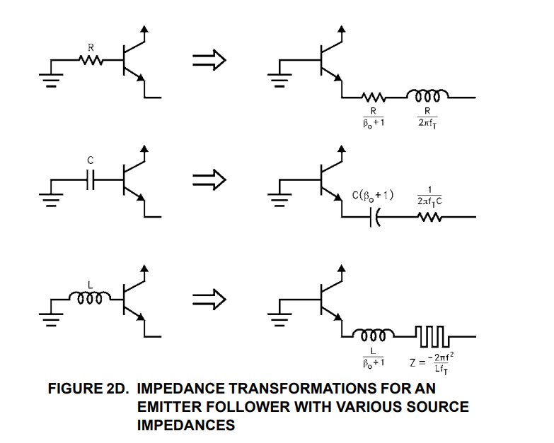

The output of the emitter follower could also be inductive. You don't need a long trace/wire to get inductance. A previous EF stage would act like an inductor.
This is mentioned in the 1st paper in the post #15.
For example, let's say the ft is 30MHz, a 100 Ohm base resistor would be translated into a 0.53uH inductor. It is not far from the so-called worst case, 1uH.

Don’t you have to consider the boundary conditions Marcel mentioned? I’m just thinking that beta will have dropped off significantly at fT. Just a question - I’d have to play around with the equations a bit after first reading the linked to papers posted by Mark.The output of the emitter follower could also be inductive. You don't need a long trace/wire to get inductance. A previous EF stage would act like an inductor.
The impedance transformation is the result of beta rolling off to unit at ft. Thus, it does consider that.Don’t you have to consider the boundary conditions Marcel mentioned? I’m just thinking that beta will have dropped off significantly at fT. Just a question - I’d have to play around with the equations a bit after first reading the linked to papers posted by Mark.
That's an interesting approach!
I haven't attempted to calculate it, but it might even be fairly robust against inductance changes:
A base stopper (series) resistor mostly helps at high frequencies/for small inductances, because the negative resistance gets less negative at high frequencies.
A shunt resistor mostly helps at low frequencies/for high inductances, because the negative conductance gets less negative at low frequencies.
You have both, but I'm not sure about the effect of C3.
