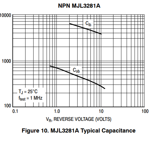

I figured that 220pf would be the max cap is allowed at this position. Thus I use 0.5uH for demonstration.
My formula is use 47 Ohm value for both the base and shunt resistor. For the cap in shunt position, use 47p per 0.1uH inductance ahead. As said in post #48, you get output inductance from the prior EF stage even the wire inductance is ignored.

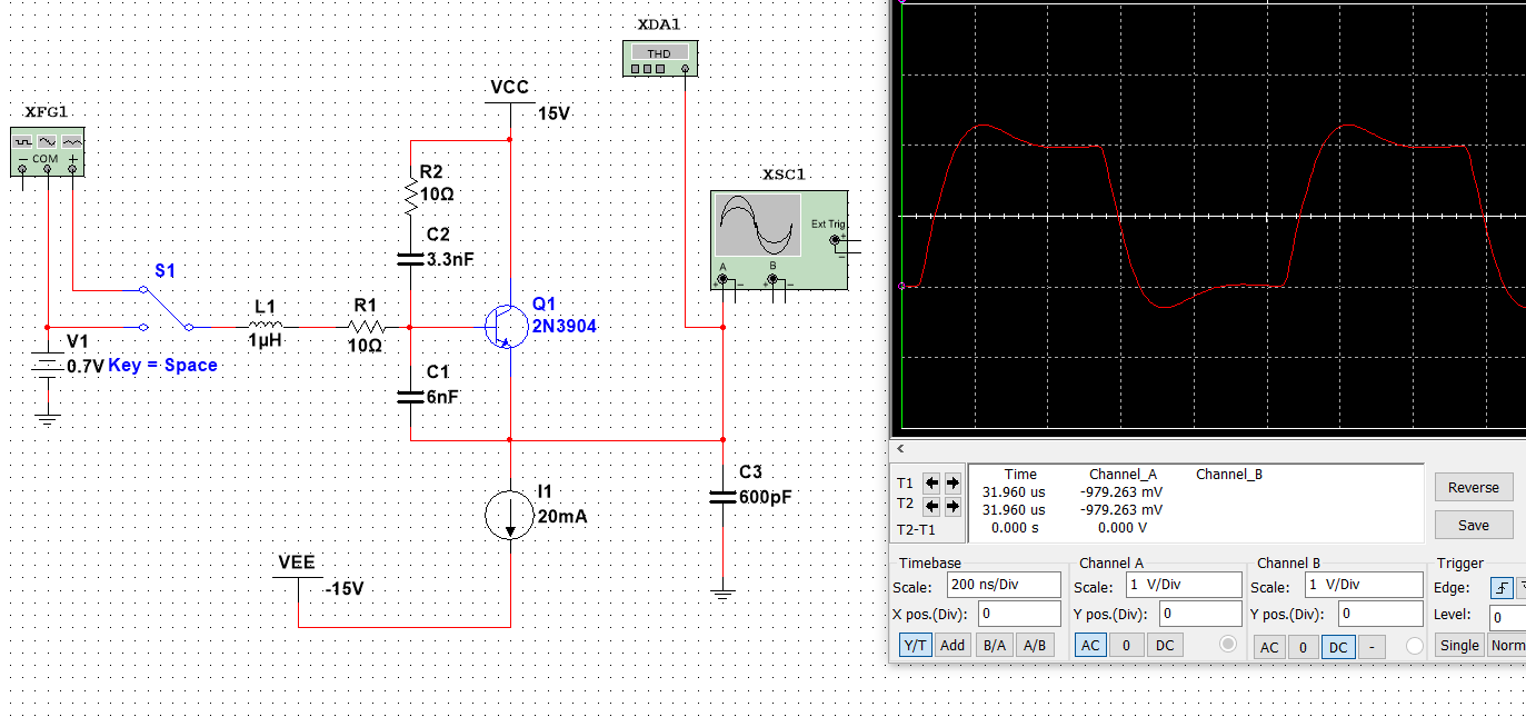

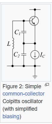

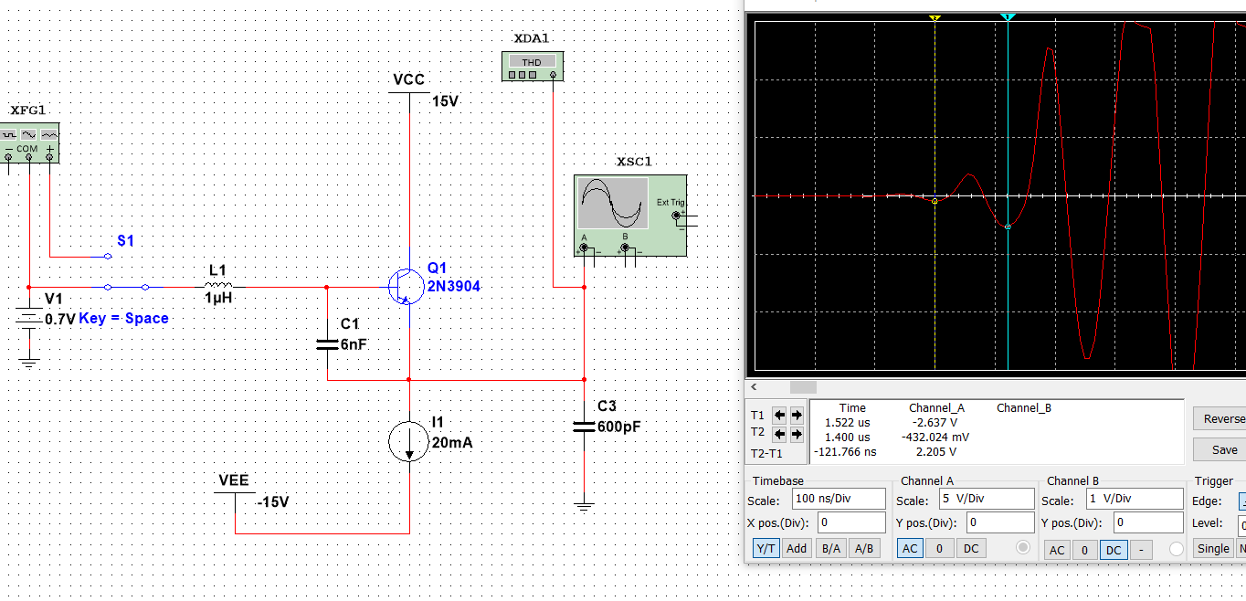

Finally, CFP or Sziklai pair.
You can see even a small inductor can cause instability with CFP. In the simulation above, there is no load attached to the output yet!
Just as predicted in the post #10. The negative impedance at the input is proportional to the gm. As the CFP has very large gm, this thing is unstable.
Here are the fixes.
Below C3 47pf is good enough to counteract anything below 0.1uH from the input.
Option 1.
Option 2.
PS: Using CFP as the output stage, adding an output inductor is highly recommended. You want to avoid any possible capacitive load attached to the output directly.
Here are the fixes.
Option 1.
Option 2.
