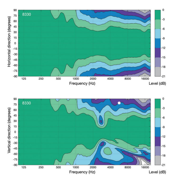

"How much" - that depends on you. If you model your situation as I am learning to do, you can gain insight.
While modelling my TMW my spacing is around 370mm my cross over from M to T in the example is around 500hz....it gave me a cancellation around xover, slightly above 0 axis maybe 20-25 + degrees before it really kicked in...and then below 0 axis, the crossover being so low CTC no longer an issue so no noticeable lobing until far off like 60 (-)degrees.....
The above axis cancellation is probably common in a lot of designs with a horn/waveguide...I think when CTC starts getting pushed too far, you start to have a second cancellation creep up from below, and it resembles the narrow vertical polar seen with some MTM designs....the directivity of the horn doesn't help, I don't think...I say I don't think because, I am still learning but, the directivity of the horn, to me, resembles the beaming of a woofer being used higher than its diameter to wavelength relationship. A horn looses directivity past the width or length dimension so the polar can be seen as strongly influenced by source size and redundant source separation....
AS you can see above in the charts, its not an uncommon thing for a major manufacturer to have this issue on the vertical axis...

In an ideal world the spacing should be less than a 1/4 wavelength a the XO frequency. In your case you also have to consider the depth of the horn. It is very unlikely you can get that close, so as close as possible reduces the issues.
dave
Thanks for posting, Dave. I didn't realize the recommendation is 1/4 wavelength.
I can't remember where I (mis)read the 1-wavelength recommendation. Forgive me, since I'm not very technical, but I was thinking about the typical 1" dome tweeter and 6.5" woofer 2-way bookshelf speakers. Most of these design crossover at 2.0Kz - 2.5Kz. The 1/4 wavelength at 2.25Khz is approximately 38mm, or 1.5" ---which would mean its impossible to create 1" tweeter + 6.5" woofer design that does not exhibit lobing.
Maybe the simple explanation is that 1/4 wavelength or less is ideal (as you stated above), and up to 1 wavelength is acceptable, but anything greater than that would result in sever lobing. .

1/4 wavelength separation ensures that even at 90˚ off axis (the worst case example), the two drivers will still sum to an amplitude at -3dB relative to the on-axis response, which is still acceptable.Indeed you see 1 or 1/2 wavelenght touted, but Danley showed that 1/4 wavelength was needed to eliminate all positional issues.
1 wavelegth is fine when you have little hope of getting any closer.
dave
By the time you get to 1/2 wavelength driver separation, there would be a null created 90˚ off axis (assuming both drivers have the same off-axis response), with varying degrees of attenuation between 0˚ and 90˚ from the axis. This isn't likely to be a serious or even noticeable issue for most situations but it is advisable to avoid such design flaws if possible.
Using a 1 wavelength separation or more is asking for trouble as the nulls and attenuation quickly become an issue within 45˚ of the axis. This can degrade the direct sound quality as well as the reflected sound. See diagram for a visualization of nulls and amplitude variation:
It's kind of artificially created problem and largely dependent of a room acoustics. CTC is important because of vertical directivity, but going as far as demanding 1/4 wavelength is pointless. When you look at the fact that you listen to the music in the spot that is vertically spread within +/-0,5m (even this is more than a real life situations) at the 3m distance then you get a window of +/- 10deg, and this is roughly how big vertical derectivity you need.
Seems to me that this effect really only helps if you are at a position where sound is coming from only one of the two sources, instead of both.If your target vertical directivity is narrowed acoustically by your decision to use the waveguide, then your lobing target will also be relaxed meaning you can go a little further apart.
It is easier to talk about what happens, not as easy to describe what it might sound like. jamesblonde is right in saying that 1/4wl produces a lobe, with a beamwidth of 180degrees. This therefore affects power.
It should be taken case by case because it is based on a compromise to begin with. To put it in simpler terms, say you have a 1/2wl separation which produces a null at 90degrees off axis, but neither of the drivers is directing sound to 90degrees near the cross.Seems to me that this effect really only helps if you are at a position where sound is coming from only one of the two sources, instead of both.
