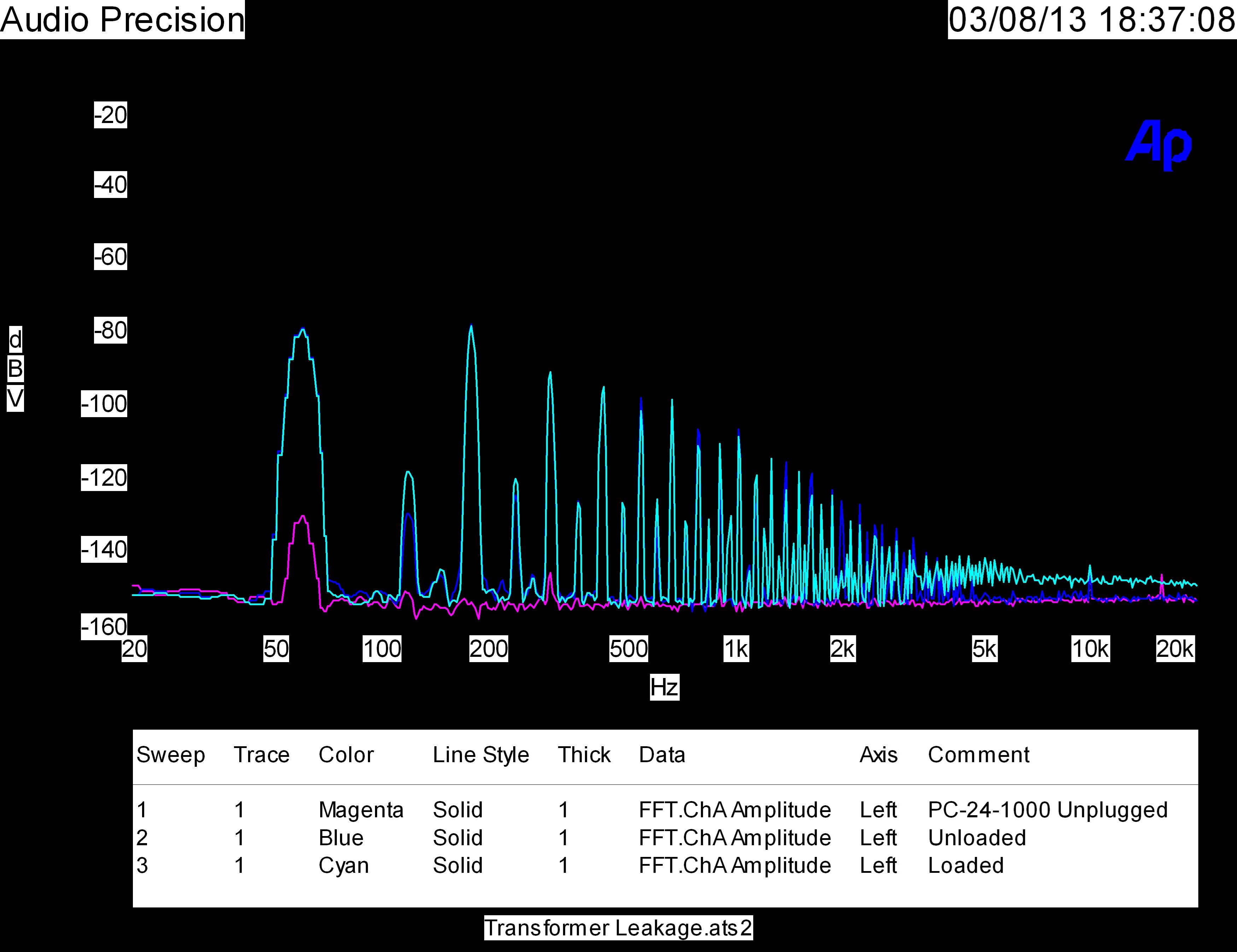

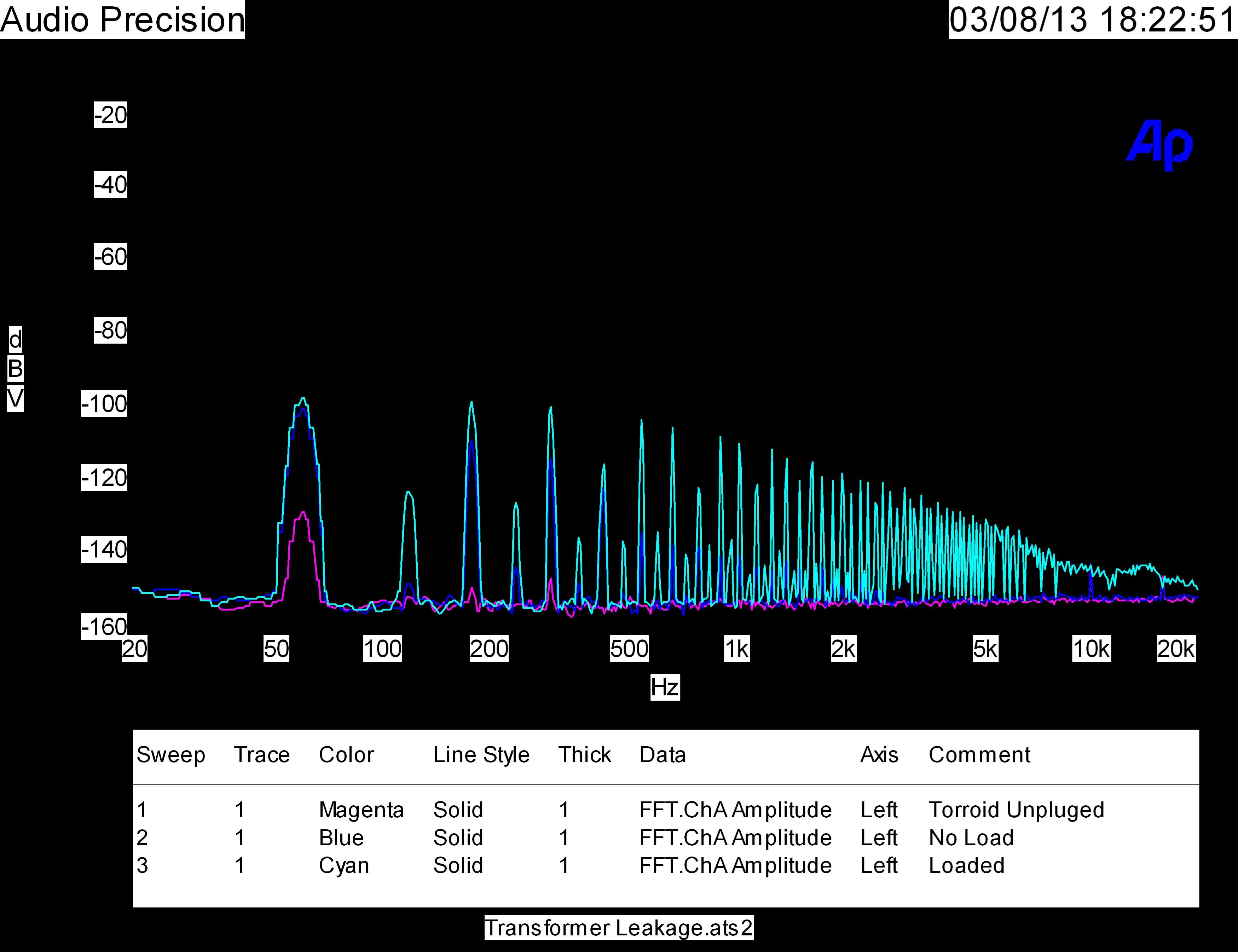

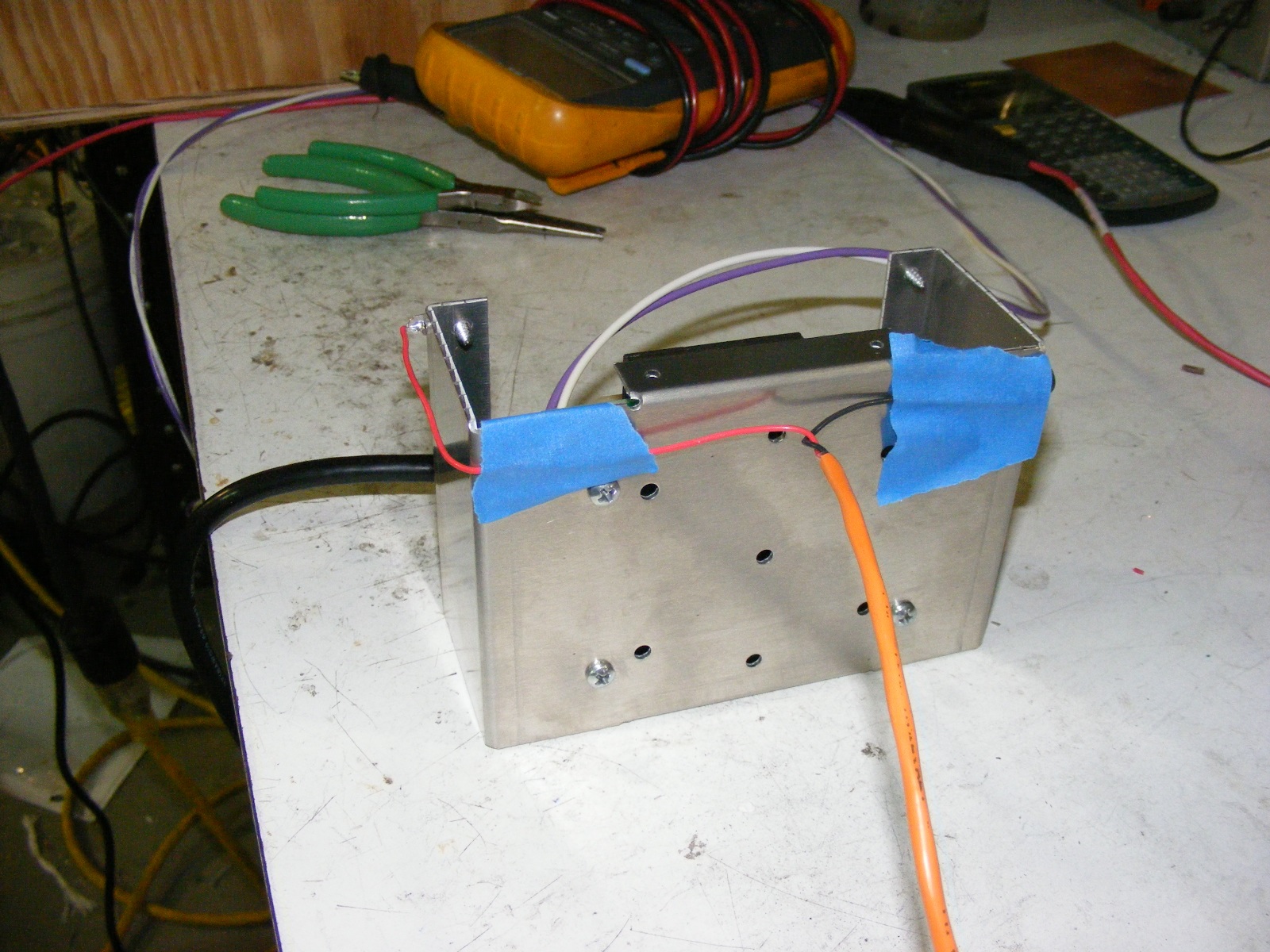

Attached is the flux leakage test set up to measure the voltage induced into the chassis, the leakage from a normal E-I transformer and the leakage from a similar size toroid.
You should mount you transformer is a shield and isolate it from the chassis with nylon standoffs for lowest noise.
0 dB is 1 volt as I recall.

Could you elaborate on what the sensor is, and where it is for the tests. Did you do any other tests to characterise the results, especially for the EI PT.
As shown in the picture I mounted many different transformers to the same size chassis and measured the voltage induced along the length. From the data a torroid is 20 dB quieter than an EI.
Enclosing the transformer in its own box and mounting the box on insulated standoffs makes the induced voltage below simple measuring capability.
OK, thanks for clarifying. The sensor is likely to be the loop formed by the area between the wiring and the chassis, but also could be an earth loop formed by capacitance between the transformer windings and the measuring instrument.
Is the measuring instrument powered from the mains?
If you twist the sense wiring and only make one connection to chassis then what do you measure?
If you disconnect the sensing wires from the chassis, but form a loop with area in the loop then what do you measure?

The device under test is powered from an isolated clean sinusoidal power source. The cable is taped to the chassis to minimize and standardize the test. The cable is twisted shield pair typical West Penn Wire 291.
Please note the baseline curve with the transformer unplugged.
I did these tests years ago.
