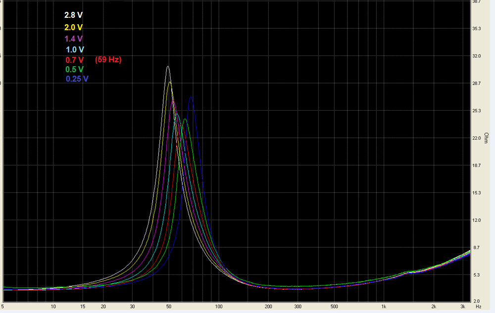

Here is an example from a very well known (and respected) manufacturer, cherry picking the Fs, as well as the Bl and Cms.
fyi, for those who don't know, the standard T/S according AES is normally done by 0.1V

Wow - so basically resonance freq looks to be inversely related voltage - is that generalised across cone based transducers - or specific to this driver?
How on earth do designers factor this into enclosure and multi-driver design - I guess it means a speaker has to be optimized for a single volume level - and will be suboptimal at louder or quieter volumes.
Thats a big movement though - c 40% change in Fs for a 20dB voltage change - which for a 64dB volume dial is only c 15% either side of middle - that sounds too much - am I misinterpreting this?
Reactions: Juhazi

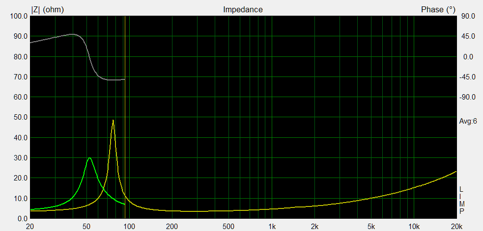

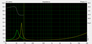

There is nothing wow about this part.
What you're seeing is just the effect of the compliance vs cone excursion.
Exactly what can be seen with those Klippel measurements.
So yes, this in how generally ALL speakers work!
Just one random example;
https://audioxpress.com/article/test-bench-bold-north-audio-ms-10w-a-legendary-6-5-woofer-from-misco
scroll down, see the Kms(x) graph.
Kms is the stiffness, so 1/Cms (the inverse of the compliance)
You see that the stiffness (compliance) isn't lineair.
The same goes for the BL, the Force Factor graph vs excursion.
Since the mass of the driver doesn't change, the Fs is proportional to the difference in compliance.
At the same time, the height of the peak of the impedance, is proportional to the (change in) Bl.
(the Kms is assumed to be a constant as wel)

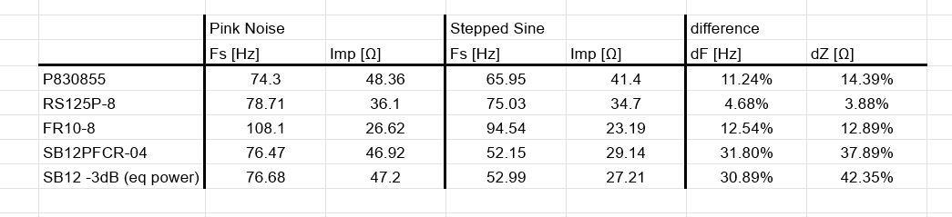

Although much smaller speakers, here the result of some measurements I did a while ago
(not related to the previous graphs btw)
In the last row we can see the difference in Fs as well as the height of the impedance peak (max peak minus Re if I recall well)
What you're seeing is ONLY the difference in voltage at the speaker terminals.
Pink noise has a much lower equivalent power compared to a sine wave, so this was used to enlarge the differences.
(the system I was measuring on was having some issues with lower voltages sine waves, but this gives a very similar idea)

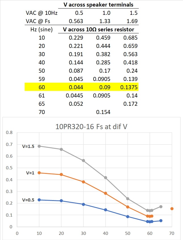

OK - so I think I've ruled out Fs variability due to signal level.
the setup: Run sine wave through amp & measure the voltage drop over a 10ohm resistor (R) between amp and negative driver terminal, positive connected directly from amp to driver.
the test: varied sine wave freq to find frequency with min V drop over R => Fs, repeat test at 3 dif input levels 0.5V, 1.0 V & 1.5V (as measured at 10Hz across speaker terminals).
results: (attached) at the level of accuracy I was able to work at Fs was within 1 Hz of 60Hz across all 3 voltages tested. This result is also consistent with the Fs obtained from REW.
conclusions:
1. my measurement of Fs @ 60Hz has now been confirmed by two different measuring setups - so the likelihood of testing setup stuffups is low
2. the measured difference between my drivers and the spec is not likely to be caused by differences in the signal level used for the spec. (pending hearing back from Faital on exactly what signal level they use to cal their specs - if it is significantly outside the range of 0.5-1.5V then I'll retest at that level to confirm)
next step - eliminate the possibility that the drivers are still stiff due to lack of excursion during the 20 of hours of brake in.
cheers Paul.
Reactions: Juhazi
The jury is in - the drivers are still breaking in - these are tough cones!
Im seeing small (as in 1 Hz) drops in Fs from physical manipulation (as per b-force advice - thanks!). It is a bit nerve racking pushing and pulling the cone to its extremes - almost feels like the cone is going to pull away - but each series of 2-3 pushes & pulls is dropping Fs by c 1Hz - I'm now down to 53Hz and still going.
It is quite remarkable how effective this is.
So the answer to original question in the thread is that a 20% deviation from spec Fs for (at least this model 10PR320-16 Faital) new driver, is effectively within spec - and just needs breaking in.
I found that even 20 odd + hours of reasonable excursion break-in did not do the business - b_force's trick of physical pushing & pulling the cone to its physical limits was required (repeatedly!).
Along the way I also discovered that:
1. this driver has an Fs which is not sensitive to signal level (at least between 0.5V & 1.5V)
2. there was no material difference in the impedance curve measured whether the drive was mounted firmly in a baffle-less bracket, hung from a hook or just rested on its back on the bench.
Thanks for all the assistance - especially b_force, weltersys and air void - it is so helpful having input from a few experienced hands (brains) - even on what appeared to be a relatively simple issue!!
Cheers Paul.
